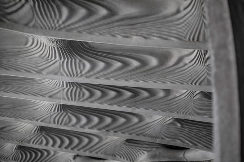

For what reason was the canopy curved? It seems to me the curve would focus sound reflections back to the pedestrians.
I found this when looking for curved concrete:
Where the sound goes depends on the curvature and the location of the sound source. Unlike flat parallel surfaces that will certainly echo, curved surfaces may or may not. It looks like the center of curvature is at or near the surface of the centerline of the deck, so only sounds at the deck surface center will be reflected back to the source. All other sound will be dispersed.
There is a monument in Washington, D.C. for Einstein that has audio-retroreflective contours; the effect is only noticeable in a very small area at the center of the arcs that make it up. From the wikipedia article "To a visitor standing at the center of the dais, Einstein appears to be making direct eye contact, and any spoken words are notably amplified."
