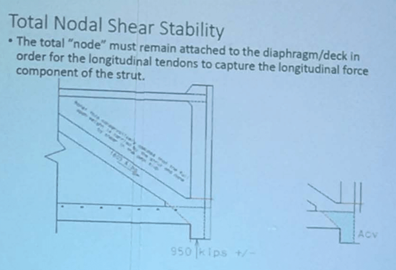

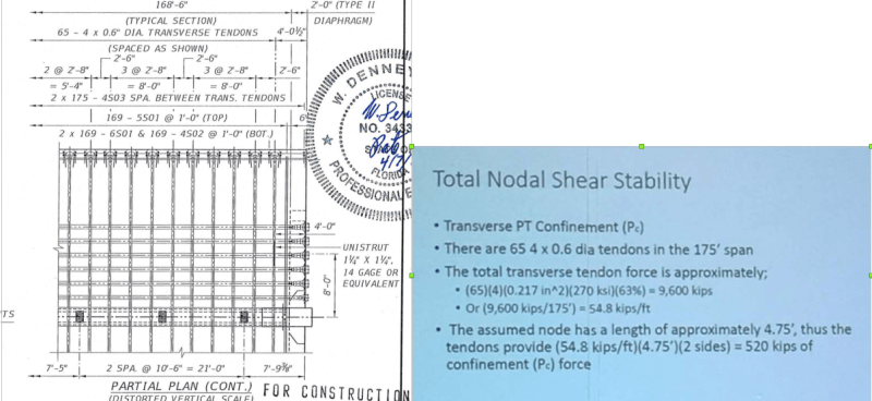

After a quick scan of the FIU information outlined by MikeW7 I found some flaws in the Mar 15, 2018 Presentation
(1) Confining force by averaging the lateral tendons not justified.
The 11/12 area did not have any transverse tendons at all and the next nearest one was 4.04’ away from the Diaphragm II or 4.915’ from the Member 12. In the presentation 11/12 was assumed 4.75’ long to have transverse confinement based on a total force from 65 tendons divided by the 175’ length.

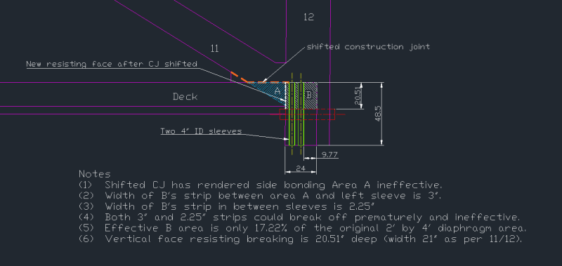

(2) Altered failure mode by the shifted construction joint (CJ) not appreciated and reductions in strength caused by the presence of the five cast-in sleeves and pipe were omitted in the presentation.
In the presentation it was assumed the rebar crossing in area the Member 12 bonding with the deck (including Diaphragm II) would participate in resisting shear. This area shown in the presentation is a triangular area (from the deck) plus a full cross section of 2’ wide by 4’ deep from Diaphragm II.
In the field the construction joint had shifted. Therefore 11/12 shear capacity based on the above assumption is no longer justified and the reason is explained in a sketch I prepared below (unit in inches).
It is obvious once the CJ had shifted the bonding area A on the two sides of 11/12 would cease to resist shear against 11/12 but stayed as integral parts of the deck. The resistance then would be transferred to the vertical face between the deck (Area A) and Member 12 (Area B).
The presentation had assumed the full cross section of Diaphragm II, on both sides of Member 12, would be available to resist shear. However by placing two vertical 4” ID sleeves on each side and one horizontal 8” ID pipe this bonding surface B was compromised leaving a mere 17.22% area effective.
The designer in the presentation did ignore the concrete contribution to resist shear and relied heavily on the rebar crossing the bonding areas he had assumed. In the field the 11/12 slid along the CJ, pulled out the vertical face between Area A and B and managed to shear out of position along the 8” horizontal pipe. This is because along the 8” pipe the concrete area is at its minmum while at the same time the rebar are embedded with the least amount of concrete due to the sheer volume taken up by the 8” pipe. The lack of concrete surrounding the rebar, at the failure plane, has eventually led to many steel bars seemingly clean and undamaged without any concrete fragment attached after the collapse.
In summary the failure mode brought about by the shifted CJ was not appreciated. The significant capacity reductions in the 11/12/deck joint, caused by embedding four vertical 4” sleeves and one horizontal 8” pipe at the critical positions, were not considered. These shortcomings led to the bridge failed materially different to the Mar 15,2018 presentation. Therefore the assurance of the bridge was safe on Mar 15, 2018 was based on some serious flaws.
It would be fair to say the designer did not have the time to go over the cracks photos as we did and so his presentation could not have the refinements I have introduced. However the presentation was crucial to persuade every attendee to the Mar 15, 2018 meeting that the bridge was safe. Therefore any flaw that concealed the true condition and led to an inaccurate assessment of the bridge safety should have been responsibly avoided.
The shear plane in the presentation was not the critical shear plane. That was the main issue.

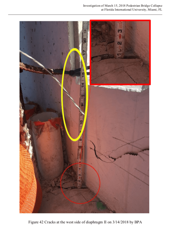

Sure, but the presentation included photos of the big cracks. So they can't claim they had no idea it was cracking like that when they put together that presentation.

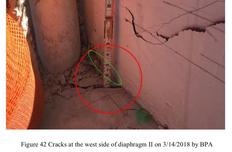

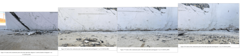

The four photos you have presented of the member 11 and 12 to deck area - show serious horizontal splitting of the east face of that zone, particularly the fillet between 11 and 12 - am I right?
It looks like each of the photos laps the adjacent pic by about 50% but the takeaway is the same. Serious cracking about 8" above the deck surface. That is about where the top of the 7S01 shear friction bars was. Such a lack of confinement reinforcing.
In your sketch of the blow out area - it seems the departing block was defined by the PT confinement of the anchorages of D-1 at the upper region and expanded diagonally below that zone. Much of what I see in the end of that deck section/diaphragm below that PT anchorage (from OSHA pics) looks like diagonal tension.
The pipe sleeves probably defined two zones - one south of and one north of the sleeves, with a weakened zone at the sleeves. That likely allowed each side - A and B - to fail separately, IMO. If that is a valid idea then there were 3 zones of failure, each with different modes and stiffnesses. +

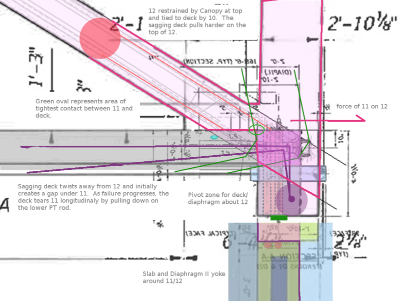

Saikee119 has shown the failure zone definitively. Consider that block A remains intact after the collapse and block B is scooped out.
I propose that the deck and diaphragm form a yoke around 11/12 (under 11 and around 12) and are attached at the base of the diaphragm, otherwise detached and free to pivot about the attachment (rebar can only offer limited resistance and acts as a damper to movement). The detachment of Saikee's Block B from the diaphragm allows the structure to sag. It is the sagging structure that twists the diaphragm/slab off of 12 and also opens the crack beneath the heel of 11. Note the point of tight contact between 11 and the deck highlighted below with the green oval.
The sagging structure is actually pulling the lower 11 PT bar down and tears 11 longitudinally. This tearing is what was initially visible as the fine longitudinal cracks from the time when the form work was removed. The upper 11 PT bar is not free to move down. The tension cracks at the upper fillet between 11 and 12 is further proof of 11 being pulled apart by the two PT bars anchored in the conflicted members (yellow oval).
This complex cause and effect would not likely have been apparent to the workers, nor was it apparent to the Engineers though all the signs were visible from the outset.

The four photos of the CJ cracks are intended to demonstrate movement covers a distance up to but not including the vertical sleeves. After the sleeves the separation changed direction and I am about to show it with a sketch. I only lined up the four photos but couldn't overlapped them as their magnifications may be different to each other.
The triangular fillet can be seen without the bottom crack so it was still part of the deck. How much 11/12 moved away from the deck can be estimated by the horizontal width of the fillet's diagonal crack. I would say the movement could be easily 5 to 10mm. This magnitude corroborates with the separation between concrete and sleeve at the west side. The fillet crack shows conclusively 11/12 has separated from the deck at the front or the south side.

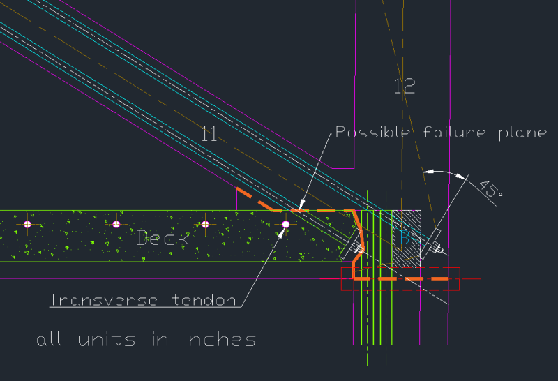

A prediction of the failure plane based on OSHA report photos
Using the photos from OSHA report I venture to suggest a possible failure below.
Section of 11/12/deck joint with PT rods, transverse tendons and cast-in items added (edited)
The firs part of the above failure plane is the shifted CJ. OSHA Fig 18 shows cracks appeared as soon as the bridge was first required to support its own weight by removing the shoring while the bridge was still at the roadside casting yard on Feb 28, 2018. Subsequent OSHA Fig 32 to 38 show the CJ had shifted about 5 to 10mm after its tension was removed and the bridge was resting at its final position on Mar 10, 2018. OSHA Fig 63 to 70 indicate the lower PT rod firmly anchorded to the deck.
I have assumed 45 degree stress distribution from the anchors and the lines of influence are depicted by brown dotted lines.
After passing through the lower PT rod anchor the last part of the failure plane is less certain because the initial failure plane may have been complicated by the consequential damages caused by the final separation of 11/12 from the deck.
An importance feature of the above sketch is that the lower rod was clearly holding up the deck while the upper rod was more effective on 11/12. The alternate stressing and de-stressing of the two rods would encourage movements and exacerbate the distressed joint. This is because the lower rod was compressing concrete stiffer than the upper rod. By releasing or applying same tension, typically 50 psi per rod at a time, the strain would be different in the two rods. Different strains cause concrete to deflect by different amount and the difference widens and elongates the cracks. Personally I consider the two rods in Member 11 badly arranged at a position seriously compromised by the embedded items. The upper rod especially became more flexible because as it had more self-arranged weaknesses than the lower rod. Subsequently a simple tensioning or de-tensioning of the two rods could generate uneven strains leading to detrimental damages to the bridge. The uneven strains from the same tension force of the two rods could be the very culprit responsible for the bridge collapse.

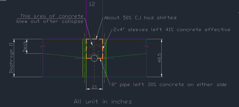

Rear view of Member 12 with Diaphragm
It is certain that bonding surface of the diaphragm to Member 12 would be compromised by the 4” vertical sleeves leaving just 41% concrete effective in the vertical direction.
Additionally due to the presence of the 8” pipe cast horizontally the concrete at the centre line of this pipe was necked to have just 30% concrete on either side.
Bounded by the above weaknesses of a shifted CJ at the top, vertical sleeves on both sides and a horizontal pipe at the bottom the enclosed concrete suffered a blow out during the collapse.
Before the collapse 11/12 was retained in position by the rebar many of which could act as dowels. The ferocity of the cracks would suggest some yielding in the steel and internal local concrete crushing, especially surrounding the rebar.
