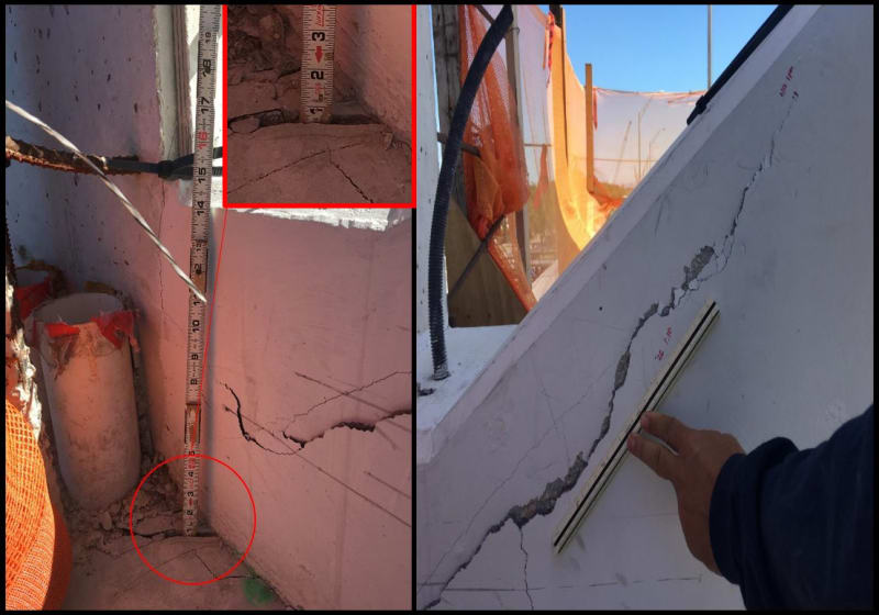

saikee119 Would the bridge still stand today if the de-tension operation were omitted?
It is basically impossible to predict when a compromised structure will collapse, but it is possible it would still stand. I think there is a very low likelihood, however.
Stressing was to proceed by ( 1) partial stressing the deck, D1 tendons only,
( 2 ) partially stressing canopy , and ( 3 ) Stressing 2 and 11 (in anticipation of the end bays cantilevering during transport).
While supported by the transporters at the first interior bottom panel points 3/4 and 9/10, members 2 and 11 were in tension so they were prestressed to about 560 kips, in the case of 11. The cantilever created about 250 kips tension in 11 so it remained under about 310 kips compression.
The self weight force in 11 when spanning the full 174 feet has been presented as 1300 kips compression, and I agree with that approximate load. Live load will create about 0.25 X 1300 = 325 kips. So the combination of PT force (530 kips) and self weight (1300 kips) exceeds the anticipated Total Load (unfactored - the “real” load) by about 200 kips. Without consideration for (or knowledge of) damage to node 11/12 it was appropriate to remove the PT forces in 11 when the weight of the structure was transferred onto the pylon and south support.
As I understand things, cracking was observed at node 11/12 just after the PT forces were removed. Because the 560 kip PT force was internal to member 11 it loaded that member unnecessarily. And the angle of 11 was 31.8 degrees (less than 45 degrees) so the PT caused more force thru the cold joint than it provided perpendicular clamping force. But ( my current thought is) apparently the compression under the anchor plates at the 11/12 end also provided confinement to the concrete in that zone, which was providing unexpected resistance - assisting the “R” in LRFD.
I pose for consideration that the unexpected resistance was anchoring the lower zones of what became the break out failure mode.
The deck level portion of the final failure plane had slipped earlier, and without the backup of the lower zones presumably mobilized by the compression under the PT anchor plates the failure progressed in an increasingly dramatic manner.
The “shear friction” resistance of the cold joint was not uniform across the contact plane. This allowed incremental failure of the different zones, with the demand increasing on those remaining zones. Releasing the PT in 11 likely allowed this failure mode.
Maintaining the PT forces in 11 was not intended and would likely have masked what was a very questionable connection. Maintaining the PT force might have allowed time for remedial work, but without additional support that work would have been performed at great risk.
In short, I am amazed that a firm with the record of FIGG experienced this problem we see in 11 and the 11/12 node. I am astounded that they could not see a failure in progress and imminent.

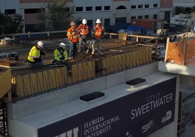

These are mounts for the formwork props (pipes) I was referring to. These props were mentioned in OSHA report.

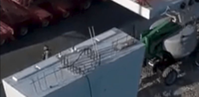

If it was OSHA report Page 32 you were referring to my interpretation is four hard bearing pads are the standard bridge bearings. The drawings signed for construction show 2 bearing per diaphragm but one construction photo does show 4 bearings.
The B46 and B47 official construction drawings show no side attachments so I tend to regard them as temporary work to be removed after completion.
The attachments pointed out by you cannot be bearings because in the final position there is no concrete support underneath them as depicted by this photo.

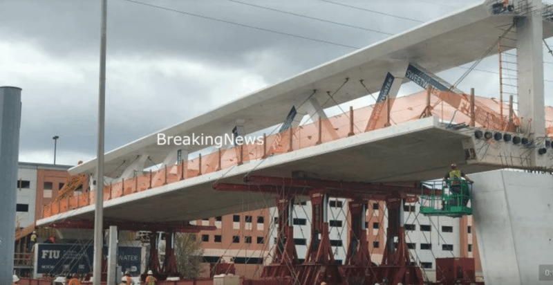

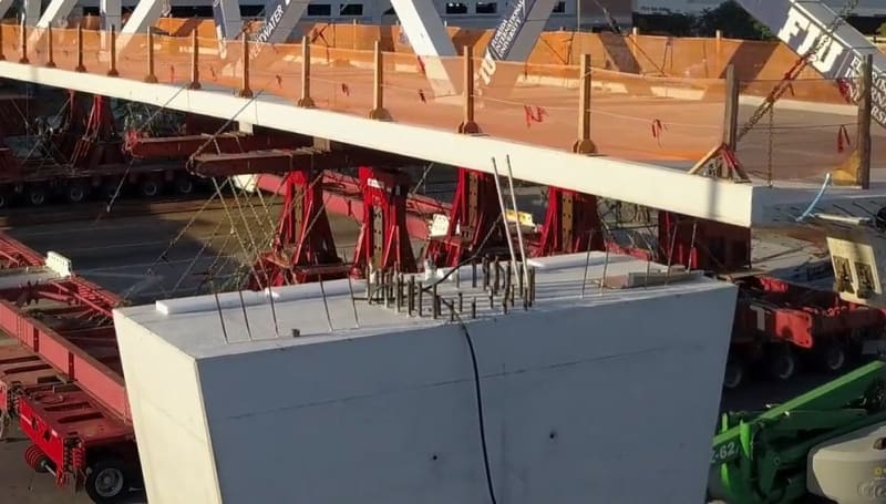

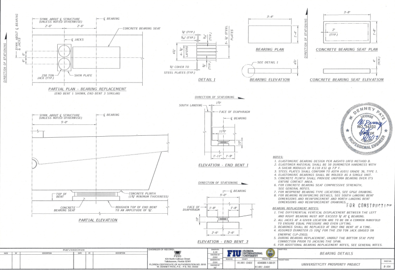

Here are some cropped images taken from the DROPBOX drone footage:
DJI_0013.mp4 at 00:59 (your image was taken from the same video, at a later time)
DJI_0014.mp4 @ 01:10

I could only find one drawing below showing bearing details.
MikeW7 photos seem to suggest the bearing arrangement was different between the span's two ends. The above drawing has no information on Bent2. Looks like Bent1 is the south end of the doomed span, Bent2 the midpoint the doomed span meets the back span and Bent3 the north end of back span.
Dumb question about pads on the north pier: Shouldn't the canal span also sit on pads? In the picture I posted there doesn't appear to be room for pads because of the vertical rebar.
(1) The de-tensioning of 11 damaged connection beyond repair. (strengthening modification would be required if the connection were to be rebuilt)
There are arguments for the "beyond repair" part. That joint shows significant damage in photo 4 well before the PT rods were de-tensioned. Is it actually practical to repair that area of the bridge with it overhead? That would likely require shoring the bridge and de-tensioning the end of the deck and 11/12 members could be completely rebuilt. So, could the issue even be repaired? I'm suspect the experts would say no, it's not possible. Don't forget, the other end likely had the same issue and would also need a similar re-built to also build it right.
You seem to be pushing the opinion that it was properly constructed but either the tensioning in 11 or the move broke it. I doubt there are many others who share that view.
I like to know why doing something harmless (to reduce the compression in 11 by removing the PT rod tension) could damage the structure so seriously. And then restoring the bridge to its previous condition could kill it.
The de-tensioning wasn't harmless, but that's because the structure had design issues and changing the forces let those design issues behave differently. Overall, I would bet that a similar failure would have eventually occurred even if the PT rods in 11 were left tensioned. The joint was failing from the start, the speed just increased once the tension was released.
As for your second point - the joint started to fail and the releasing of the PT rods let the failure progress much further. It should be rather obvious that re-tensioning the rods can't undo the damage in the joint.
Not a dumb question. We just have no information on the north end arrangement.
As an idiot trying not to be one I would say it is unwise to slide the bridge bottom on the bare concrete north pier and to drop a thin layer of something hard and noncorrosive would be ideal. A proper bearing, allowing the standard horizontal bridge movements, has already been specified at the south pier.
OSHA report has the following references:
"The diaphragm sat over the bearings consisting of four hard plastic pads."
"FIGG asked MCM at around 9:45 am to put an additional plastic shim “right away” similar to the existing shims on the pylon directly under the diaphragm."
after large cracks were discovered in 11/12 on Mar 13, 2018.

saikee119 (Structural)24 Jun 19 10:46 I like to know why doing something harmless (to reduce the compression in 11 by removing the PT rod tension) could damage the structure so seriously. And then restoring the bridge to its previous condition could kill it.
In my mind member 11 and node/joint 11/12 to deck were seriously under capacity , particularly in the stand-alone condition of March 15. Movements in the joint were apparently slight prior to transport and de-tensioning.
Releasing the PT was not harmless, IMO, because it relaxed internal stresses in the zones just ahead of the PT anchor plates, allowing some strain and deformation from the now first time 1300 kips member 11 was loaded with.
So there was some mis-alignment due to cracking, resulting in loss of interlock of previously homogeneous concrete, and after the cracking had progressed to a visibly recognized failure in progress, the PT was restored. The misalignment of pieces was not restored because the movement had been too great, and internal grinding and crushing was the result. This did not restore the joint to its previous condition.
At this point, the joint has completely failed, and collapse is underway.
Had there been time to restore the support of the transporter (or otherwise provided support), epoxy repairs could have been considered.
