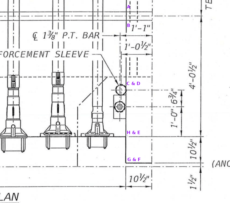

A plan view as requested
FortyYearsExperience (Structural)

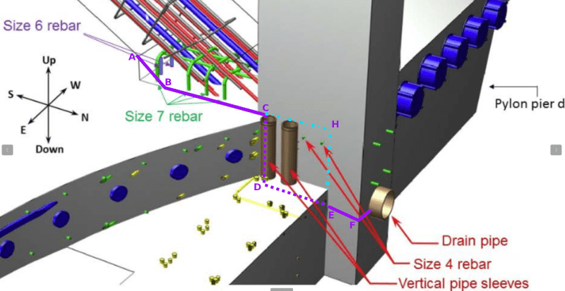

Also a 3D cutout view (originally from NTSB Final Report Fig 16)
Please note area bounded by C-D-E-H is the East face of Member 12 bonding with the deck. It has an identical West face at the back of member 12.
The flaw of the design is that along the East/West direction the longitudinal tendon anchors, shown in purpose, prevent placement of rebar linking Member 12 with the either side of the deck. The two size 4 bars, shown green in BTSB 3D sketch, were the only reinforcement.
In the South/North direction it is also impossible to place large rebar to link Member 12 with the deck because the obstruction by the two PT rod anchor plates.
The devastating effect of the two 4" vertical sleeves, extending to the full depth of 4'-3.875" of the diaphragm, on either side of Member 12 should not be overlooked. Their presences and locations served as a partial isolation joint between the deck and Member 12.
The positions of the two PT rod anchors can also be significant when examining the NTSB Fig. 32. It could be seen while the re-tightening of the lower PT rod could progressively compress the deck against the 11/12. The similar re-tightening of the upper PT rod, on the other hand, could encourage the concrete to debond along interface D-E-F which at the thinest point is only 6.2" wide on either side of the 8" drain pipe.

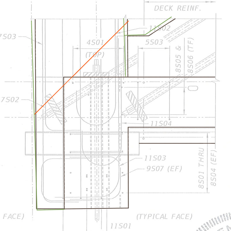

I may be missing the question here, but does there have to be an actual vertical shear plane, in this case? It is my understanding that this structure is primarily a warren truss with some minor frame action due to the joint construction. As such, the vertical load of the truss is delivered to the support by an axial force in the diagonal web member ending over that support. The vertical reaction of the truss is supported by the vertical component of the axial load in that member. In a true truss, and with that diagonal member not being vertical or horizontal, there is a corresponding horizontal component of that axial force. When the joint fails horizontally and no longer resists the horizontal component of the axial force in the diagonal, the vertical component is lost also. Thus a horizontal failure results in a loss of vertical support.
I do not see this failure as being significantly different had there been an intentional slip joint, perhaps in the form of teflon pads, at the surface of the deck with Members 11 and 12 sitting on it and no reinforcing passing thru the joint. There would not have been a vertical shear plane. There would have been failure due to a lack of resistance to the horizontal component of any axial load in Member 11, preventing the development of any axial load in Member 11 EDIT ADD and therefore preventing any vertical component to support the structure.
It would have happened long before transporting and likely during removal of falsework. Actual joint construction, reinforcing, and post tensioning simply prolonged the event until 1:46 PM, March 15, 2018.
Compressing the deck against 11/12 could be a good thing because it could generate additional clamping force for shear friction and thereby increase the joint capacity in shear. But that is not all the lower PT rod does when tightened. While it compresses the deck against 11/12 it does so because its tension force is delivered to member 11 as compression at the top of the canopy and is then delivered by Member 11 to the deck at the 31 degree angle, therefore it has a greater horizontal component in shear than a vertical component to compress. So retensioning the lower PT rod was not a good idea either. The lower PT rod was adding shear faster than it was increasing capacity.
The same thing could be said of the upper PT rod until Member 11 and the joint to Member 12 began to split. Until that point both PT rods were adding shear more than clamping compression, and instead were contributing to the cracks in the deck around Node 11/12 and the pvc sleeves. After member 11 split and the joint began to disintegrate, the failure was underway.
It could seem that the EOR found advantage in the low angle of Member 11 and sought to restrain the failure evident in the deck using the horizontal component of that added/restored PT force. It could maybe have worked if the upper end of Member 11 were fixed to some immovable object, but instead Node 10/11 just reversed the force and pushed back on Node 11/12.
I have yet to distinguish in my mind between whether the splitting of Member 11 happened before or after or during the shear failure of the deck block beneath Members 11 and 12 and between the 4" vertical sleeves and above the 8" drain sleeve.

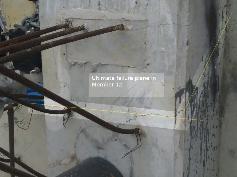

Upon closer inspection of what I suggest is the ultimate failure plane through Member 12, I realized that it does not follow the trajectory of the upper PT rod in Member 11 but rather it is the 45 degree shear plane of Member 12, which is relatively fixed at each end but not fixed to the slab. Thus, the collapse occurred when Member 11 ultimately broke the back of Member 12 which was forced to act as a buttress to Member 11.
A trace of the crack in Member 12 from just above the lower slab rebar at the north face of 12 to just below the upper slab rebar at the north face of the deck reveals this possibility.
Edit: To clarify, Member 12 had to allow Member 11 room to move north. The shear plane in 12 was the weakness that was exploited but once enough northward movement had occurred, Member 11 failed just above the nodal block to start the cascade. The falling deck rotated the diaphragm off of the base of 12 while 11 hammered into the node. I believe that this sequence allows for the deformity in the upper PT rod in Member 11 to occur while the lower PT rod kinks at the slab.

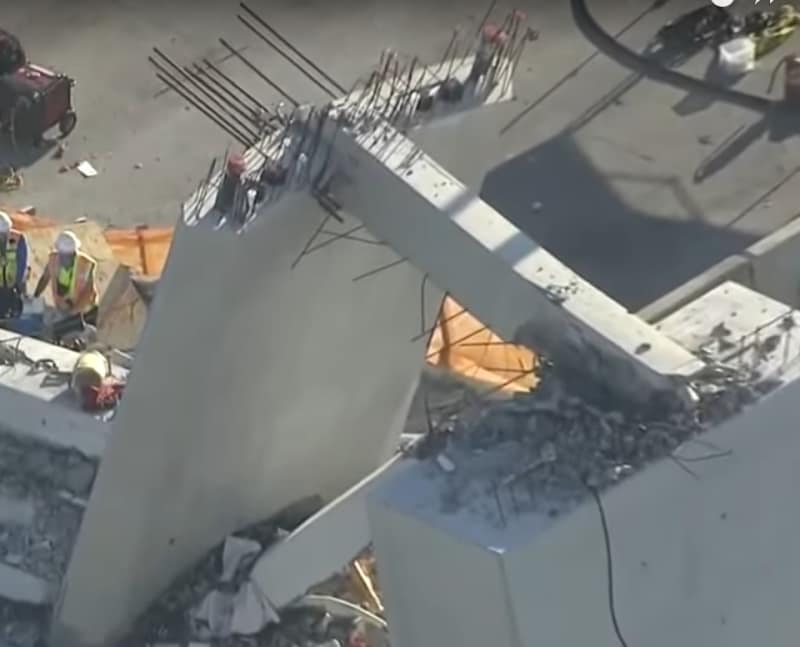

The above postulation does not appear to be supported by the collaspe photo shown below. It is clear that after collapse the end of 12 was resting on the top of the North pier. Had 12 been allowed 11 to move north by shearing off as claimed then 11 had be further north of 12 but it ended up below and on the south side of the pier.
The second weakness of the postulation of 12 shearing off is that the shearing plane can only take place when 11 was moving but 12 did not. This is impossible because during the collapse a hinge was seen at 10/11 connection with the canopy. Thus the triangle formed by 11, 12 and the canopy was initially rotating as one entity and there was an absence of force available to shear off 12 within itself. Remember once in motion the bridge was a mechanism.

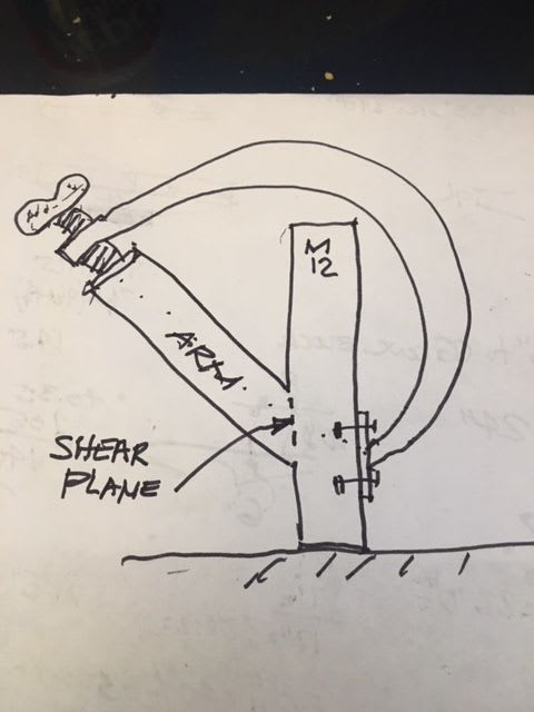

How about imagining just 12 on its own but with an arm sticking out at 31 degree. You can stressed this arm with PT rods as much as you want and it would not affect 12.
Another way is to imagine if you have a flat equilateral triangle on the ground each side is like Member 11. By post-tensioning one side internally with PT rod you will not get the remaining two sides stressed to the same level. The post-tensioned side will shorten axially in responding to the PT rod stress but the other two arms will simply bend slightly inward to accommodate the exial shortening of the first side. So the internal post-tensioning is not additive to the summation of forces at a nodal point in the equilibrium calculation. That would be my interpretation.

If the arm does not bear on the support below, the same problem exists at the face of the column. In this case the sliding force is vertical. On March 15 the sliding force from the PT was horizontal.
Here is a Member 12 with an arm and prestressing. If the acute angle between the arm and Member 12 is "A" it is my opinion the shear at the dotted "shear Plane" on the side of M12 is Clamp Force (PT) * cosine A.
Vance, that's a great diagram and does not in any way represent the bridge in question.
saikee, the lower rod was not in 12 at all. The casting of 12 also stopped at the surface of the deck with the same cold joint as 11.
Would neglecting the shear in the "shear plane" make it more relevant?
Vance, trace over the diagram I copied from the post by SymP.le and you wlll see there shear plane is between 11 and the deck, not between 11 and 12 and that the lower end of the lower post tension rod is in the deck and not in 12.
The force between the top end of the lower PT rod acts to force the 11/12 joint horizontally away from the deck.
The force of the lower PT rod was acting against the deck not against member 11.
The force exerted by the lower PT rod was trying to open the crack rather than pull it together.
The concrete had already sheered and shifted.
Only the re-bar was holding the joint together.

Oh, I know - I am still chuckling about your response. Thank you for the compliment.
I was responding to " imagining just 12 on its own but with an arm sticking out at 31 degree. You can stressed this arm with PT rods as much as you want and it would not affect 12."
My concern is there seems to be a thought that the PT force does not have anything to do with shear at the top of the deck.
Hopefully I am just misunderstanding the points being made.
