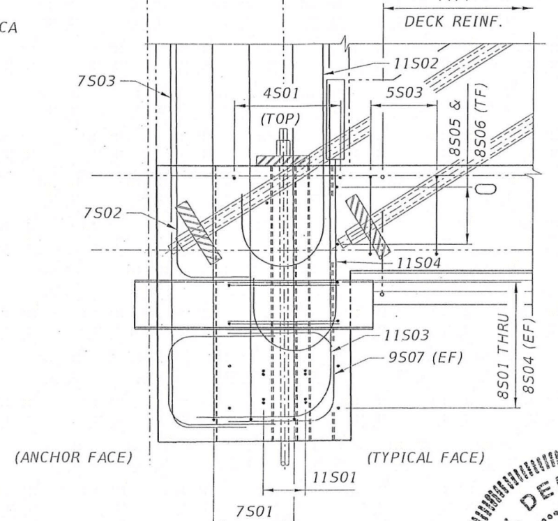

Sym P. le (Mechanical) said:

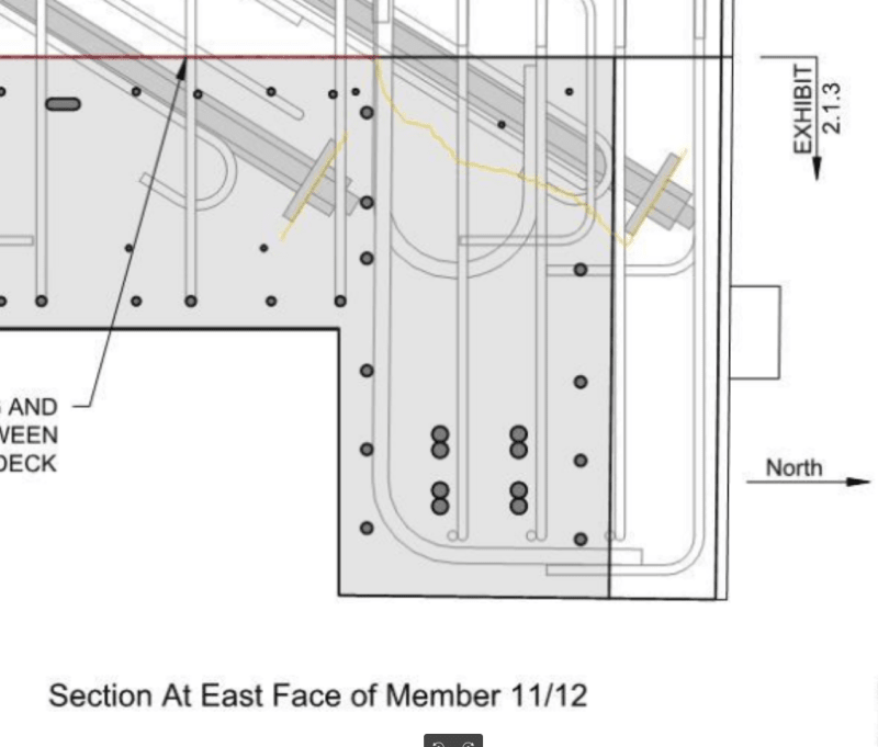

The whole of your vertical plane CDEH has virtually no connective value, the result being that Member 12 becomes a vertical beam which 11 is pushing against.
There are several pre-existing design arrangements which weaken the connectivity of area CDEH. Amount them are :-
If you look at the area CDEH of NTSB Fig 32, available in 7 Jul 20 16:24 post, you will find the 4" vertical sleeves have taken up more than 50% of the available surface. The imposition of the sleeves displaces the concrete making locally insufficient amount to grip the reinforcement. The thin concrete layers between the sleeves and the rebar could break easily and trigger the bond failure of the whole bar.
The area around the vertical sleeves is congested with reinforcement too making even less concrete to bond the reinforcement. You can see from OSHA Fig, 70 for yourself.
The stress direction inside 11/12 is significantly different from the deck. The deck is uniformly post-tensioned by tendons both longitudinally and trasversely except the plan area of 11/12. Once the deck was post-tensioned the south portion of 11/12 could be influenced by the D1 tendons on both side of Member 12 but the rear of 11/12 was not stressed. Then when the PT rod stresses were applied the strain direction was about 31 degree to the horizontal. Thus area CDEH is the interface of two highly stressed zones each pulling it own direction. This explains why the concrete could pulverize and able to leave the flexible vertical sleeves almost undamaged. The deck section after collapse is also solid around the prestressing tendons zones because the stress is homogeneous there.

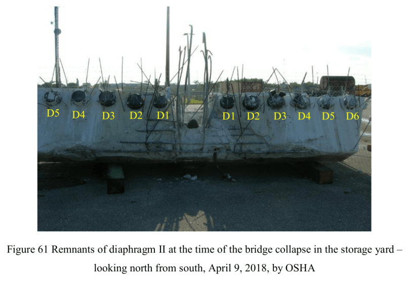

Due to the presence of deck's longitudinal tendon anchers, label D1 to D6, on either side of 11/12 it was impossible to place decent size reinforcing bars in the south to north direction through area CDEH to connect Member 12 with the deck.
Finally from the failure suface/plane established by NTSB and WJE it should be obvious that the lower PT rod was able to anchor into the deck and could be difficult to overtighten. The upper PT rod on the other hand seems to pull the 21" thick 11/12 joint mainly and with little participation from the deck. This could be a recipe of disaster because the rod stressing can also inadvertantly exert stress and help to break the CDEH connectivity with the deck.

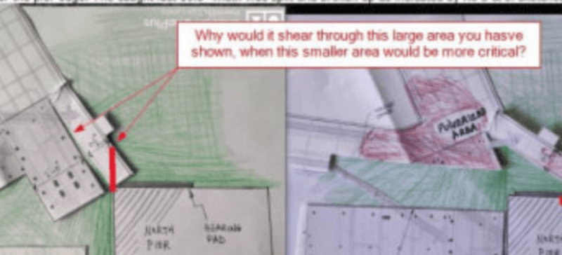

Very nice "sketches".
In sketch 5 the deck and diaphragm have slid south until the 2' wide sections of the diaphragm can just begin to fall. The 10.5" extension of Member 12 remains over the pylon. Member 12 and Member 11 are shown intact and in their original relationship to the deck.
At the point shown in sketch 5, Node 11/12 has slid 2 feet from its original location on the deck and has likely taken the 'blow out block' with it. The bottom of that block is defined by the top of the 8" sleeve, and the projection of the deck below the pipe sleeve was easily broken off the deck. But I think the important thing is Members 11 and 12 were severely damaged by their movement across the deck and the angle of Member 11 to the deck should have decreased as Node 10/11 dropped while the end of the deck had not yet cleared the pylon.
So I am of the opinion that Members 11 and 12 were damaged in their lower sections before the deck projection below the pipe sleeve was broken off.
Also the angle of the deck at the instant depicted in sketch 5 is likely a bit flatter than shown, because Node 9/10 is about 40 feet from the end of the structure, and the fall distance is roughly 18 feet. So the top of the deck at impact of Node 9/10 on the street should be less than 30 degrees below level.

I must admit that my schetches 5 & 6 have not been corroborated with the estimated collpase trajectory worked out by others.
I also do not have information on the order of which part of 11/12 broke off first before the others.
The purpose of my sketches was to show during the diaphragm sliding off the pylon the falling dead weight could help to tear off the rear 10.5" of Member 12 from the diaphragm's body.
In agreement with you it is entirely probable that NTSB reported blowout, to the north of Member 12, took place at the level of the 8" horizontal drain pipe, due to high concentration of stresses, and so above this drain pipe level there was no concrete left to be split from the rear 10.5" of Member 12. Nevertheless the splitting of the rear 10.5" of Member 12, commencing from the bottom upward, would be able to rip out the Member 12 north face vertical reinforcement cast in the first lift of the concrete pour.

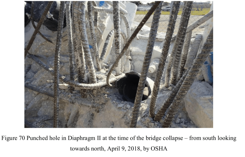

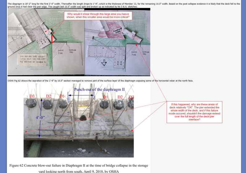

On the possible extra damage to the pylon and the rear of the diaphragm my explaination is as follow:-
On the pylon we have no information of damage. Secondly the bearing area of the pylon has been designed to take half of everything the bridge got so it will not shear off a corner if that is what you expected. Beneath the bearing there should be heavily reinforced with additional anti-burst reinforcement similar to the end of the post-tension anchor.
OSHA Fig 61 & 62 show a triangular layer section of the north face of diaphragm peeling off to expose the reinforcement inside. The reason only a limit section of the surface layer came off with Member 12 is due to the proximity effect. The splitting force came from the 1'-9" wide Member 12 and the OSHA 61 below shows the influence extending about 2 to 3 times the Member 12 width, about the bottom of anchor D3/D4, on either side at the bottom gradully reducing to 1 x width at the top. This is the same agrument like when considering the second moment of area of this bridge in resisting load one cannot take the full 31'-8" width of the deck but only a short section on either side of the web as the effective width for the bottom flange. Different codes allow different effective lengths but between 2 to 3 times the web width seems to be borne out by the evidence of this bridge.
The peeling off commenced from the bottom and would have travelled upward at an angle about 45 degree. It was abruptly stop near the tendon anchor D1 because the surface layer there was in high comression resisting the splitting.

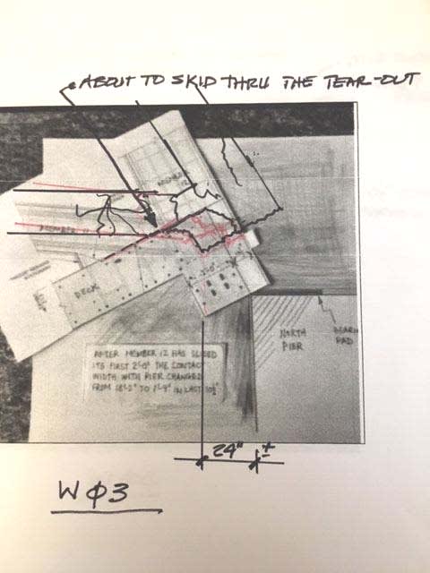

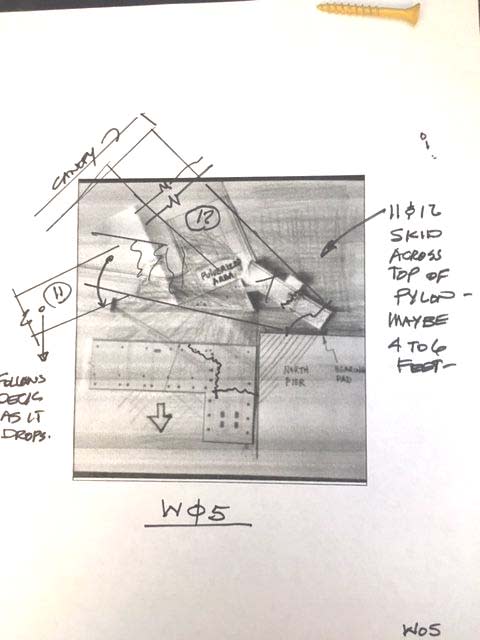

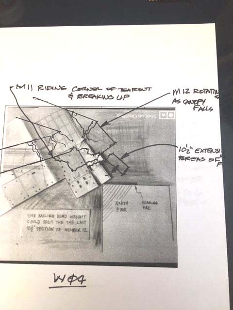

Your "sketches" are just too good to leave alone. First - the legal disclaimers.
Background sketches courtesy of saikee119 (Structural) . No copyright violation intended.
DDDDave - this is the closest thing to tracing I can get. Sorry I can't meet your standards.
A decoder ring may be needed to correlate my numbering with that of Saikee - my numbers are one less than the numbering on his sequence of sketches.
3DDave - it is the author's intent that the background sketches are detailed enough to provide sufficient relevancy to the subject of this forum.

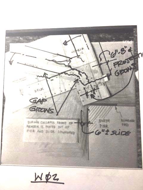

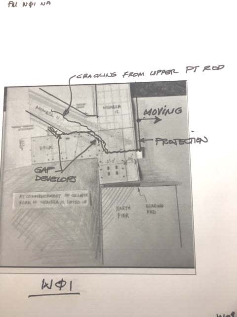

The next 5 sketches show what I think is the probable failure sequence. Please consider the sketches as sections cut thru the center of M11 and M12 so the internal voids can be illustrated.
W01 is basically depicting my idea of conditions while re-tensioning the PT rods in Member 11. The Node 11/12 had slipped about a half inch before retensioning began. The lower PT rod is anchored in the deck, the upper PT rod is anchored in the block which is moving with the bottom of M11 and M12 and which is being pushed out of the deck at the north end. The different anchorage conditions cause cracking in M11.
Sketch W02. The angle change in the deck, M11, and M12 is shown greater than I think is correct for a sliding distance of maybe 6 inches by the deck. At 6" slide I find the angle to be about 16 degrees. Internal voids increase and cracking increases as Node 11/12 pushes farther out the end of the deck.
Sketch W03. Member 11 is just about to drop into the void left by the blowout of the block in the deck. Vertical load from M12 will likely break the end of M11, angles are changing quickly as Node 10/11 drops.
Sketch W04. Diaohragm just clears the edge of the pylon. The blow out block above the 8" pipe sleeve has cleared the end of the deck and is falling onto the top of the pylon. Member 11 is breaking up as it bends over the corner of the deck. The 10.5" projection of the deck under M12 and below the 8" sleeve is breaking off the deck.
Sketch W05. The Deck is falling beside the pylon while the bridge pancakes and Member 11 folds against the deck. The lower ends of M12 and M11 skid across the top of the pylon and stay there. The canopy dives onto the deck as the deck hits the roadway.

Sorry.
Totally wrong.

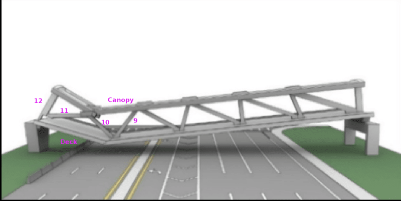

There are two triangles involved.
Triangle one is formed by member 11, member 12, and the canopy.
Triangle two is formed by member 11, member 10, and the deck.
When the collapse starts, the base of the second triangle starts to elongate.
Your sketch doesn't show this.
As the structure starts to fall, member 11 is pushed further out, hinging at the canopy.
Member 11 will continue to push out until the top of the canopy is at the level of the top of the foundation.
At that point, a little over 10% of member 11s length will be pushed out across the top of the foundation.
But don't forget the lower PT rod.
This is anchored in the deck.
As the collapse starts, the lower PT rod must break its way out of member 11.
There is no tension left on the rod but member 11 is moving north, as the structure falls the deck with the end of the PT rod is being pulled south.
In the first few inches the lower PT rod must break out of member 11.
As the structure falls the deck pivots at the lower end of member 10.
As the structure falls the deck is angled between the pivot point and the top of the foundation.
It doesn't take much fall of the structure for the deck to be pulled off of the foundation.
Member 11 is going north, the deck is going south.
This drawing is wrong.
The canopy and member 11 are shown too short.
At this stage of collapse geometry says that the 11,12 node will be pushed out past the north side of the foundation.
The deck is shown too long.
At this stage of collapse geometry says that it will have been pulled off of the foundation and be either sliding down the face of the foundation or have been pulled back enough to fall free.
I can do better than this but it will take a lot of time to first go back and find the bridge dimensions and then to set up the bridge as three pivoting triangles and show the relative positions as the structure falls.
It's grade ten geometry, but that doesn't mean that it won't take a lot of time.

A while back, I traced each member in each frame of the original dashcam video. member 11 breaks at the canopy-member 10 joint very early in the sequence.

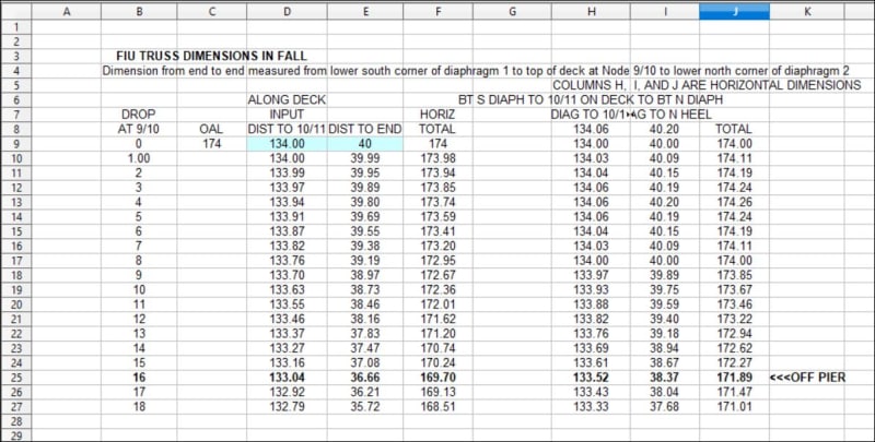

Not so long using a spread sheet. This is from about a week ago.
I used 134 feet from sta 0 to Node 9/10 but can change that in a sec.
Max O/O length of deck EDIT ADD measured from bottom of diaphragms and lower outside corners is at 4 ft drop of Node 9/10. That is the point where Node 9/10 passes thru a line between the lower corners of the diaphragms.
I assumed no crushing of concrete at Node 9/10 - the compression block is only about 2 inches deep.
Comments welcome.

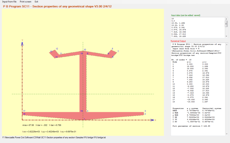

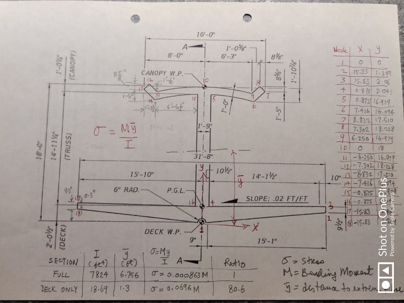

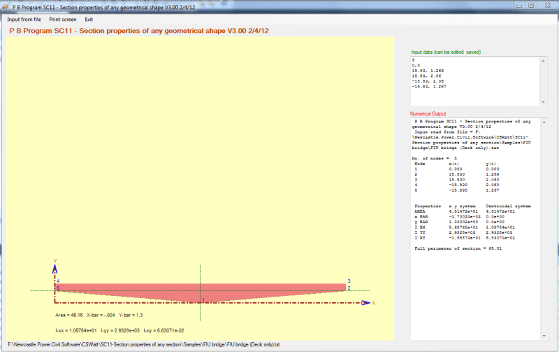

Personally I am not bothered by which hinges of 9/10/deck and 10/11/canopy moved first and consider it irrelevant. To me the hinge that matter is 9/10/deck and the canopy hinge is just to follow it.
Let's say before the collapse the full bridge has a second moment of area of 7824 ft4 and the centroid 6.756 ft from the bottom as computed by approximation using coordiate geometry.
One the 11/12 connection failed the web would be unable to hold member forces in the canopy in balance with those in the deck. The bridge was then supported by the deck only. The second moment of area and centroid would change to 18.69 ft4 and 1.3 ft respectively.
From fundamental principle of stress = (Momentxdistance to extreme fibre)/(second moment of area) the stress in the deck-only case is about 80 times of the full deck. This huge stress increases is reslistic estimate if the postensioning was intended to cause the deck in full compression when the bridge is in ist final position
Therefore once the 11/12 connection has gone the deck would be hugely overstressed and formed a hinge at 9/10/deck. The hinge at 10/11/canopy was never a driver in the collapse.
