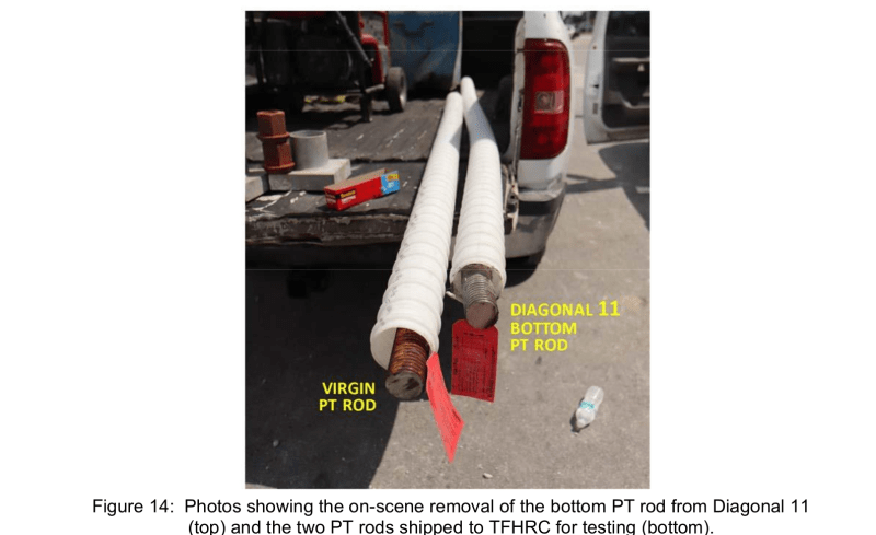

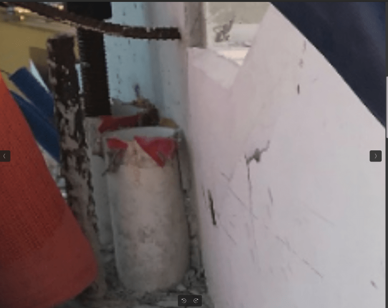

There has been speculation that the PT sleeves were 4" in diameter.
There are some pictures of the rods and the sleeves prior to the concrete pour.
The sleeves appear to be about 150% of the PT diameter or 2.5" to 2.625".
This is moot however because buoyancy will have lifted the sleeves up into contact with the bottom of the PT rods.

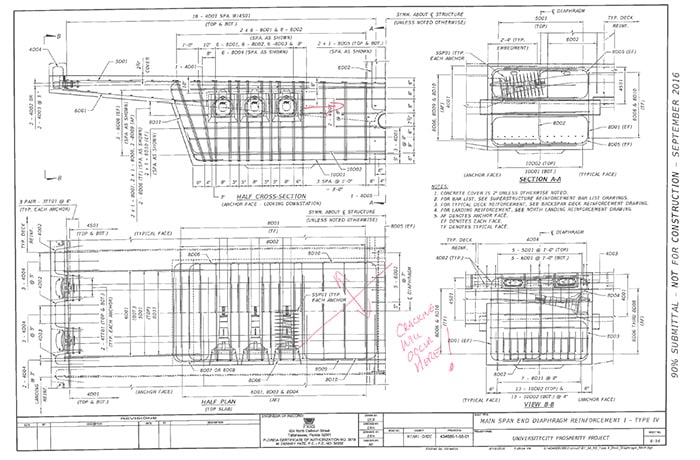

Could you point me to this information please? Sounds quite interesting!

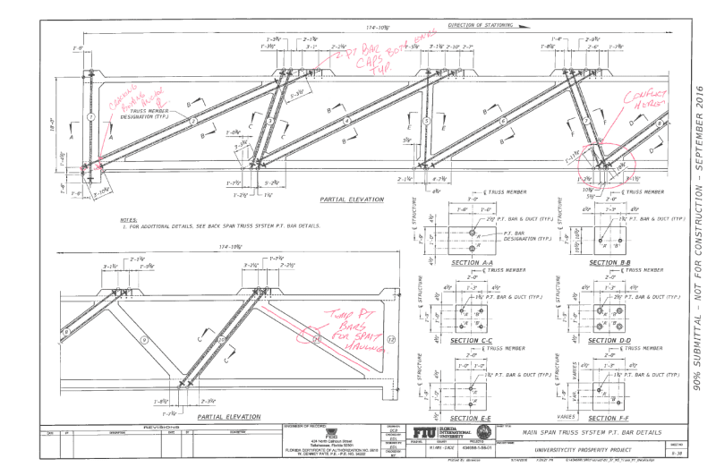

The Interactive: The Path to the FIU Bridge disaster set up be NBC has recorded some basic information by FDOT Engineer Thomas Andres.
I believe FIU also have some records. There were some marked up drawings originally but later converted to typed text and replaced by computer CAD sketches.
Here are just two of the original mark-up drawings by FDOT engineer.
FDOT engineer was doing a high level review. The cracks were marked on areas whererever uneven stress areas were apparent. They were based on years of experience on postensioned concrete. As the bridge wasn't owned by FDOT so the peer review was given to a appointed party. Nevertheless FDOT offered a brief overview which proved highly relevant.
That is a laundry list.
A set of drawings in PDF here:
Dimensions are on Drawing B37.

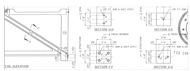

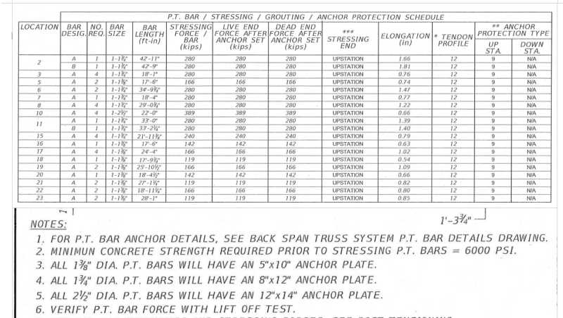

We should discount the fear of the PT rod overcompressing the concrete.

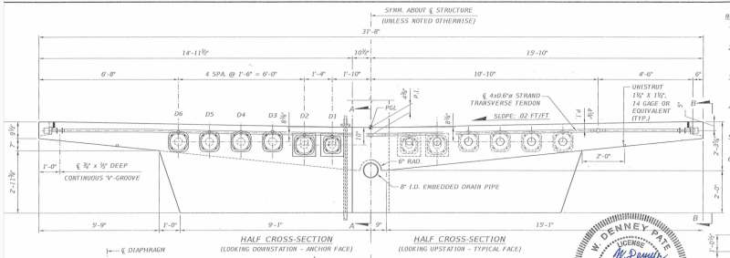

We know from the contract drawing the PT rod inside member 11 is 1.75" diameter, PT rod tension is 280kips, anchor plate size 12"x8" and the specified concrete strength is 6000psi.
The cross section of Member 11 is 24"x21".
If the entire 280kips bears on the concrete immediately behind the 12"x8" anchor plate the compressive stress is 2917psi. If the two 280kips PT rod tensions bear on the full cross section of Member 11 the average compressive strength is only 1111 psi.

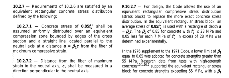

ACI design codes, say 318, permits only 0.85x specified strength to be used in design in conjunction with other considerations. Thus below a stress of approximately 0.85x6000 = 5100 psi is a safe design.
If the concrete is about to fail the actual concrete compressive stress is of course allowed to reach to the specified strength but there is fat in the system that the actual strength is invariably higher than the specified strength. When NTSB cut cores from the collapsed bridge to test the concrete strength in a laboratory the lowest actual strength was 8,580psi while the remaining four samples registered strength all above 10,000psi.
Thus I don't think there is much mileage in proving the concrete could be overstressed by the PT rods in compression. To me the concrete in trouble is in the area outside the influence of the PT rods with not enough compression.

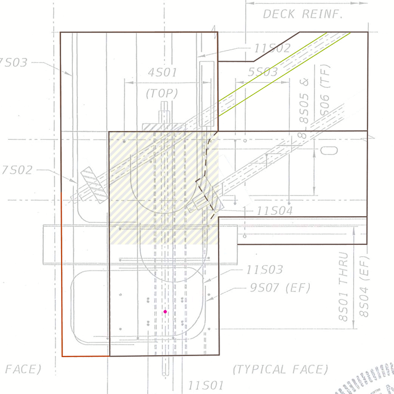

I do see one thing on which I will comment - as I recall viewing photos of the PT rod anchor plates which had anchored the PT in Member 11 they appear square to me - not rectangular.
EDIT ADD: I think we should look for a specific allowable compressive stress under an anchor plate at the time of tensioning. The general usage of O.85f'c is for factored loads. Under PT installation the load is real and temporary until it relaxes or anchors set, and some increase is permitted but I am not sure it reaches 0.85f'c.
Had a reference but just lost power for a few minutes so will return in a bit. Hopefully with a reference.
Thanks,

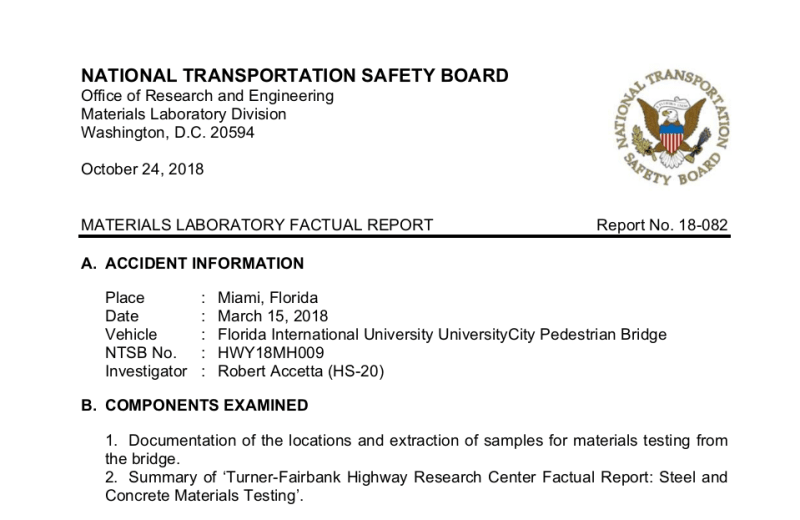

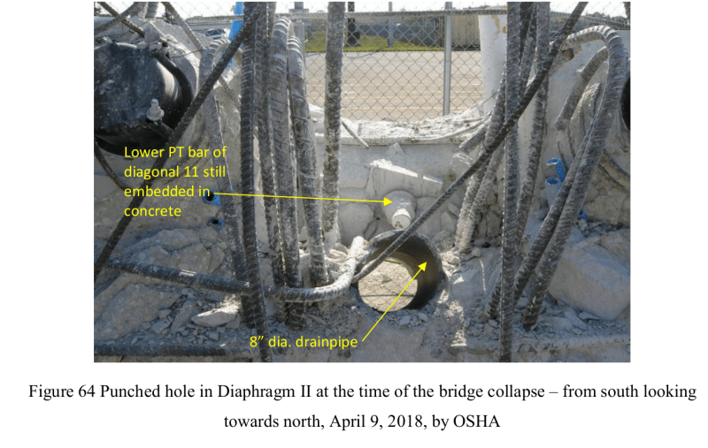

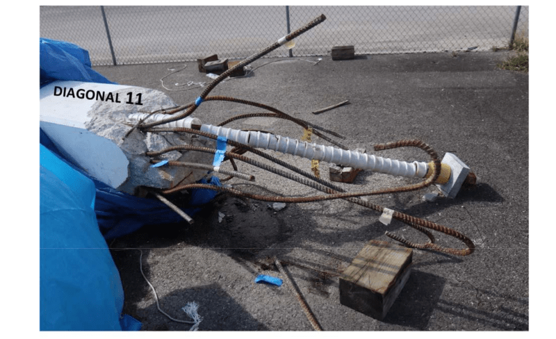

Many photos, like OSHA Fig 64, 65 & 67, show the PT rod anchor enembedded exposing only one ful edge. Hence measuring the two sides is not possible and I agree it does appear to be square in shape. I attached OSHA Fig 64 for example.
The best photo I could come up with for checking the PT rod anchor is from NTSB "Materials Laboratory Factual Report (Report No. 18-082) depicted above.
In its lower section of Fig 15 enclosed above you can save the image, magnify it and measure the horizontal and vertical edge. When I did that I got a aspect ratio of 1.5 so the anchor is definitely rectangular to me. The specified dimension of it is 12" by 8" for 1.75" diameter PT rod used in Member 11.

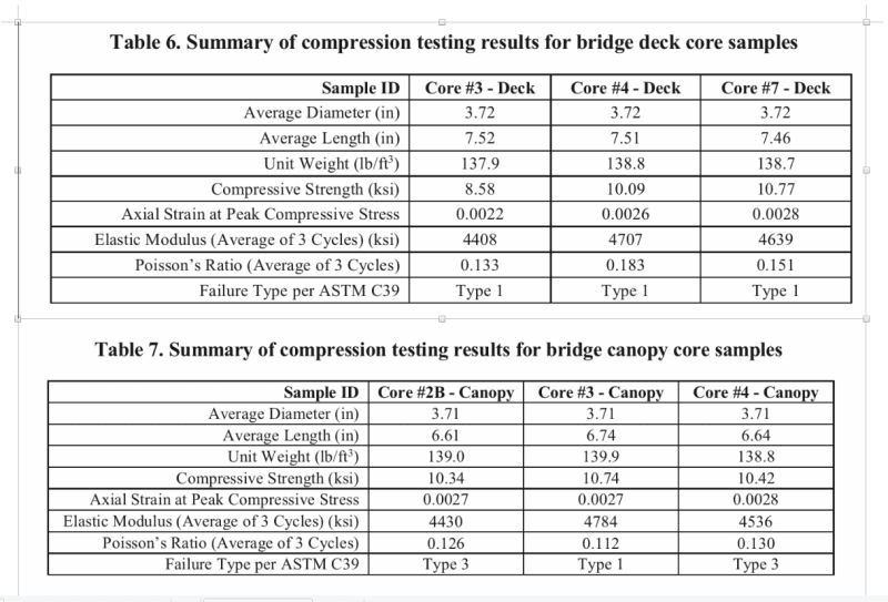

In my experience the 0.85f'c used in ACI code is to encompass a safety factor for the concrete as a material. When you do ultimate limit state design the ultimate tensile strain is 0.003 at collpase. You also have a strength reduction factor 0.9 making the net usable strength in concrete 0.9x0.85 = 0.765f'c for a ACI compliant design.
The Euro code ultimate tensile strain in concrete is 0.0035. The ultimate maximum concrete stress is equal to the specified concrete cube strength fcu divided by the material safety factor which is 1.5 for concrete. So the corresponding net usable ultimate concrete stress is 0.6fcu.
However concrete strength crushed by a cube is higher than that crushed by a cylinder. The universal conversion factor is f'c = 0.8fcu. Therefore EURO or Bristish designer would effectively use 0.6/0.8 = 0.75f'c which is close to the ACI code's 0.765f'c.
What you permitted in the design, by lowering f'c to 0.85f'c and then further reduced with a strength reduction factor, is just good engineering practice adopted universally but in slightly different formulae for different countries.
In the field the specified 6,000psi strength concrete actually has the insitu strength at least 8.580psi verified by the core samples. The acutal collapse analysis should based on the actual strength and actual stress.

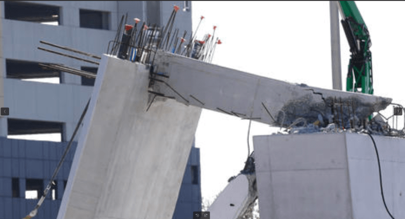

The collapse in five frames:
saikee's surface is indicated in chevrons and as I've explained before, I give it zero strength to hold 12 in the slab socket.
12 bows north under load from the horizontal component of 11, held in place at the top by the canopy and at the bottom by the diaphragm. The slab carries the downward component of 11 and passes the load around 12 to the diaphragm. Interestingly, when I rotated the upper PT rod to follow 12, I noticed that it would have to increase in length. This can't happen unless, say, the tension is released in the rod, a plausible explanation for the "cracked all to ..." upon detensioning.
I speculated earlier that the lower PT rod was a snag that prevented the structure from fully collapsing however, upon closer inspection of the PT rod duct spec and allowing for the 32 degree inclination, that allows over two inches of freedom for the horizontal movement. I now tend to believe that the structure held together with the few rebar threaded through 12 and the slab, as well as the rebar in the nodal block.
The strain from the retensioning eventually overcame the last vestige of connectivity allowing enough extra horizontal movement to cripple 11 which likely failed just above the nodal block (given all of the visible damage before the retensioning). As 11 pancaked and hammered into the nodal area, the primary rotation came from the slab which started its downward descent. Interestingly, the lower bound of the vacated socket area becomes a tension break. I believe until this time, 12 was able to absorb the strain.
Edit: Eventually 12 skips off the north end but that part is rather anticlimactic. Edit 2: I redrew the PT rod anchor plates to 8" in profile and relocated that lower PT rod closer to its as built condition. The orange line represents what I believe is the 45 degree bending shear plane in 12. It appears early in the gif but I got tired of editing.

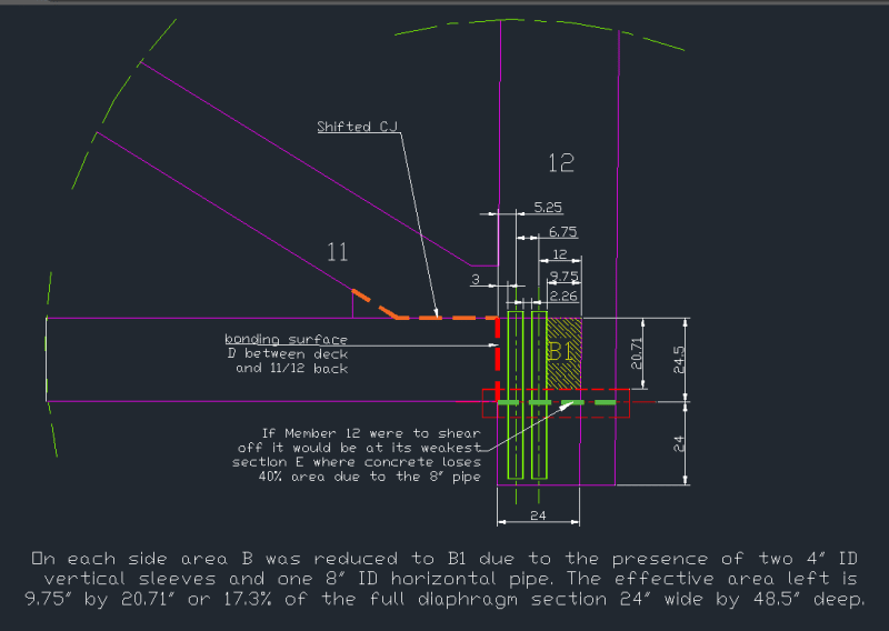

Sym P. le (Mechanical),
You presentation with the changing static images is novel so is your postulation. The idea that Member 12 was pushed out, hinged somehow at the bottom and split at the deck level with Member 11 sounds exquisite and not without merit. The holding down bolt on either side of Member 12 could have provided the rotation point have indicated with the pink circle.
However there are some weakness in the postulaion of which among them are:-
(a) The separation of Member 11 from 12 at deck level, as confirmed by you couldn’t happen unless the tension of the PT rod is released. Therefore the photos available on 15 Mar, prior to re-tensioning, should show signs of the separation. FIGG has submitted seven photos dated 15 Mar to NTSB and I enclosed two of them here. The bridge was re-stressed from midday of 15 Mar and then collapsed.
The is no sign of any crack showing a separation of Member 11 from 12 on the west face.
On the east face a small crack is visible but it seems to trace back to the PT rods which have caused rather alarming surface cracking on both east and west faces of Member 11.
(b) If there has been a separation crack of Member 11 from 12 at the deck level then we can expect the Member 12 joint with the canopy to be pushed outwards and suffered some permanent damages. The actual joint, between the canopy and Member 12, appears remarkably intact after the collapse and remains substantially at 90 degree when I measured it for any permanent deformation.
(c) The ability of Member 12, which is only 1’-9” thick, could cause a rigid body rotation of the 18’ long diaphragm is stretching the imagination a bit, bearing in mind in the postulation Member 12 would have already partially separated from the deck and Member 11. I attach the end elevation of the diaphragm to show its relative size to the Member 12.
(d) If the evidence in the field is inadequate to support your postulation after the 11/12 has been de-stressed and the bridge was resting between piers then the subsequent re-stressing would make any separation crack between Member 12 with 11 even more difficult to occur because the upper PT rod would instantly clamp the two together. It was stated in NTSB report that the upper PT rod was first fully re-stressed, the 280 kips re-stress of the lower PT rod was just completed and the bridge fell.
I think the actual failure mechanism could remain a mystery for some time to come.

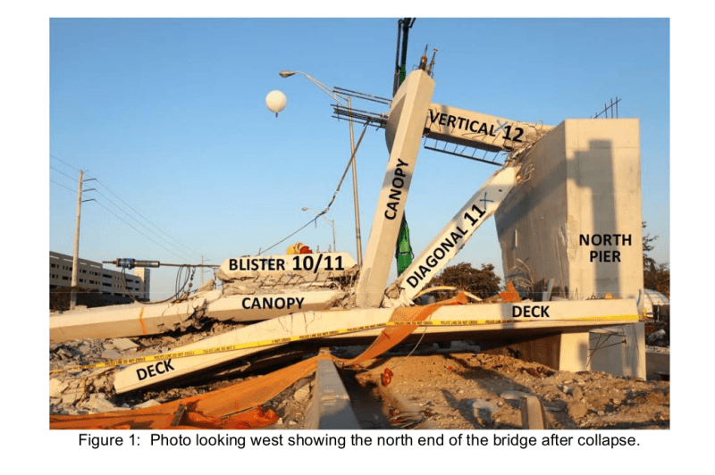

We have two triangles.
Triangle #1. Member 11, member 12 and the canopy.
Triangle #2. The deck, member 11 and member 10.
Triangle #1 pivots at the member 11/canopy joint and slides across the foundation to the north.
Triangle #2 pivts mainly on the foundation but triangle #2 is distorting. The base is elongating and is the sum of the last section of the deck and the gap created as the 11/12 node moves north. This continues until the base falls free of the foundation.
The length of member 11 is approximately 30 feet.
The horizontal component component of member 11 is approximately 26 feet.
As the bridge falls the 11/12node will move approximately 4 feet north until member 11 is close to horizontal.
To do so, the lower PT rod must be breaking its way out of the bottom of member 11.
By the way, the lower PT rod is anchored in the deck which moves very little.
The lower PT rod will be extending out of the top blister until the deck falls free.
Once the deck falls free, the slack in the lower PT rod will be taken up and then continue to break out of the bottom of member 11.

It is possible that as the joint started to fail the first 1/2 inch or so, the PT rod had enough clearance in the sleeve to both crush a little of the concrete and to curve upwards in the sleeve.
That 1/2 inch gap would have relieved the tension on the PT rod.
When the rod was retensioned, that would create a force on the top of member 11 to push it northward and may have added a further crushing force to the concrete as the tension tended to straighten any curve in the rod.
Bill

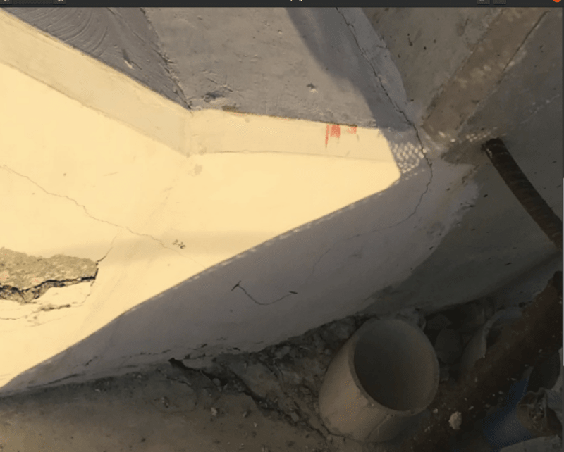

waross (Electrical) said:
I can't find an exact dimension for the height of the deck above the foundation. I estimate from 2 to 3 feet.
The above show that the diaphragm dropped to the ground while the other end was resting on precast concrete barriers.
Barrier to ASTM C825 seems to have 32" height so your height estimate is spot on.
NTSB material laboratory factual report lower section of Fig 14 shows the end of PT rod with a sleeve. My measurement is the internal diameter of the sleeve is under 3" making its overall diameter, including the ribs, about 3". You can download the image, enlarge it and scale it yourself.
As I recall, Diaphragm 2 is 4'-0 1/2" in height at the center of the bridge. I have not seen how thick the shim plates were.
So top of 8" pipe sleeve was a little more than 2 feet above the top of the pylon.
Here is a dimension:
When the 11/12 node went off the back of the pier it would have dropped 48.5 inches until the bottom of member 11 contacted the top of the pier.
Note, the 11/12 node went off the back of the pier, not the front as has been suggested in several drawings.
It would have moved about 4 feet north and the lower PT rod would have broken away 4 feet of the bottom of member 11.
Following that, the continued fall of the structure would have pulled the 11/12 node back across the top of the pier, explaining the damage to the bottom of member 12.
Bill
