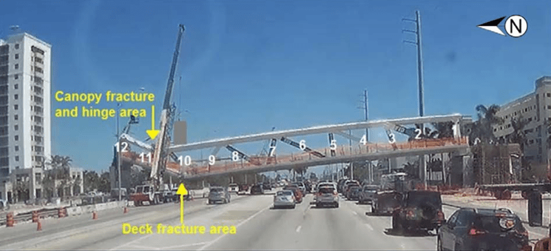

Although the 11/12 node was pushed northward over 4 feet, it did not drop off the back side of the pier.
This picture is taken at the moment that member 11 is substantially horizontal and the 11/12 node is at its farthest travel northward.
At the time that this was taken the deck has fallen about the height of the canopy.
As a result, the distance between the south end of the deck and the north end of the deck is less than the sum of the two portions of the now broken deck.
This will increase the separation of the plane of fracture.
The lower PT rod is anchored in the deck and the 11/12 node has now moved over 4 feet 9 inches north of the end of the deck.
At the moment that this picture was taken the lower PT rod has already crushed its way out of about 5 feet of the bottom of member 11.
Members 11, 12 and the canopy will have continued to rotate until member 11 contacted the top south corner of the north pier.
The damage to members 11 and 12
is consistent with that contact.

The total displacement of the 11/12 node was about 4'9". The top of the pier was about 6 feet.
The 11/12 node never left the top of the pier.
The damage to the 11/12node was most likely done when member 11 contacted the top south corner of the pier as everything continued falling.
I can't accept the repeated sketches of the 11/12 node rotating off of the south side of the pier.
In the initial collapse that node was moving north, not south.
If the 11/12 node was damaged then by what act of God was member 12 lifted up into its final position on top of the pier.
The "plane of fracture" mentioned here is Node 11/12 - am I correct?
As a side note - I just placed a 30/60 triangle on my screen with the photo you posted - the angle between the Canopy and Member 11 is -30 degrees - if the angle of M11 to the canopy changed early in the collapse it went back to almost original angle.
Yes Vance. I believe that the triangle formed by the canopy,member 11 and member 12, and so the angle between the canopy and member 11 stayed intact for most of the collapse.
The entire triangle pivoted at the break in the canopy as the 11/12 node went west.

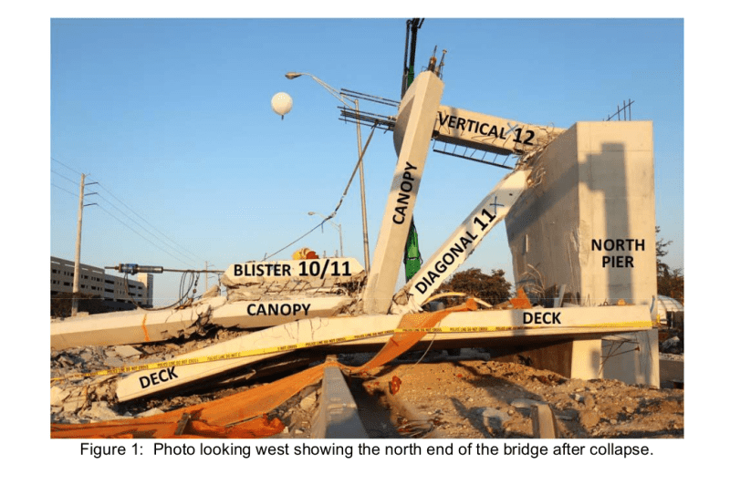

Yes, by the plane of fracture I mean where the 11.12 node left the deck behind on the journey north.
Member 11 would have contacted the south top corner of the north pier or the top of the deck as the structure continued to fall.
The bottom of member 11 would have been damaged already by the PT rod.
The contact with the deck and/or the pier is the most likely cause of the damage to both members 11 and 12.
The impact may have fractured the connection between the canopy and member 11.
Either it is still in position or it has become hinged at the canopy and has fallen back to close to the original angle.

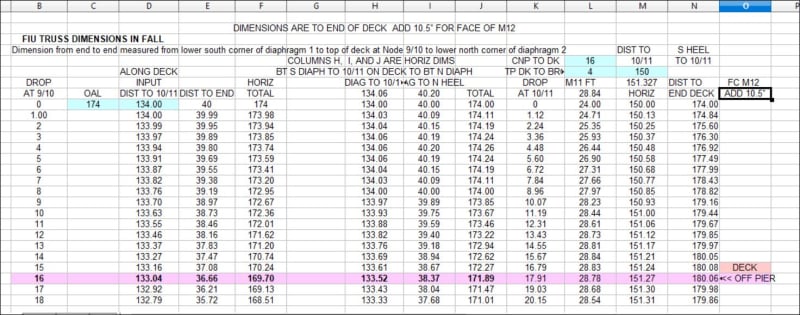

Referring to your spread sheet, when the lower end of member 10 has fallen 4 feet, the north end of the deck has moved 0.26 feet north (a little more than 3 inches).
Vance, will you be so kind as to add a column to your spreadsheet showing the northward travel of the 11/12 node?
Thank you.
It will be interesting to see if you can calculate the interference between member 11 and the corner of the deck.
The point of contact will be almost 4 feet back from the end of member 11 and will have lots of mechanical advantage to do the damage to 11 and 12.
Thanks in advance.
By Your Command, O Great One.
The calc considers rotation about the bottom corner of the south diaphragm and may fudge a bit because it projects drop at 10/11 as a ratio of horizontal distances relative to the drop at 9/10. I do not think that causes a variation that can be disproved by dash cam evidence.
It seems the base of M12 at the top of the deck is forced about 6 feet north before being pulled back.
If there is a need, I can change input lengths easily.
EDIT OOPS!! Column N is final horizontal distance from south corner of Diaphragm 1 to the point on M12 where the top of the deck and the end of the deck coincide. That dimension was used as the distance to Node 11/12. To find the over all length add the 10.5" that M12 extends beyond the end of the deck. The heading on that column incorrectly notes :deck". The deck has literally "gone south".
Drawing B-37 has dimensions of concrete at Node 11/12. Overall 6-4 1/2. The fillet is left behind - about 13" gone there. I am going to deduct the 10.5" projection of M11. That leaves about 4'-4" of construction joint (without the 10.5").
From the spreadsheet the deck is ready to depart the pylon when 9/10 has dropped about 16 feet. At that point the bottom of Node 11/12 has moved north about 6 feet, the separation is about 8 feet. The point where Node 11/12 joint clears the end of the M11 projection (Put the 10.5" back) is about 5'-2". That coincides with a drop of 9 feet at Node 9/10, where the deck likely 'folded'. That assumes the deck extension of 10.5" for M12 is still attached to the deck. So if I did it right M11 clears the deck while the deck is still on the pylon.
I think the deck area under M11 and M12 was sheared free and went north with M11 and M12. And that left a void for M11 to fall into, beginning where the "blowout" started. With M11 at 31 degrees, the 24" dimension becomes about 4 feet measured horizontally, and half the member is 2 feet. So if the break out developed at the mid line of M11 the 5'-6" slide required to clear the deck is reduced by 2' and becomes 3'-6" slide required to fall into the void in the deck. That corresponds to a drop of about 5 feet at Node 9/10 on the deck surface.

Thanks Vance. Nice work.
Am I reading your spread sheet correctly?
Does the 11/12 node move far enough north to drop off the north end of the pier?
Is it possible that there were two drops, one onto the top of the deck, and shortly after a second drop onto the top of the pier as the deck falls away?
Two consecutive drops followed by being dragged back onto the pier after hooking over the end of the pier would explain the damage to the lower ends of member 11 and member 12.
In regards to the action of the lower PT rod.
Has this been explored before I brought it up?
I can't remember seeing it in previous posts.
I see the lower PT rod acting as more than a simple pin.
It was at about a thirty degree angle.
It may have been acting as a wedge and exerting considerable downward force on the lower part of member 11.
Given the angle, the downward force would have been greater than the horizontal force.
This would have provided considerable clamping force to increase the resistance to sliding of the fractured concrete.

I'm almost sure the frames of the video show member 11 separated from collumn 12 early on and member 11 folding at the canopy-member 10 joint, also early?

If there is any credibility to my effort at a spreadsheet and the logic of the geometry, at a drop of 13 feet and more at Node 9/10 the north face of Node 11/12 is hanging beyond the north face of the pylon by maybe 8"(putting the 10.5" back into the picture) to a foot (11-1/2") max then drawn back to the south until the deck hits the roadway and everything stops. I see it as reaching the edge of the pier, extending beyond the edge, but not falling over the edge - in most any condition the remains could have cantilevered a foot or so.
I do not see two drops - it all began with Node 11/12 on and in contact with the surface of the deck.
Member 12 and the canopy it supports total about 50 kips. Member 11 is split and damaged in the last photo taken. It would seem that the weight of M12 would have to be supported by the lower face of M11 as it slid over the edge of the blowout zone. How much moment could M11 resist in the damaged lower section at Node 11/12? Post collapse photos show maybe 4 feet of the bottom end of M11 is gone. Answer - not enough,
apparently.
But - There could have been two drops - or a two step single drop. IF the bottom of the blowout block provided a surface for support - at the top of the 8" pipe sleeve. I have no good dimensions for the remaining surface on which the Node and blowout block could have been supported. Then there would be about a 24" drop to the top of the pylon as a second drop.
I suspect the bending caused by the lower face of M11 going over an edge coupled with the drop to the top of the pylon explains most of the damage to M11 during the collapse.
Early on, perhaps. But at some point it began ripping out the bottom. If it created a normal force because of the wedging it also created an opposite force against the deck surface from below and may have contributed to the cracking experienced as the blowout block failed. But as I recall the deck is not ruptured and remains in place just north of where the PT rod enters the deck.
I concur with your comments about the PT rod in the sleeve and the cracking in the deck. The possible contribution to failure or resistance/support provided is quite difficult to really determine. All told, there was apparently enough capacity at the deck surface to transmit a force sufficient to tear out the "blowout" block of the deck.
EDIT ADD A comment - the geometry and results are sensitive to the location of the break in the canopy and M11 at the top = was the hinge at the Node? Edge of blister? I cannot answer that.
