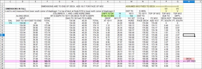

Since we are looking this direction, I added some columns to the spreadsheet for geometry.
I can't tell if M11 failed and shortened or how much it may have shortened. But if the triangle "canopy/M11/M12" was lost, for whatever reason, the location of the top of M12 is influenced by the deck rotation as Node 9/10 drops and by the rotation of the canopy as Node 10/11 drops.
Added column "Q" shows the eepected difference in position due to the mistracking of the geometry - in feet. That difference is accommodated by 1) strength of joints and M12 or 2) cracking in M12 or 3) failing of joint to canopy or deck or both.
