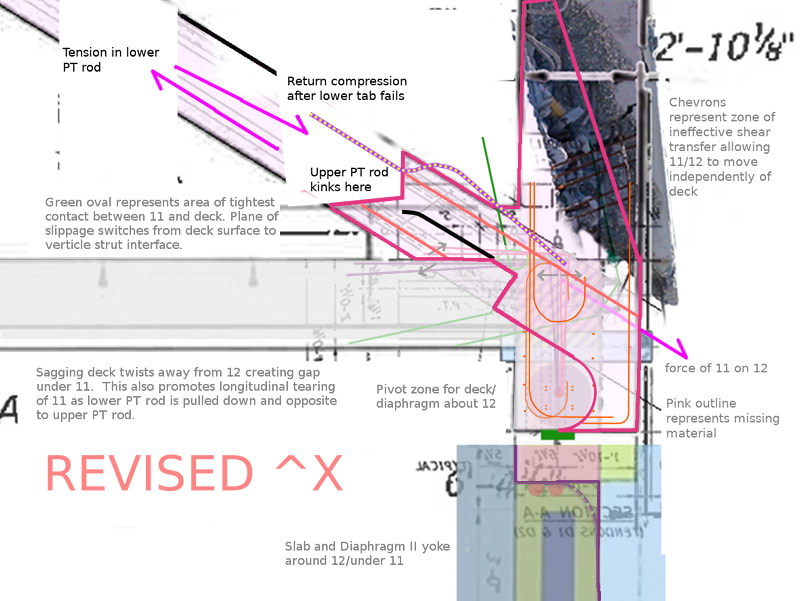

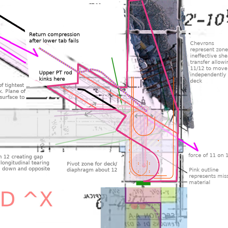

Consider the following as the explanation for the collapse sequence. It's about the split at the bottom of Member 11.
If the lower tab loses its integrity, the upper tab takes the load and kicks out. Member 11 pancakes guided by the lower PT rod. I still contend that the slab rotates the diaphragm off of the bottom of Member 12.
There is a plethora of cracking all throughout the 11/12/diaphragm from a variety of causes but none of those other causes advanced to the extent of collapsing the structure.
Two cracks of significance on the North portion of Member 12, one heavier than the other. The lighter one is at the level of the drain with a horizontal trajectory in keeping with saikee's failure plane.
The heavier one is above the drain and shows some displacement. It seems to follow the trajectory of the upper PT rod and would seem to align with cracking in Member 11.

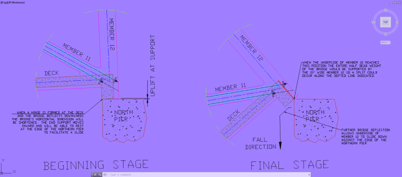

My interpretation of the spliting at bottom of Member 11 is a lot simpler than yours.
Before the collapse the inner vertical face of the 2'-0" thick diaphram beam was flush with the inner face of the North pier. When the bridge started to fall it kinked at 9/10 with the deck and 10/11 with the canopy. Thus 9/10/deck and 10/11/canopy were two hinges and the bridge was no longer a structure but a mechanism.
The deck was well designed and didn't break into pieces but was virtual intact after the fall, right? So during the drop of 9/10/deck to the ground the deck's underside or more precisely the underside of 12 would have uplifted from the bearings and momentarily leaned against the southern edge of the North pier.
If the deck deformed to a "V" shape then the physical distance between the two extremities of the deck had to be shorten. This is just the property of a triangle that the sum of two sides is bigger than the third side. We now know at the Southern end the 1/2 of the bridge was resting on the Southern pier after the failure so if there were longitudinal shortening a relatively small amount would have taken place there. At the North end due to the "V" geometry and the underside of 12 was leaning against the edge of the pier there had to be a sliding action at the pier edge as a result from any reduction in the bridge's overall length. In fact the shortening was at least 2'-0" in order to enable the deck plus the diaphram beam to clear off the Northen pier.
Rather unfortunately Member 12 is 10.5" wider than the width of the diaphram beam so at the precise moment when the diaphram was able to clear the pier and commenced the drop Member 12 would be still caught up at top of the Northern pier because it still had 10.5" for sliding out. To me it was the dropping of the heavy deck that rip out the lower PT rod in Member 11 and assisted in further breaking out the 11/12 connection.
For some reason I can't edit my last post to add the following diagram so I have to post it in a separate thread.
At the beginning of the collapse the 11/12 support would move inwards due to 9/10 formed a hinge resulting the bridge deflected downards and shortened the span. This is indicated by the first sketch showing the diaphram started to lift off from the bearings. At some point the underside of diaphram would be able to lean against the southern edge of the northern pier. The motion from that point onward would be sliding.
When the bridge kept on deflecting there came a time when the diaphram could clear off the northern pier but the Member 12 couldn't because it has an extra 10.5" to go yet. At this moment the half span weight of the bridge would suddenly supported by the 21" wide Member 12 instead previously by the entire length of the diaphram which is 18'-2" long. The support length was abruptly reduced by a factor of 10. Thus Member 12 would split. The deck was able to drop freely down and rip out the lower PT rod in Member 11. I estimate the lower PT rod could have about 3" concrete from the external surface so it is easier to rip it out sideway than breaking in tension the 1.75" diameter PT rod.
Refer to my "cut-and-paste mashup" in Part 12 - MikeW7 (Electrical) 22 Jul 19 03:24. It's crude, but the sequence of events seems to follow what was observed in the truck dash-cam video. Image 2 assumes the 11-12-canopy triangle remained relatively intact after the hinging began, in which case the canopy hinge combined with the rigid 12-canopy "L" section would have forced the 11-12 joint off the deck almost immediately and crushed the lower end of 11 in the pinch point where the lower end of 12 overhangs the deck end.
Refer to my "cut-and-paste mashup" in Part 12 - MikeW7 (Electrical) 22 Jul 19 03:24. said:
[/quote
Your "cut and paste" is pretty descriptive and definitely helpful. I think it needs a bit of scale, and removing M11 in pic 4 may be deceptive in the case of M12. Specifically, pic 4 shows M12 falling behind the pylon. That begs the question how did it climb back atop the pylon? I suggest M11 was still attached to the bottom of M12 and prevented M12 from dropping behind the pylon. There was 4 feet of the top of the pylon available to catch M12 before the deck started sliding south. This could explain some of the damage to M11 and the missing concrete from M11 and M12. It may also have contributed to the bend seen in the upper PT rod of M11. If the concrete near the base of M11 were damaged, either before initiation of collapse or during, and M12 were falling over the end of the deck or pylon with the lower anchor plate of the upper PT rod still embedded, the 35 kips or so DL in M12, supplemented by the force necessary to fail the canopy at Node 10/11, would bend the upper PT rod of M11, resulting in the bend seen in the upper PT rod in photos of M11 leaning on the pylon. There has been discussion of the upper PT rod being bent due to axial compression, but that seems unlikely to me because the upper end of the rod was free to move (it had just been tensioned for a second time) and the rod was not grouted so was not bonded.
The scale of pic 4 shows the structure having dropped maybe 20 feet (top of truss about level with top of pylon) at Node 9/10 while Diaphragm 2 is still on the pylon. The spreadsheet posted here
shows the diaphragm likely slipped off the pylon when Node 9/10 dropped about 11 feet.
The comments of 22 Jul 19 20:46 seem to hold today.
The numbers show that as Node 10/11 passes what was the original elevation of the top of the deck , N10/11 has moved north about 1 foot and the geometry shows diagonal M11 to be about 5 feet longer than the length of the canopy from the top of M12 to Node 10/11. Thus the base of M12 can be pushed about 6 feet northward from its original position. Then as Node 10/11 continues to fall below the top of the pylon it is M11 that restrains M12 and/or drags the bottom of M12 to its final position. M11 experiences a bit of damage in doing so.

MikeW7 (Electrical),
Your postulation assumed the hinge at 9/10 formed first, secondly the 11/12/canopy remained relatively intact and thirdly the rigid canopy “L” would have forced 11/12 joint off the deck.
The weakness in the model are :-
(1) The collapse was initiated by the hinge at 9/100.
(2) There was no joint blowout or a need of it.
(3) The deck finally rest against the northern pier and not flatly on the ground. If this wasn’t the intention the model has no explanation how the deck ended as it did.
(4) The canopy “L” was rigid and able to forced 11/12 out of the deck.
Answer to (1) The design of the bridge resembles to an “I” beam with the canopy as the top flange (in compression) and the deck as the bottom flange (in tension). The diagonal members are the equivalent web. In performing this structural duty the bridge’s neutral axis, where the stress is zero, would be somewhere in the middle of it 18’ height. If for whatever reason the web fails, say by the deck could not hold Member 11/12 in position, the support of the whole bridge would passes to the 2’ thick deck as it is the only bit left resting on the two piers. The second moment of area, which is proportional to the cube of structure height, would then be drastically reduced. The height reduction from 18’ to 2’ would be accompanied by a shockingly high stress increase in the order of 729 times. Clearly the deck had no such resisting ability but to buckle or hinge. Thus between the hinge of the deck and a functional loss of the web the former is less likely. Additionally the whole deck has been uniformly reinforced and post-tensioned by tendons without one part made stronger than the other. If the deck structure fails it should be at the point of maximum bending moment near the mid span and not at the end span.
Answer to (2) It was OSHA who used blow-out 10 times in its report. The importance of a blow-out is that it is sudden and most probably the starting point of a major structural collapse. This blow-out occurred when 11/12 was detaching from the diaphragm.
Answer to (3) I have already explained with sketches how the deck dropped flat onto the ground with my post on 19 Jun 20 12:14. This ties in well with geometry computation mentioned in Vance Wiley (Structural)’s post on 19 Jun 20 18:26.
Answer to (4) Member 12 and the canopy are structurally superfluous to this bridge as it will stand if you chop them off and install the canopy post-tension anchors at the next bay. In fact a standard Warren truss does not have them. The easiest way to appreciate their insignificance is at each node the member forces must hold each other in equilibrium. At the top of 12 there was no opposing member. Neither there was any member on the other side of the canopy to balance whatever axial force inside the canopy. Therefore these two members have no significant internal forces. Structurally top of 12 has to support a portion of the canopy’s dead weight while the canopy provides anchorage for the prestressing tendons, in additional to its function as a weather shield.
The canopy “L” was NOT rigid enough to be able to dislodge 11/12 out of the deck.

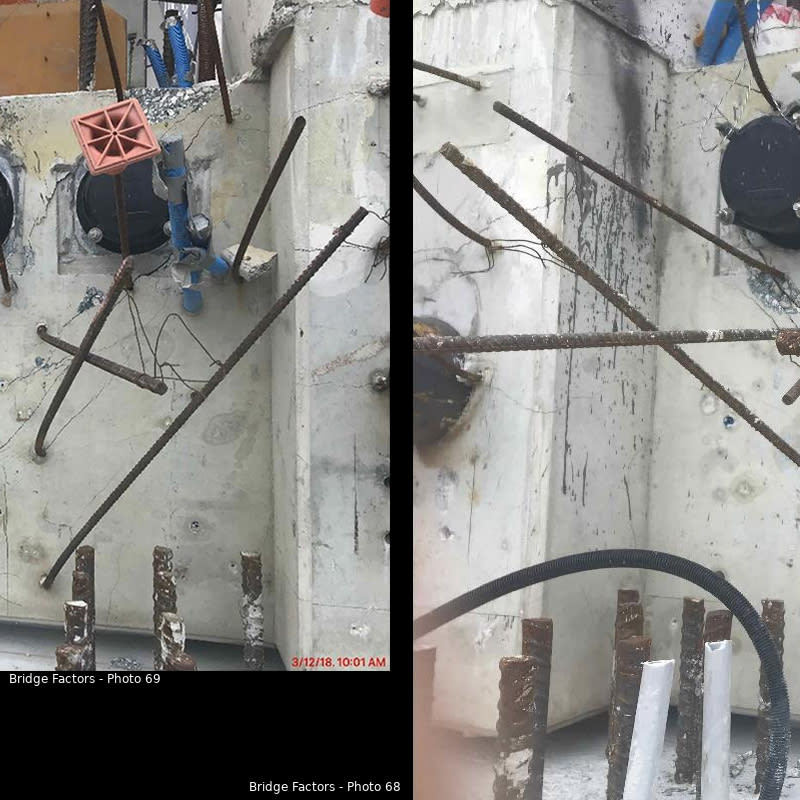

hokie66 (Structural)29 Jun 20 20:48 said:
I am yet to figure our the perspective of that photo.
The same three two blue flex tubes appear in
Sym P. le (Mechanical)17 Jun 20 18:10 said:
(bottom photo)
to the left (ultimately north) of the two white pipes that weakened the diaphragm twelve joint allowing the blowout, (edit) so I think it is a close in wide angle shot.
