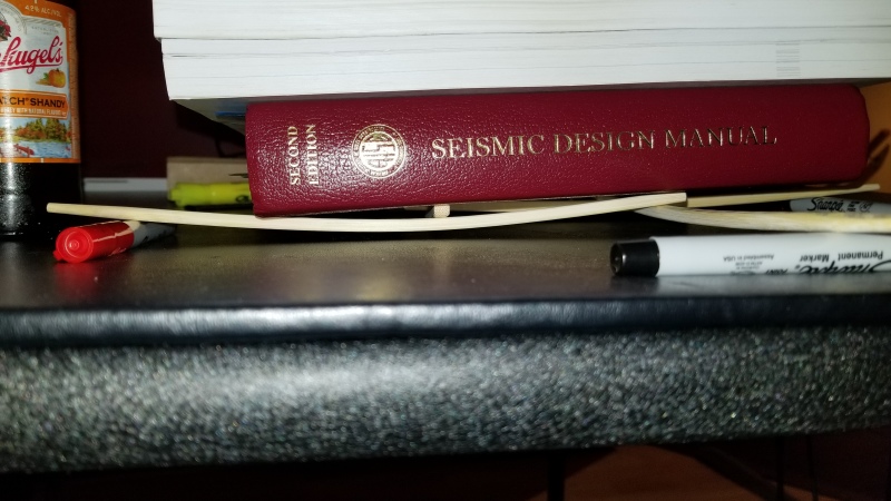

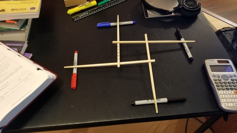

Okay, I fully encourage you to make one of these. I'm amazed how sturdy this is.
I'm now wondering what I can make around the house that utilizes this. Wife said she wanted a trellis arch out back, maybe it should have a reciprocal plane frame in the roof...

A useful way to think of these systems is as two, crossing beams, each constructed in two pieces that are moment spliced in a peculiar fashion
See it TME? It jumps out all over me when I look at your model.
I know, right?! I'm going nuts over this, it's simultaneously really hard to wrap my head around but it's just simple span beams! "Peculiar fashion", indeed.
I'm loving this, if I didn't have stuff I should be doing I'd totally fall down the rabbit hole with avscorreia. Used up too much time already.

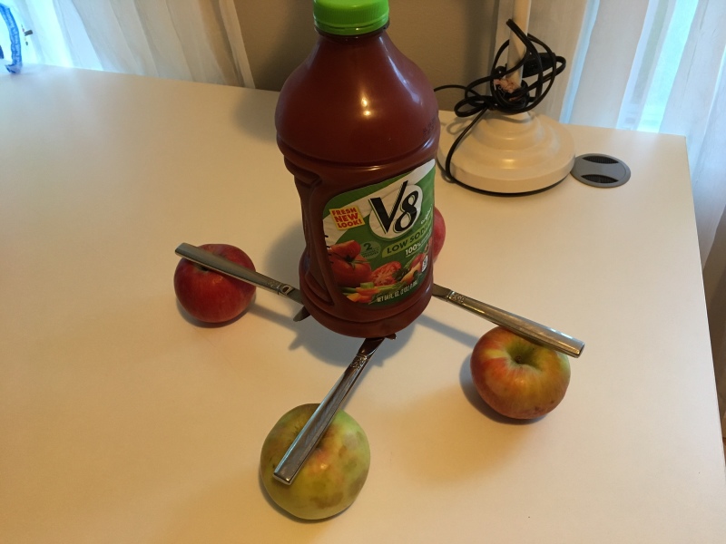

DETstru said:
Independent peer review incoming:
Love it. Would you say that is part of a "balanced" breakfast? [bigsmile]
I'm just now realizing how interesting these are. With the proper bracing (or otherwise connecting the "peak") these frames become diaphragms! They can provide lateral stability as well as vertical.
American Concrete Industries
DETstru:
‘Pear review,’ what the hell do you mean? Those are just plane ol apples. And, V-8, that doesn’t have any peers in it ether, it’s a vegetable juice. I fiddled around with these structures years ago, they can drive you crazy, and become addictive too.
Well I didn't have any pears so... I did my best!
Unfortunately I now only have 3 apples left...

I have no substance to add to this thread, I just love how this topic peaked all our interested and led to these small scale models that showed substantially more capacity than we all intuitively thought should be there. Maybe not all @KootK.
Goes to show always something new to learn/experience in our profession. Comes very timely behind the recent post about confidence in calculations as well and how to get comfy with them. TME wasn't comfortable with the results so threw together a small scale real world replica with material on hand and got "performance" in line with DETstru's RISA model, at least thats what I see in the deflected shape of the chopsticks :).
As an aside TME need a youtube clip of the erection sequence and any shoring that was needed prior to the system being stable.

Well, you better hurry up then, there is a three legged, apple supported, variation of what you guys built. The center opening is a equal sided triangle.
