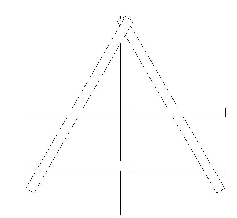

I was looking at the steel quiz in the 10/17 issue of MSC. I was able to pick up the problem quickly as I'm sure others have. However, I had a slightly different answer, I came to the conclusions that the framing plan shown had beams that required themselves for support and therefore would not work. However the article simply states that the configuration is difficult to erect. Is the framing plan shown even structurally stable utilizing simple structural theory?
Also redundancy. The structure is the epitome of non-redundant where failure of one member is guaranteed to result in a catastrophic collapse of the entire reciprocal frame. I'd only do this if it had an architectural feature and was skookum as frig.

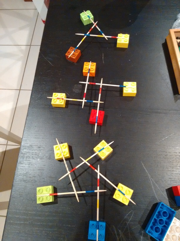

Here are my tests, with 3, 4 and 5 elements.
Now my wife and kids think that I'm a nerd. They're probably right.

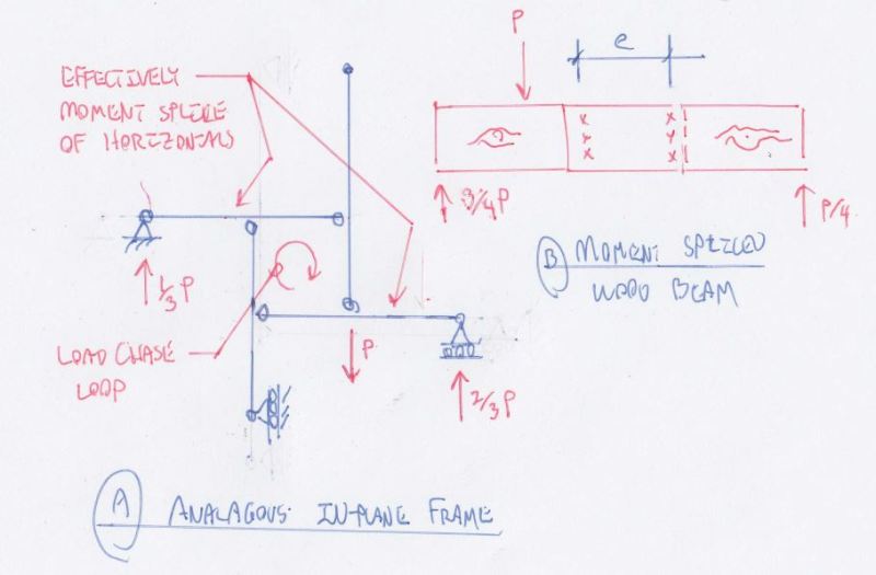

What I find most interesting about this is our physiological reaction to what seems to be effectively little more than linear elastic load distribution in an indeterminate structure (erection / vibration / redundancy excepted). For consideration, I've created what I believe to be an analogous in plane model. Does that raise anybody's stability hackles? I've also compared the system to a moment splice in timber to try and drive home what I believe to be a fundamental characteristic of these things.
In the model below, I've intentionally stripped the boundary conditions down to as few as I believe can be had while keeping the thing stable.
This is pure conjecture but I wonder if we're simply bad at thinking about grillages. Most of us spend most of our time investigating and thinking about in plane models. I did some grillage stuff in college and haven't looked at a grillage of any complexity since.

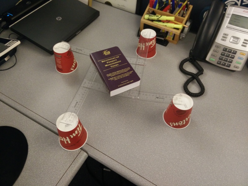

I remember when I was a kid, my Mom doing this with our silverware. It was a puzzle you had to figure out.
You put the four knives flat in the formation we're all familiar with now (support the end of each knife with an upside down cup). Then you put an upside down bowl over the square made by the knives to hide how they interlock.
You show that to someone, then tell them to look away while you disassemble it. See if they can figure out how to assemble it.
