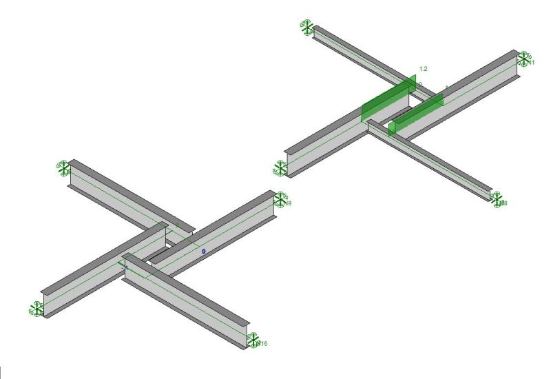

I was looking at the steel quiz in the 10/17 issue of MSC. I was able to pick up the problem quickly as I'm sure others have. However, I had a slightly different answer, I came to the conclusions that the framing plan shown had beams that required themselves for support and therefore would not work. However the article simply states that the configuration is difficult to erect. Is the framing plan shown even structurally stable utilizing simple structural theory?
Are you releasing torsion at the ends connected to other beams? Conventionally you do not to prevent beams from spinning in space but in this case you would.

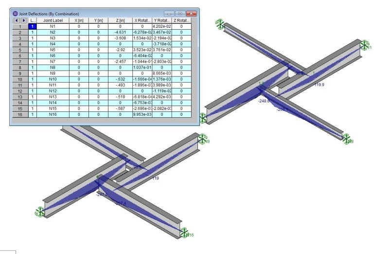

Backing off on the extreme stiffness discrepancy between models, I went to W18x35 and W8x21. Bending and torsion shown below.
I've released torsion at one end of each member which is all I'm allowed to do. Perhaps I need to break up the physical members (RISA speak) into seperate, node to node members in order to introduce more torsional release.

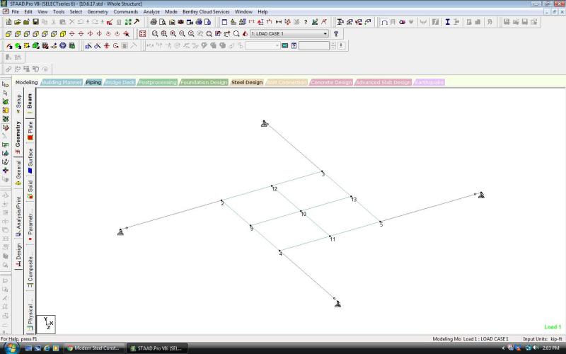

FWIW, I ran it in STAAD with roller supports, found no issues, and beam stiffness didn't affect reactions. So it would appear it is determinate.

Yes! This shows algebraically what I did numerically with the same geometry. I determined the first reaction to be 0.533W but really it's 8W/15, which is an important distinction in this thread. ;) Either way, the reactions are determined without regard to the member properties.

I was thinking about this last night and I thought a good analogy might be a steel plate suspended by cables. (I.e. it would have vertical stability.) Still trying to get my head around the analogy of the plate to the beams.
WARose - not sure I follow?
Not 100% sure I do either. [smile]
Some of the moments goes into the beams (that run to the supports) in the 4 beam model we are talking about.....but in my analogy, all moments are in the plate in the center: Reactions from plate rotation and vertical forces run to the supports via the cables (or T/C only members).
I actually modeled this thing (i.e. a steel plate suspended) in STAAD and got some (stable) results. (And some warnings about instability unless I used fixed supports.) I also had to abandon the cables/truss members suspending it as it became too unstable. I wound up using beams....but released at the supports. (Which is like the 4 beam model.) So not sure about my original analogy.
EDIT/UPDATE: I was able to get the model above to work with the members connecting the plate to the supports designated as truss members by doing a enforced displacement at the plate corners. Sort of forcing the cables to engage (Designating the members as cable and having some initial tension didn't work.) This resulted in minimal instability.
