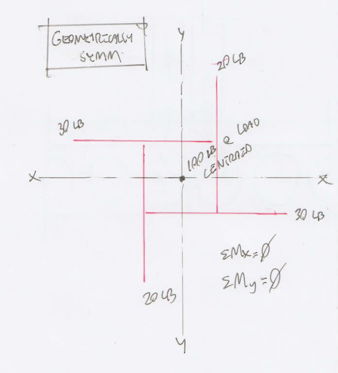

Is the distribution below not valid with unequal reactions and symmetric loading?
In your latest example, the external equilibrium is satisfied but you have not specified how the 100# load gets into the system. If the load is applied uniformly on each beam, i.e. 25# each, I believe the external reactions will be equal by statics. If the load is applied unsymmetrically, say 50# each to B1 and B3 and zero load to B2 and B4, I'm not so sure the external reactions would be equal. It could be determined by statics but my poor old brain doesn't feel like tackling that problem right now.
To take your example a bit further, you could have external reactions of 50# and 0# instead of 30# and 20# which would still satisfy external equilibrium.

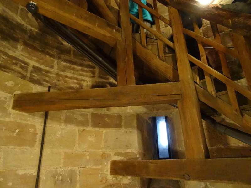

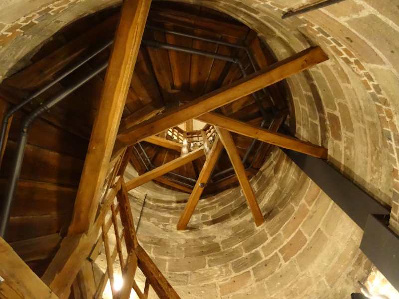

Not sure if this counts as a reciprocal frame or not but here's a cool stair I saw while in Europe.

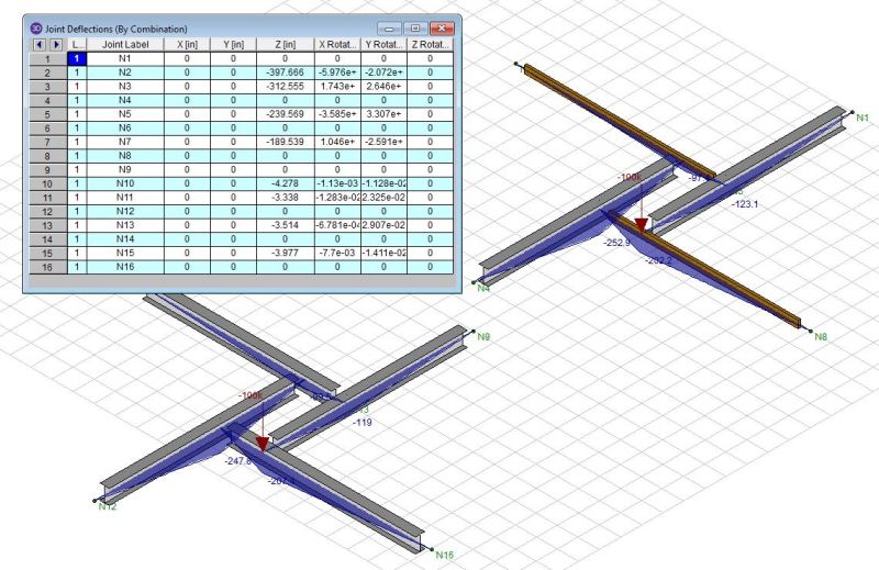

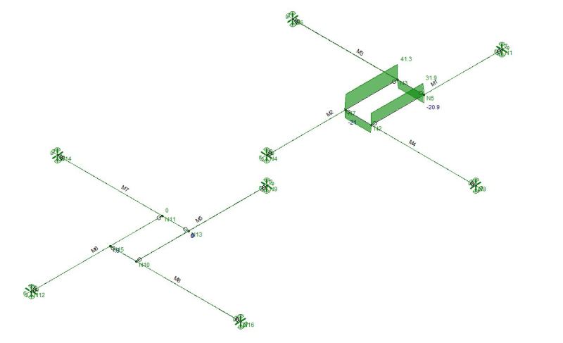

So I decided to do my own modelling. The RISA file is attached for anyone who would like to critique it.
- At run time, I get a program complaint of "Z reactions do not sum to match Z loads". I'd be curious to know if anyone can resolve that as, to some degree, it casts a bit of doubt on the solutions.
- Presumably, because of the runtime error just mentioned, I'm unable to report joint reactions. They can be gotten indirectly via shear diagrams.
- I believe that this test supports the hypothesis that these are statically determinate systems. The response parameters, such as the moments shown below, do shift slightly from one model to the next. However, that's a very slight shift over what is about a 100 fold increase in vertical displacement.
The model's picking up some undesired torsion, particularly the wood version. Anybody know a simple solution to that? Updated model attached.
