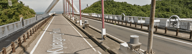

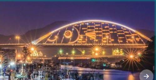

Interestingly it also seems to be used for a light attraction. Weight is probably negligible, but the action of attaching these and then taking them down might cause damage and flexing. There is a bunch of junction boxes at the base of all the cables which indicates use on more than one occasion.
There is also no protection against vehicle impact and again a few reports saying vehicles had run into the cable supports.
Corrosion seems likely. The curb looks like a good spot for water to pool - I don't see any drainage systems, only some caulking around the cable sleeves.
Interesting view here in looking at the right most exposed cable connection of four small bolts with plate stiffeners.
Seems pretty light considering the possible tension forces involved...

That's got to just be a light pole, no? I think the red ones are the cables.
You are probably right...
