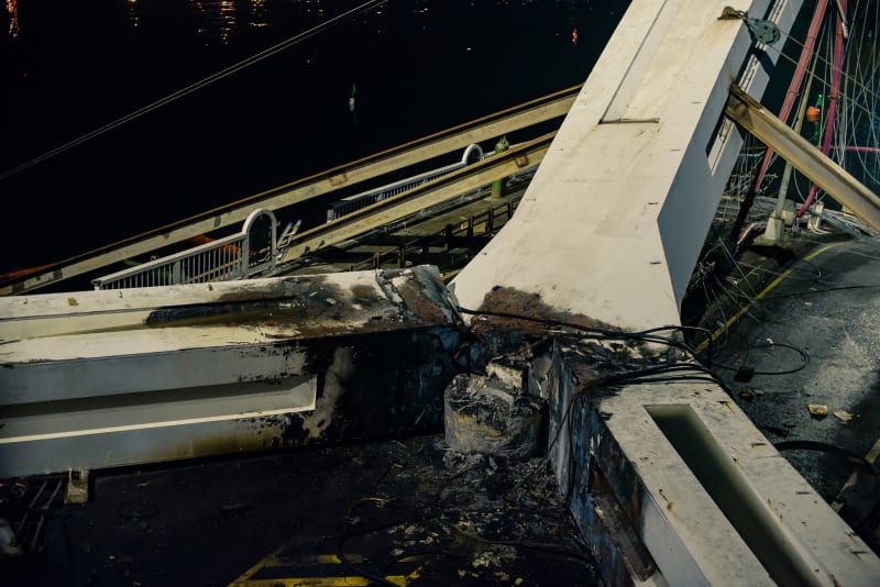

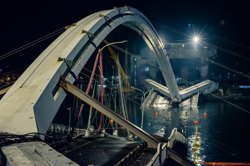

I am in a photography group as a hobby and one of the other members uploaded these iages and gave permission for me to show them here.
So they are copyrighted to Kang Lin.
When it failed it almost looked to me like the two legs of the Y were slotted inside the main arch Y piece and just seam welded on but the main connection was internal by simple gravity / weight of the bridge.
Some construction photos or drawings of how those cables were connected inside the arch would shed a lot of light.
The y-joint may look rusty because of the truck fire.
Oxidation in a fire does that. Most burned cars I've seen look like they have 50 years of rust the day after. As for being roughened it may be a weld joint that was torn apart.
In the Google maps images there weren't rust streaks like normally happens with long term corrosion.
