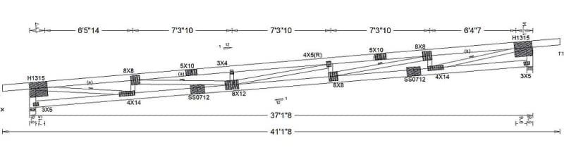

Hello. I’m looking for engineered flat roof wood truss design for a single family home in Nevada.
I know truss manufacturers can provide this, but I don’t want them to design. I would like to get the design drawings independently and then send out to manufacture.
@1503-44 well yes, wind loads are here, but no hurricanes or tornadoes. Shear walls and hold downs are a bigger deal out here though.

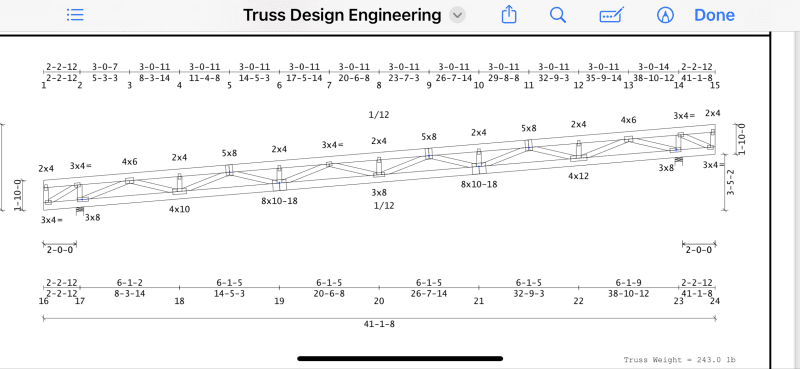

For that design I used 30-10-10 loading, and assumed the truss was 2' O.C.
I don't know what wind load was on it. That usually makes very little difference in a truss design, so I didn't worry about it.
I wanted to once again reinforce what I said about there being no point in taking an engineered design for a truss to a truss plant. The truss might be designed with SPf lumber, and the plant might only carry SYP or DF. It might have Mitek plates on it, and the plant uses Alpine.

Ron, do you check deflections? The chord loads can be made to work. It was always centerline deflection that gave me trouble.
Both truss designs shown above are on the shallow side, imo. Span is 41' less 4' = 37', so span/depth = 37*12/22 = 20.2 which is not enough for my liking, so I would have made them deeper.
Perhaps a compromise about panel point spacing would make sense. The first design has panels that are too short. The second has panels that are too long as well as lacking symmetry.
For a 30-10-10 loading (TCL-TCD-BCD), wind could have a significant effect on the spacing of the continuous lateral bracing, particularly if the BCD load was not in place (which is often the case).
Reducing cost is an important goal, but is not the only consideration. I do not like the shallow angle of the web members in the second design. Six panels instead of five in the second design would be more symmetrical and, with an increase of a couple of inches in depth, is a better design imho.
I'm with you there BA. shallow angles make for lots of tension and shear at the joints. If that can be avoided, so much the better.

BAretired said: "Both truss designs shown above are on the shallow side"
Yes they are. I'm not at all thrilled with them either. But I'm also not building the job.
But - The one posted by the OP wasn't my design. And the one I posted matched the depth.
As I said before - I was only posting it for discussion, to show that more pieces costs more money.
Adding webs and making a truss look pretty doesn't make it work any better.

Truss #1 details the overhangs fully whereas Truss #2 relies on using the top chord cantilever, leaving the rest of the framing to the general contractor. Truss #1 is a working truss without the addition of Continuous Lateral Bracing (CLB). Truss #2 requires four rows of CLB (not sure why it's not five) to be supplied and installed by the general contractor. It should not be a surprise to learn that the cost of Truss #2 is only 80% of Truss #1.
So which is the better design? And who gets the benefit of the reduced cost? Not the Contractor! He has extra material to purchase and install in several awkward locations. Not the EOR! He has to inspect each CLB connection in many hard to access locations. And not the Owner! He is severely limited in the services he can run in the joist space because of restricted clearance. If any CLB is omitted (which is very common) he has an unsafe structure.
You decide! I know which design I prefer.
