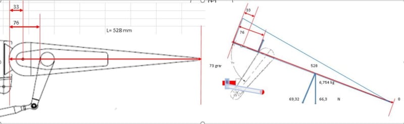

Can anyone help me check if this calculation works so far?
There are so many conversions between different units ..
The calculation is made by a free software but I assume that their calculation models are correct.
My own assumption is that the elevator is heavier at the front edge as there are hinges made of MIL 1430 N and since the lever and its attachment also are , there are also steel details on the other side and the rest is aluminum.
I have chosen to see it as a simple bar to begin with.
And the calculation is made to check which load the fixed joint must withstand for the elevator's own weight.
I intend to present it in steps so if I got something wrong I can adjust it before the next step.
If it's okay with you people?
Best regards Anna

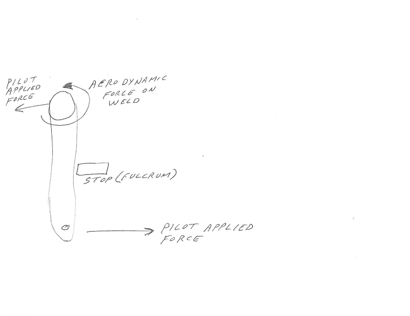

Do I understand that the end stops are on the horn and not on the elevator?
Does this sketch make sense?
If the sketch is valid, then by examining your copies of the pictures of the failure, you may be able to determine the direction that the weld was broken.
I think that it is possible but very unlikely that the pilot could apply enough force to break the weld.
If at any time the plane fell backwards aerodynamics could easily put the horn on the stop and twist the weld off.

Bill it makes sense to me. And I think your correct.
No problem :-)

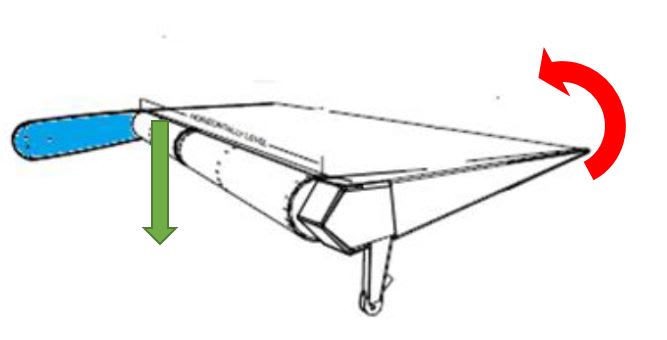

Yes but that is the left side elevator, as you have drawn it.
Might this help.
I am quit shore it wasn't broken by the pilot but att max stop up.
I have been sure of that all the time but it felt easier to start with their calculation and exclude it, but when I do not understand how they made the calculation it becomes hopeless :-( :-)

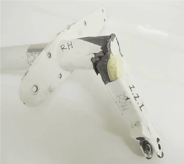

To me that's been broken laterally with the Y connection of the horn going to the ->
In that case your going to get a high shear load at the bottom of the tube weld. Which will very quickly hit fast fracture load (not helped by the crap welding)
Lateral loads like that won't have been even considered because in normal operations its constrained to only move in 1 2D plane.
Do you meen as the green arrow or the red one ?

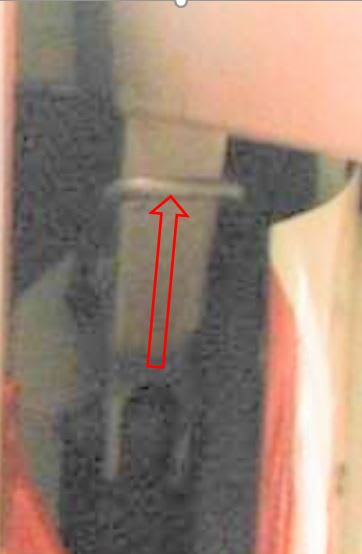

The end of the elevator going vertically up in reference to the plane axis. Putting a moment on the end of the tube and horn.
Decided not enough day light to do it now and finish in one session. And the family are in the house and will just bitch that the power is off
Like this?
What I call against the maximum stopp up.
Best Regards A
Albert Einstein
Yes I agree that it was there the stabilizer ended up, exactly as in the film you linked to.
But I do not agree that it broke in that direction to begin with.
It will take me some thinking ;-) and preparing to be able to explain it properly.
Me and my pictures in my head LOL
Best regards A
Albert Einstein
To me the fracture doesn't look torsional it looks shear initiating on the bottom of the tube with the crap weld then it goes through the virgin metal with pretty standard fast fracture faces.

I think the fracture is as you are saying diffrent in diffrent places.
It might even have been broken in many diffrent directions at diffrent stadges.
When I figured out a good way to show and explain it, I will .. just need some time to put something together...
