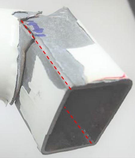

I have to take this in steps and start from the beginning.
I have a bit of a hard time putting together a complete explanation, all at once.
It takes too long ..
And should any of my assumptions be wrong somewhere along the line, everything falls like a house of cards.
In this way, I can reevaluate my theories along the way.
To begin with, the lever for the elevator is made of 2, 90 degree bent cold-rolled sheets approx 1 mm.
That are welded together, in the red-marked corners.
The bad weld is marked between the blue lines.
In the material report, it has been established by X-ray that the weld is just as bad all the way down to the attachment for the push rod on both sides.
The weld defect will reduce the load carrying ability and the stiffness of the elevator operating horn.
This picture bellow is just an example I created to make it easier to explain, so it does not look like this in reality.
But if a square profile like this was fixed at the bottom and you would pull with more force in the right front corner than in the left (see the red arrows) then the profile should be more like a rhomb since the green areas have more stiffness and the week parts are the welded cornes, or?
BE A
Albert Einstein
This sort of problem is suited to finite element analysis.
In my day we all had copies of this 30 years ago.
I would send you my copy but its in the loft in Scotland and no way of getting it.
But these days they wouldn't touch it with Roarks. They would just produce a 3d model of it using pro-engineer or similar and then import it into the FEA. Gone are the days of producing ascii input decks.
The local uni might be willing to give you a student ANSYS license key. I only say ANSYS because that's what I was using. A static linear model will be relatively easy to produce. But if you want to model the failure then you will be into none linear materials and geometry which will very quickly ramp up your hardware and disk requirements. Although these days disk and computer power isn't as limiting as it was in my day.
I have asked a colleague at work if he could set up a simpler model, but I have not bothered him with it anymore though.
I could probably ask for some software from the company's software server, but my boss might be wondering what I would do with it, especially if it costs money.
Would certainly take me an eternity to learn how it works. :-(

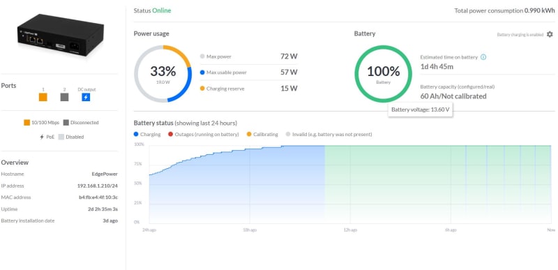

I have been having issues with my computer network in the house after power cuts, so I have reconfigured that and put a UPS 54V power supply in which powers the POE switches for the router and AP's and set up a subnet for all the smart devices. The UPS uses a 12V lead acid battery and takes 3 days to do its charge/discharge calibration Once its finished I will throw the main breaker as we go out the house for a walk to give it a proper test. Its showing 1 day 4 hours with a manual input of 60Ah battery attached which is 3 times the length of our normal power outages.
UPS 54V
Strange voltage level?
How is it that?
Is it 54 VDC in 12 VDC out?

I don't have a clue how the UPS works. Its main plus point was that it could take a 12V lead car battery and has a BMS in it which looks after its charging and discharging.
We used to UPS all the time on the computers when I worked in Engineering. But they were expensive and batteries were a pain. This thing was 100 euro and I used my 18v battery pack fixing welding battery/the ride on lawn cutter needs a jumpstart battery, 12V 60Ah car battery . To be honest a mate who still works in IT is away off to get its big brother for work to try it out.
The two poe switches which run the router with DHCP VPN etc and the AP's between them only pull 20W and one camera which pulls 8w all the rest I don't care it it comes off line. Everything will come back online if the AP's and router are happy in seconds. I have stuck a AP down in the cellar as well with its own SSID and got rid of the ip over powerline wifi extender.
Usually they feel that the incoming voltage falls below a certain level then they plug in the battery and disconnects the mains voltage.
The when the mains voltage is ok vice versa , and the battery is charged as much as needed.
But the ones we have at work is 230VAC in and out or 24 VDC > 24 VDC, fairly common industry standard.
Not for homes though, cost about 300EUR.
But a normal router for home use is normally 230VDC, so do you have a different supply voltage in your house?
My partner used to connect his motorcycle battery to his pellet stove in the winters with just a normal battery charger to the 240 VAC outlet, nothing more, it kept it running during most power outages. And the battery was always okay in the spring when it would be returned to the motorcycle.
But it depends on what your gadgets need for supply voltage.

its 230V single phase plugged in normally but with a 12V wet battery hanging off it. When AC goes down it uses the battery as the energy source.
After a power cut it recharges the battery..
HAs 2 POE AX ports but they are only 100Mps and the network is Giga so I am just going to power the POE giga switches off the 54V output which is normal for them.
Quite impressed with it to be honest
How it turns 12V into 54 V and the other voltages that are required for POE I have no clue. It was pretty much plug in play apart from attaching the battery. Those 54V switch power supplies are not cheap anyway. So I 2 spare of them now to boot. 160 euro including the battery which I use for other things off and on anyway but normally its just sitting there doing nothing is a reasonable enough price.
Okay I had a bit of a hard time understanding this with 54 VDC .. not any ordinary voltage out there.
But you have it for your E... Point routers and switches and not to the whole house?
It seems to me that you have the situation under control :-)
Maybe you should delete/remove that image.
So that I do not hack into your ip address!
Who knows, what damage I could do. ;-)
/Anna
Albert Einstein
yes just want the router and wifi access points to stay up.
54V DC is quite a normal voltage for supplies to decent networking gear.
I have everything wired with cat6 POE+ cable it makes life very easy with IP cameras and control tablets in the wall etc.
