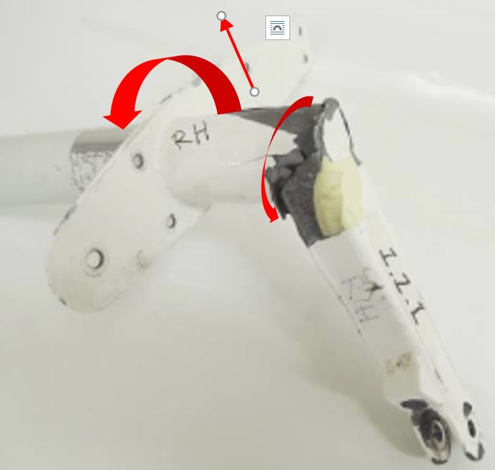

Can you come up with another way to break the elevator horn towards the maximum stop up?
It would need a drag force of more than 5100 N on the elevator surface for it, speed 180 knots.
Other than if the plane falls backwards with the tail down and the elevator out 90 degrees against the direction of fall.
And that would need a fall of 190 m.
Or in a clockwise roll, but then the plane must have rolled at least 7 revolutions / second.
Does not even feel reasonable. ??

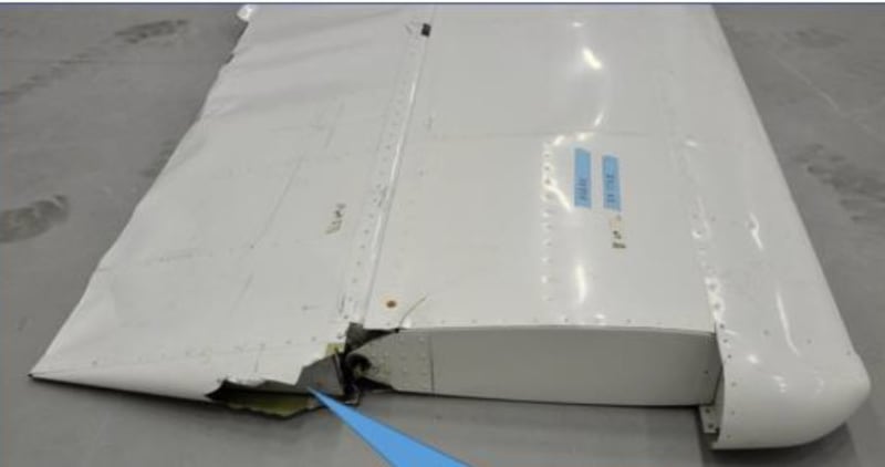

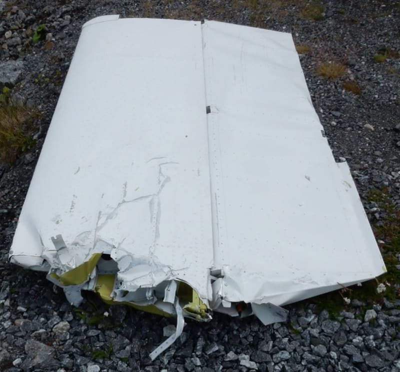

Has this been considered?:
The elevator was ripped from the plane by aerodynamic force.
The remaining attachment was by the horn and linkage.
The horn broke off last.
Was the break in line with the normal force on the horn or was it at random as would be the case if it was the sole remaining link with the aircraft?
That is what SHK claimed in our last conversation, but it is not possible.
Because the stabilizer had been broken loose from behind and forward and then up against the fin.
The wrinkles, dents and braken skin in the front of the vertical stabilizer indicate that the stabilizer had been pushed to the left,
A dent on the top side of the RH elevator together with signs of red coloured steel primer was found close to the indentation. Possible parts having this primer in the close surroundings could only be seen on the upper rudder hinge,
This would not have been physically possible, if the horn haden't been broken of first.

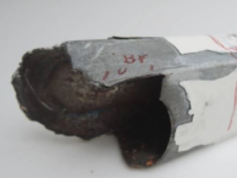

In addition, the material report has come to the following conclusion.
Examination of elevator hinge RH side. Measuring of the elevator travel up and down relative to stabilizer showed: Up :::: 54 °, (allowable limit 15 ° ± 0,5 °). Down :::: 68 °, (allowable limit 19 ° ± 0,5 °).
I have a hard time believing that this would have happened after the stabilizer and the elevator had separated from the plane.
Visual inspection of the corner welds indicated areas of severe lack of fusion in the
longitudinal and the circular part of the weld. This was confirmed using radiographic
examination. LOF is regarded as critical and is normally not accepted in any welding class. The weld defect will reduce the load carrying ability and the stiffness of the elevator
operating horn.
Bad weld
Figure 28. The lack of fusion defect extended more than 10 mm. Effective weld penetration is here reduced to 10 -50 %.
The fracture had started in a weld defect of the corner weld. The fracture mode was overload in tension transverse to the welding direction.
No signs of fatigue were evident.

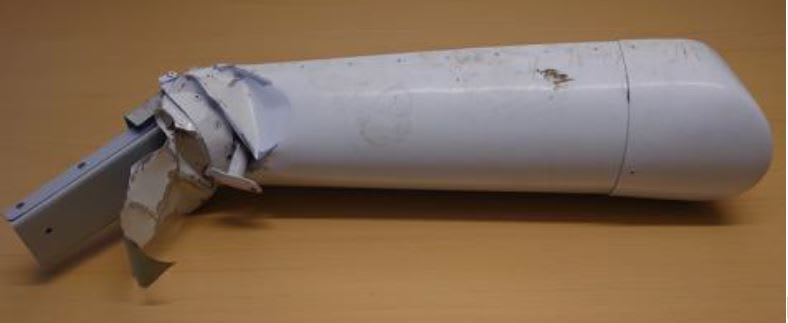

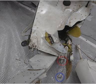

I guess it could have been broken loose by the stabilizer when it started to break up forward, it has a larger surface on which the force can act.
The elevator is more flexible until it ends up against one of the stops.
But the way the balance horn had been torn loose is also very strange.
They did not find it until 4 months after this material report was written.
The balancing weights were mounted in the outer part of the elevator using eight blind rivets. The remaining blind rivet heads on the RH side were examined. It was concluded that none of the blind rivets had failed but the rivet heads had expanded the rivet mounting holes and thus caused the weight to separate. Besides the eight rivets the balancing weight is mounted using a screw in the turning centre. This screw did not fail but it still holds a small part separated balancing weight. No signs of fatigue fracture were visible.
Some force should be needed for that. But it's just the angle that make it feels weird.

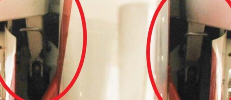

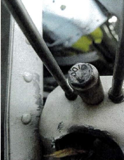

Thank you very much for taking the time to explain this to me Anna.
I appreciate the amount of work and time you put into your reply.I have one other question;
Are there travel stops on the elevator itself, either up or down, or do the stops bear on the horn.
I have looked at the diagrams and pictures but I can't be sure.

The only stopps are on the horn (lever).. The bult is stopp down and the bracket for stopp up, I do not know if it is the right word here so I say stirrup then you know what I mean. ;-)
