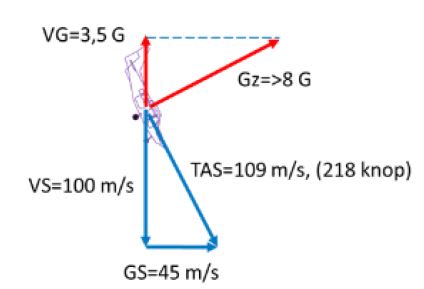

Can you expect 0 G or negative G at a stall or spinn etc. ?
Or as in this picture taken from SHK's report as an expamle on how they reasoned and calculated?

Not so much in a stall but in a spin and recovery you can get everything from negative through to wings fall off positive G.
They haven't taught spinning for years to PPL's or CPL's in Europe because it was killing more people in training than it was saving so they teach them slow flight and sin avoidance.
While your in a spin there is actually very little load on the aircraft because all flight surfaces apart from the rudder are fully stalled. In gliders we used to spin them down through cloud because there was zero chance of you hitting a gust and breaking the wings.
The problem occurs during recovery for a normal spin mode like you have pictured above you remove the power, neutralise the elevator and ailerons and then apply rudder in the opposite direction to the spin. The rotation rate may initially increase and then when you feel pressure on the elevator some types your told to slowly apply forward pressure others you don't. This then un-stalls all the flight surfaces. Now if you have rammed the control forward at the point the elevator un stalls you will get a colossal sudden nose down input which will give you negative G. You now have an aircraft which is pointed directly at the ground +- 15 degs accelerating at 10 m/s/s. You then have to get the nose back to straight and level before your speed goes over Vne. Which requires you to pull back on the controls. Which is usually when people over stress the airframe and the wings come off as you have a picture of.
But that is only one spin mode, there are others depending on how you enter the spin. It can also be what's called inverted so the canopy is the opposite side to the one pictured.

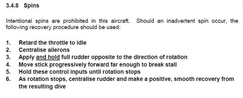

Now I have a bit of a issue, I wanted to post a video of spin instruction in a Cessna 150 and a video of the spin in a piper PA38 which is what I used to teach spinning in. C150 which is the most docile spinner our there away from gliders. And they didn't let it go into a fully developed spin. And the PA38 which is a high rotation handful to get out of a spin. Just a bit concerned it might traumatise you.
I thought that this part of the audio file could possibly show that he followed the spin instruction, but it could also be the governor who regulates the rpm, but that when the plane flattens out, the jumpers come flying from behind and the controls are pushed forward to max. Many but here ...

Right here is a training video in the C150 by a very good instructor in my opinion. The plane is quiet docile and if you can see the Airspeed indicator they get nowhere near Vne. Hieght loss will be about 700 to 1000ft. The lady makes a very good what we call patter of whats going on. BUt she has to cheat to get the plane into a spin by inducing yaw.
This next one is from a PA38 which I used to teach them in. Looks to me like a nicely executed spin number of rotations is controlled and under 3 you can see the initial spin up as rudder goes in. Height loss about 1500f. And he won;t have required rudder input to start it spinning.
This next one if it was a plane out of a school I was instructing at and I was made aware of. I would not be happy with and words would be said. The pilot had roll input to try and flick it into the spin with one wing stalling more completely before the other which made it go flat and they didn't start the recovery as soon as the first rotation had finished or maybe they did but the attempt to flick spin it required more rotations for the rudder to bite. Which delayed the exit and lost alot of altitude in the process. I wouldn't be surprised if they lost 3000ft in that one.
So between those three you can see the differences and the required reaction time to deal with things.

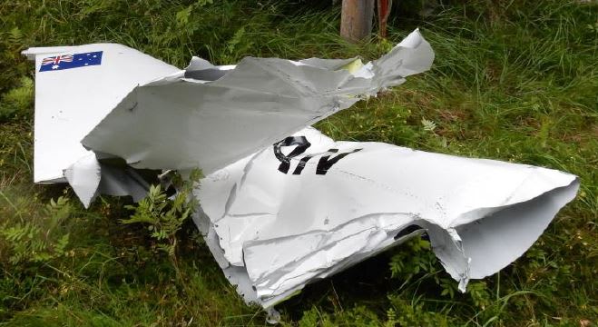

• The aircraft then lands on the right side with a large oblique blow with increased lifting force and increased resistance as a result, which reduces the speed increase and the diving angle.
• The speed increases further, the rodder is overloaded and breaks off.
If this was true, would the rodder then be broken like a V to the right side of the plane ??

Probably, it is at least my picture. It is physically possible.
But what I would like to know is, if it is possible for the fin or side rudder to be broken off to the right side of the plane?
Like his?
If the plane flies on it's right side "that is banking 90 degrees" forward and down like this??
