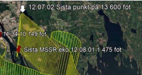

No, right now I just want to see if I can recalculate the ground speed to the planes real speed, the minutes just before there really were any problems.
On the other hand, I wonder if it is the case that the airport's data collection is always based on the plane's transponder data and where the speed comes from the plane?
While the miltaries is based on radar data and therefore only shows ground speed?

I have a problem here, what does direction stand for?
I do not understand how this is connected?
The red arrow i is the approximate direction the plane flew in at 12:06:14., so what does Direction 86 stand for?
Or what have I managed to get wrong here ???
I is from Flightradar24 not from SHK.
Best regards A

What's that from?
What are the headers at the top of the data?
76 / 86 looks more like air speed in knots and then mph?
Meter is my recalculation..The headers are in thread abow..
260 might be when he comes out of the turn before the final ?

There sis two different systems primary radar which works off reflections and secondary radar which works off a lower powered signal triggering a response from the transponder which also contains other data in it.
The mil systems are set up for tracking "targets" with primary radar their sweep is faster and the pump out more power.
Do you know what the QNH was on the day. Over 5000ft in that area all aircraft will be using 1013 as the pressure datum on their altimeters, its so we are all flying on the same setting and ATC can separate us.
The militåry data is both primary orange and secondery black (thread 28 Nov 20 21:12) and i am quit shore they told me it was ground speed from secondary, but I can check again.
It is the flight data from Flightradar24 abowe I am not shore of, if it is ground or actuale speed.
I am not shore they have specified QNH, I guesing that it is pressure from the tower set at take of ??

Flightradar uses another system which is called ADS-B which is a GPS output which doesn't rely on pressure setting. It is notorious for being used when things happen and it having several issues. It only squirts every 5 seconds or so, so is pretty useless for dynamic rapid changing events.
It doesn't matter if its MIL which one they have used they will have the best data and will have cross checked it. Swedish Military is pretty hot and the radar systems are for spotting Russian aircraft and they get plenty of practise. You would be wasting your time going down that route.

In thread 28 Nov 20 21:12 in the time stamp from MIL radar 12:07:22 the altitud is 200 m higher than before and after, but SHK says it is not correct.
That it is a false reading.

Looking at the report and those direction traces you posted there is something not matching in terms of the time traces compared to the accident report. Also I think fight radar data if they don't get a new reading it just repeats the same one. You're better off plotting the co ordinates and then working out the heading rather than using the heading data I think.
One think struck me when looking at the radar trace on figure 18 of the report.
The pilot is maintaining a pretty steady speed and altitude at an air speed of around 80 knots based on a 30 knot head wind which he was more or less heading into.
Then he speeds up a bit to about 87 kts but stays level,
Then the speed dies, but the altitude hardly changes.
Until he gets below stall speed and then banks and turns left and falls down 200m in 4 seconds and a further 200m in the next 4 seconds.
Now why is the crucial question here that we don't have any major clues to.
