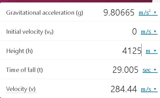

I am just trying to get a correct speed from MIL radar data.
The pilot is maintaining a pretty steady speed and altitude at an air speed of around 80 knots based on a 30 knot head wind which he was more or less heading into. Then he speeds up a bit to about 87 kts but stays level, Then the speed dies, but the altitude hardly changes.
Yes and it is that part before, that I would like recalculate the speeds for ??

Just trying to calculate the correct speed.
One think struck me when looking at the radar trace on figure 18 of the report.
Until he gets below stall speed and then banks and turns left and falls down 200m in 4 seconds and a further 200m in the next 4 seconds.
That is wy I want to know the correct speed.

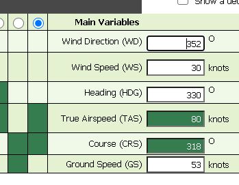

12:06:14 Ground speed =98,35*0,539957=53 knot flight direction 330 deg MIL radardata
Is it heading or course that should be 330 ??
Best regards Anna
Albert Einstein
Heading is the direction the airplane is pointing.
Course is the course over the ground.
So the radar plots course because it has no real information on aircraft heading and doesn't really care which direction the plane is pointing.
So 330 is course.
Heading in this case will be higher because the head wind is coming from the right

So 330 is course Thank you I thought it was but I was not sure.
Heading in this case will be higher because the head wind is coming from the right ??? I would say left??

But if it had been an optimal freefall of something without more information, it is not excluded that it was something from the plane.

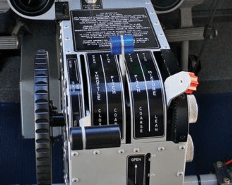

BTWE that picture of the controls is from the GA-8. But yes, they make the levers different so you should be able to do it by feel without looking and I think (please correct me any pilot) that they are always in the same order, a bit like clutch, brake, accelerator on cars. So it's unlikely, but if the pilot was suffering from lack of O2 and just made an error?
I don't really know how you change the RPM of a fixed speed prop but assume it's one of the other levers or dials?
But then the engine data records don't show any sudden decrease of speed or manifold pressure in the final seconds of recording. In fact the last recording is more power / speed until it apparently gets cut off when the no 1 bus is cut out.
It is the blue one.

Yes its the middle lever and will be a cross shape, mixture is on the right and is always a multi point star shape.
