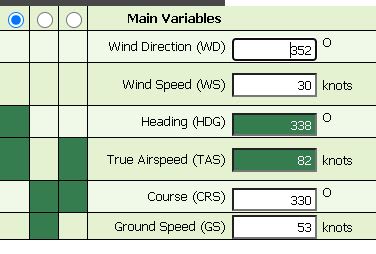

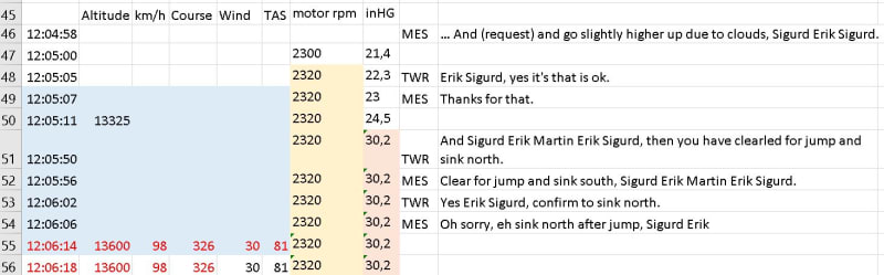

These are the recalculations SHK did for speed.
But they have not shown any figures.
QNH3 1014 hPa, Flight level 136 - wind, 352 degrees, 30 knots, temperature -10 ° C
GS → correction for wind = TAS → correction for standard atmosphere = CAS → correction for position error = IAS.
This the one I made.
How big a difference can there be between TAS and IAS?
And is the following correct?
Best regard Anna
Quite a significant one. This is not about measurement error; TAS and IAS measure fundamentally different things.
True Air speed is genuinely a measure of how fast you are travelling through the air.
Indicated Air Speed is something else altogether, though loosely (and predictably) related to speed. IAS is actually a measure of the aerodynamic forces being generated on a vehicle as it moves through the air. You measure the difference between local atmospheric pressure (detected in nicely protected and hopefully unpainted static ports on the side of the aircraft) and stagnation pressure (detected at the bottom of a hole pointing straight into the airflow - typically on the end of a "pitot" probe stuck far enough out the front to see into clean air), then express that pressure difference in terms of the true airspeed that would give the same pressure difference if you were flying at sea level in an International Standard Atmosphere.
Sounds weird - but it's easy to measure and so many important things (drag, stall points, structural loads.....) vary with True Air Speed, Altitude and Temperature in very much the same way that IAS does that, for all purposes except navigation, it's the most useful (on small aircraft, often the only) "speed" indication in the cockpit.
Assuming that the -10C is a ground temperature, then 82 Kt TAS is going to work out at around 70 KIAS. If it was -10C at altitude, you're looking at more like 66 KIAS (See
