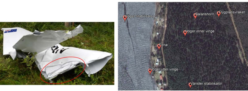

If you look at the picture of the rudder, is it possible that the damage occurred in what is described in these two statements?
That's my only question right now.

To me that looks like the base of the rudder was attached to a different load structure and when the fin came off there was a fraction of a second while the fin travel sideways until the pivot point sheared off the bottom which bent the rudder out to the side.
There may be something either lost in translation here (literally) or it's not possible based on only two bullet points to figure out what they are talking about.
But as a guess are they meaning the plane was falling sideways in a slip / bank or that they think that the plane is falling in a dive, but at an angle?
Or falling like your picture from four posts above but basically right wing down and falling sideways / vertically down the page.
But 100% sure?? That is just not possible. IMHO. Sorry.

The fin / side rudder has been broken / demolished by the right stabilizer which has been broken loose from behind and forwards and then broken up against the fin and the side rudder.
This has also been confirmed by phone by SHK (not so easy to understand when reading the final report) and in the material survey report.
This has been stated there because the upper hinge on the side rudder is the only part of the plane that had a red base color, which is imprinted on the right stabilizer. On the rest of the plane, the base color is yellow.
My comment below.
It could have been the other way around, but both the fold up at the bottom of the fin and how it has become cracked like a V contradicts this and also the placement of the aircraft parts on the ground.
The location of the right outer wing is not confirmed in this image. According to SHK, everything else is correct.
Fena = Fin, Balanshorn = Counter wheigt, Höger =Right, Vänster = Left, Yttre = Outer

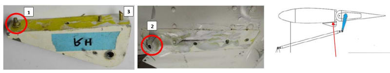

This is something I wrote and sent to SHK six months ago .. Before the final report came.
In the picture below the right rear bracket and its attachment, you can clearly see that the front bolt 1 was "lever" and released last.
What's a little puzzling is that it looks like it's been moving forward at the same time.
This can be seen in the fact that the holder 2 for the front bolt is pulled forward instead of straight up or to the right as it should have done in your scenario
Figure 46. Sequence of the breaks of the stabilizer and fin
and also that the rear bolt 3 is worn obliquely forward .
The only scenario I have found that explains this is that the entire stabilizer has been pushed up and forward at the same time.
