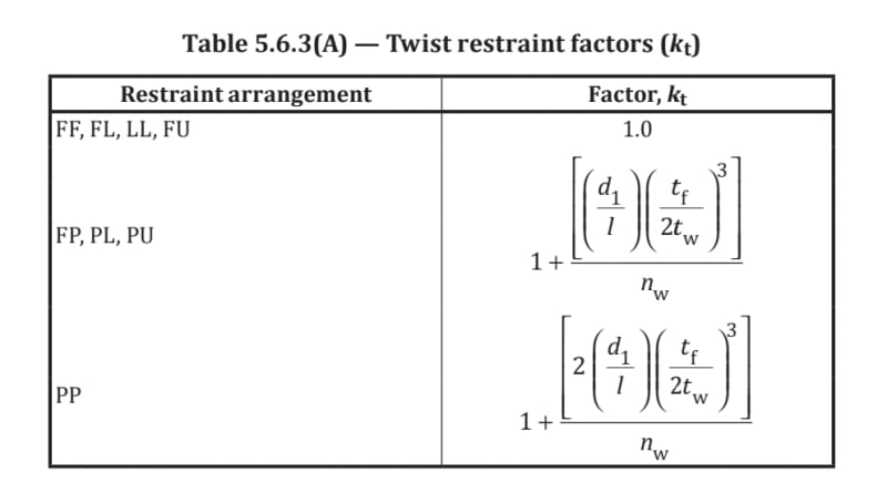

Here's the Australian/NZ treatment. The effective length is increased by the factor k_t (twist factor). n_w = number of webs. FP means only one end has btm restraint w/o stiffeners. PP means both ends. Australian engineers wouldn't think twice for stiffened because it's in the code itself as restrained.

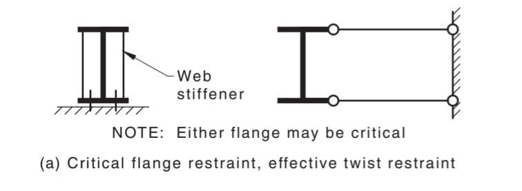

Human, I meant the case illustrated in the standard where the beam with stiffened web sits on something decent, compared to a web cleat also connected to something decent. If the column is as stiff as a pile of jelly as seems to be the case here, stiffened web vs web cleat isn't going to make a difference.

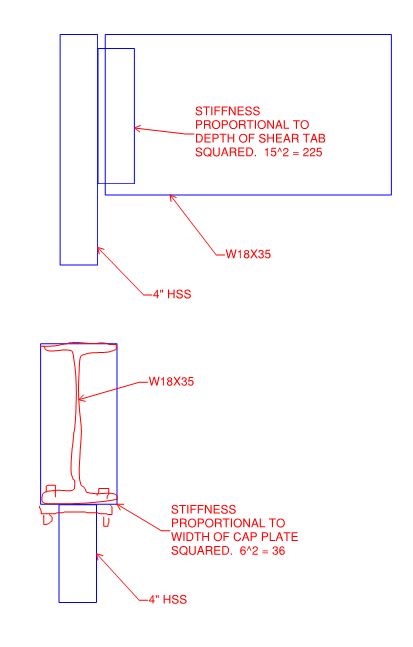

1) I stand by my argument that the stiffness of the connection will be roughly proportional to the square of the connection depth. This isn't the same as truly knowing the stiffnesses, of course, but it's still math damn it.
2) The depth of precedent for simple shear connections being able to successfully restrain beam end rotation is truly significant. Most infill beams, in fact, derive their rotational end restraint from simple shear connections that are only required to be 0.6d or whatever. In contrast, the AISC manual dedicates no less than four pages of details describing how one ought to go about stabilizing beam over column connections. Why does AISC give that issue so much air time? Because beam over column has inherent stability issues.
3) Human909 previously made a point that a) I feel is significant and b) we've kind of glossed over for the most part. Connection stiffness issues aside, a shear tab actually reduces the beams very tendency to roll over by shifting upwards the location at which the reaction is delivered into the beam, at least to the shear center.
My example of a W18x35 on an HSS4x4 is quite common place in light frame construction where posts have to get buried in narrow stud walls. Whenever I see it, I think to myself "now there's somebody who may have overestimated the reasonable range of applicability of that detail. That would have been better done as a shear tab". Perhaps I'm alone in that.

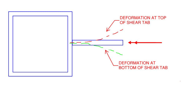

Sure, see the sketch below. Plane sections not remaining plane and all that jazz...

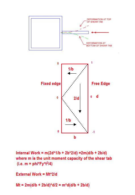

It would be good to see some experimental results (or FE model) of the relative torsional stiffnesses of each type of connection, and the degree to which each will restrain torsional buckling.
The factored strength of a 6"x3x1/4" shear tab with applied torsion is calculated below. Stiffness cannot be calculated using yield line theory.
The fixed edge and the two black dashed lines are assumed to be yield lines. The free edge is assumed to remain straight with zero moment. Relative deflection of +1 and -1 at top and bottom right hand corners are labeled on the sketch.
For a 6" x 3" x 1/4" with Fy = 50,000psi,
m = phi*Fy*t^2/4 = 0.9*50,000*0.25^2/4 = 703"#/"
Mt(factored) = m*d(d/b + 2b/d) = 703*6(6/3 + 6/6) = 12,656"# or about 1.05'k
