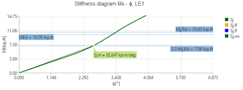

So in this example, the beam on top of the column with stiffeners would be more stiff for torsion than the beam connected to the column with a shear tab if I understand the results correctly. I have found this slide from a Idea-StatiCa tutorial indicating several variants of a connection with their respective Sji.
Does anyone have a ressource to learn more on how to interpret such stiffness diagrams in more detail?

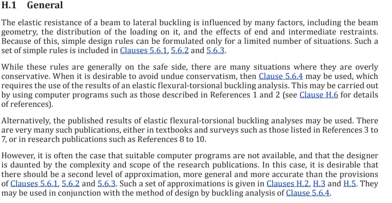

In terms of AS4100's LTB rules, I suspect you're expecting too much from such simple rules. This is from the code itself:
You did computer buckling analysis, which is one of the AS4100 approaches. I suspect the other engineer is relying on published bucking analysis results - also part of the AS4100 toolkit.
Appendix H has some guidance on torsion restraint stiffness, but it's still only an approximation as per the H.1 comments (and the approx equal sign in equations of section H5.1).
