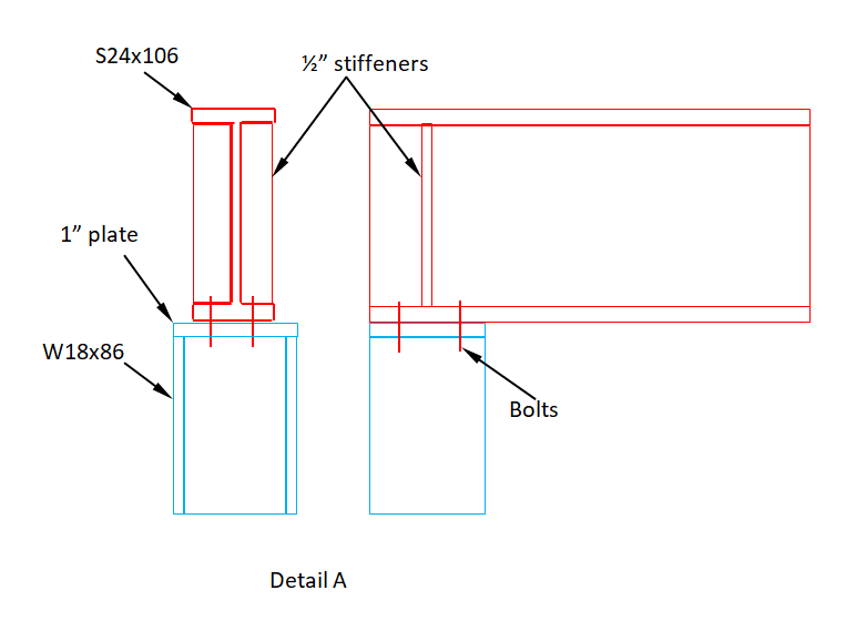

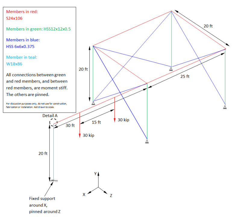

To answer the demand for more details, here is another example of a beam over a column, with more detail this time, that I sketched in case anyone would be interested to perform FEA. Note: I sketched this quickly and did not calculate the members yet.
W18x86 huh? That's darn near a shear wall. Just kidding, the height of this is about twice what I'd originally envisioned and I see that the load to that post has at least tripled. And the column kind of is doing the job of a shear wall here.
I suggest extending the column up, losing the bolts and stiffeners, and connecting the beam to the column web.
I agree, of course, but what's informed your decision to recommend that detailing now that the situation's a bit different than we had originally imagined?
KootK,
It just makes sense with the current members, whereas it didn't make sense with the previous members, or did it?
Actually, extending the HSS column and connecting the beam to the column was probably a better detail in the previous case as well, perhaps with something a little stiffer than a shear tab.

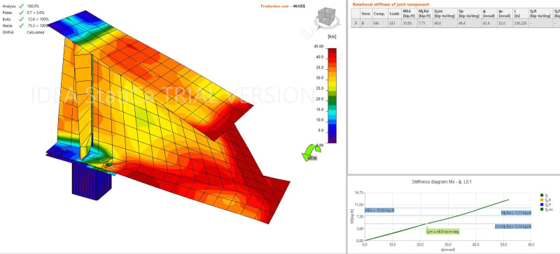

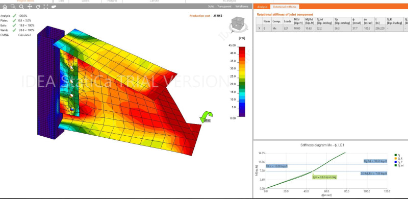

Here are some quick Idea StatiCa results:
Column is HSS4x4x1/4
Beam is W18x35
Cap plate is 1/2" thick with 3/4"Ø bolts on 3.5"x7" pattern. Stiffeners are 3/8" thick centered on column
Shear tab is 1/4" thick (5) 3/4"Ø bolts at 3" O.C. Beam is 1/2" from column, shear tab is 4" wide with bolt line 2-1/2 from column face.
10 kip-ft of torsion is applied to beam.
Nice, I get so jealous of you guys with idea statica to play with. So what are the early stage stiffness? I'm afraid that my eyes are no longer good enough to read the graphs.
Yeah, I didn't realize the picture would come in so poorly. Let me fix that - see attached pdf.
I'm actually using a trial version at the moment and am very new to the program, I figured this would be some good practice - hopefully I will be able to convince my employer it is worth the money.
 https://files.engineering.com/getfile.aspx?folder=67b0f910-5abb-4211-9193-0d14d53bc551&file=Rotational_Stiffness.pdf
So 32 kip-in/deg for the shear plate and 48 kip-in/deg for the cap plate.
In both cases, most of the flexibility appears to be coming from the warping of the beam end itself. Would it be a simple matter to shorten the beam element significantly or to add side plates to dial down the warping?
Although perhaps the dominance of the warping suggests that both solutions are good enough to force the governing LTB buckling mode to effectively reelect that of rotational restraint at each end.
Also, would it be possible to model an incoming shear of, say, 25% of the beam shear capacity coincident with the torque? I feel that may be important to the stability picture with this and that one of two things will happen to the cap plate connection:
1) P-Delta effects will, effectively, soften the connection or:
2) Joint prestressing will stiffen the connection.
One of those...

I change my mind actually: I'd like to see the warping and beam length as it is but with the 25% capacity shear add.
Does IdeaStatica let you have more column length if you want? I wonder if the rotation at the column top would affect the effective joint stiffness at all (P-Delta).
Nice results. I assumed the cleat would be a lot softer in torsion compared to the stiffened seat.
As Kootk notes most of the flexibility is coming from the beam itself. Any chance of modelling the connection stiffness more directly, Eg by using a tube like Kootk suggest?
That could be compared to the support stiffness vs buckling load results in Steveh49’s paper.
I wonder whether the column torsion stiffness is also relevant. The bottom flange of the beam appears to be ~fully restrained against plan rotation in the current cap plate configuration whereas the web cleat allows it to warp opposite the top flange.
Is 1/4" web cleat the dominant size in practice? Could 5/16" (like 8mm common in Aust) be used without raising eyebrows? It's probably something like cubed sensitivity.
