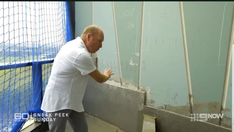

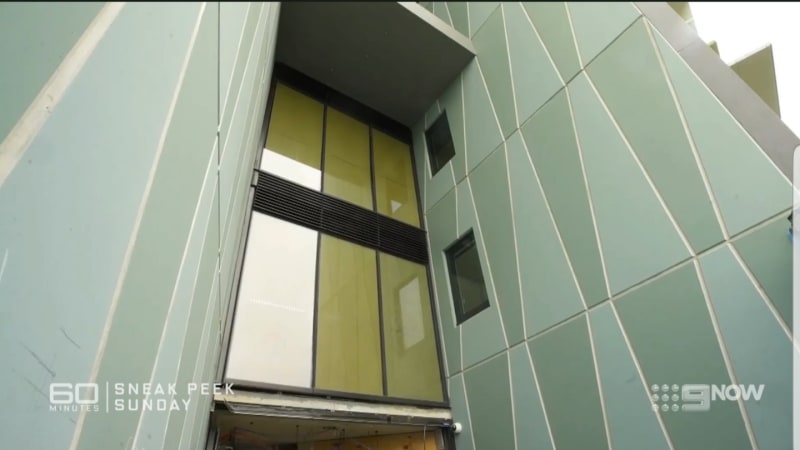

Statement from WSP regarding the repairs and reoccupancy. Link
This suggests they are concentrating only on strengthening/repairing 3 wall locations on each of levels 4, 10 & 16.
Interesting, that looks like a simple surface patch to replace the spalling concrete. Wonder how they strengthened it, and/or addressed the underlying design issues.
I was in all honesty imagining something completely different would be required if they were addressing what I'd see as the obvious issue/deficiency in the original detailing based on the observed damage. An apparent surface patch hardly addresses the apparent lack of confinement. Obviously no one has officially said what they think the apparent design errors were, so hard to say if this type of repair would address the underlying design and construction issues.
Agent666, yes it's definitely confusing especially considering the level of damage we've seen in photo's and videos.

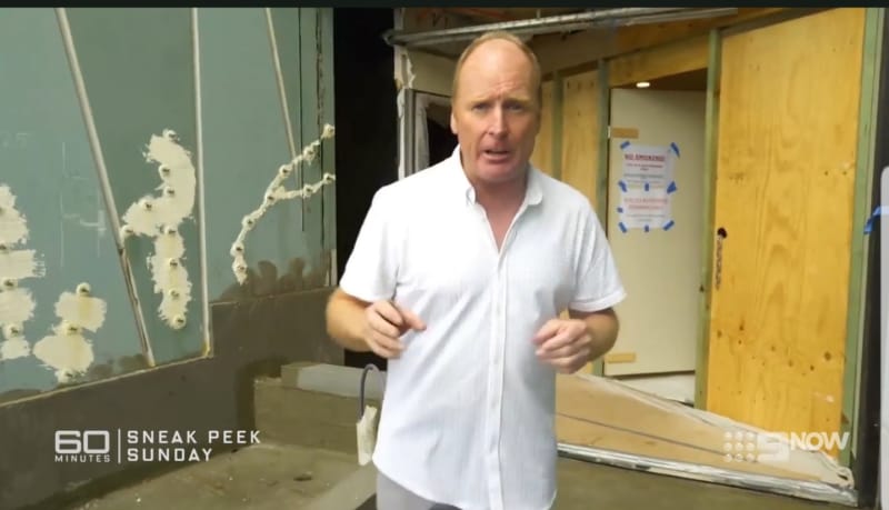

If they’re building a new wall to bypass the hob junction wouldn’t they not bother strenghthening the cracked hob?

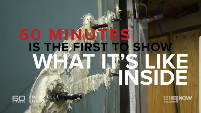

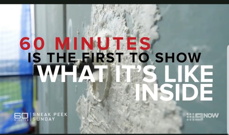

Have they used some kind of structural epoxy adhesive injected into the cracks?
I wonder what they found about the reo in all the other panels. Apparently there’s a “concrete scanning” service that uses ground penetrating radar (GPR) technology to locate reinforcement. Not sure whether the equipment can size them or not.
mango tree, it definitely looks like an epoxy it would be interesting to know if they are using it to strengthen or repair the panels. And it'd good to know what they're doing on the other side of the panelled wall. Hopefully we'll see more on Sunday night.

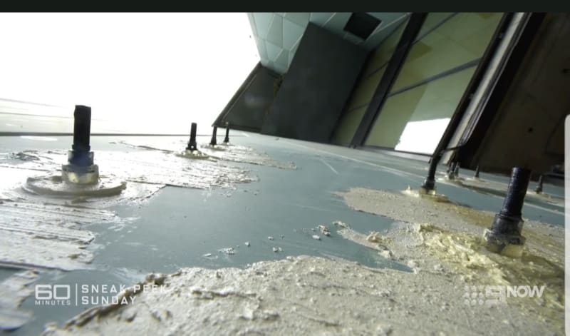

Took some screen captures of the 60 minute video, you can see the other side of the hob beam and you can see they have repaired a slab crack with something again looks like an epoxy.
Injecting all those cracks is not getting to the root cause of the distress. If the problem is with inadequate reinforcement, they are just pushing water uphill. Will be interesting to see further reports.
Yeah, it looks like they're just repairing the cracks, I was expecting some kind of permanent column supports would be installed on the inside of the panel wall, taking some load off the wall and hob beam.
These superficial repairs could just be part of the preliminary stabilising works vs being part of the final remedial to address any shortfalls in design or construction. Though its finished off so nicely at the base that it seems like that's it for the outside at the bottom apart from reinstating the waterproofing.
I would have thought that their would have been some further comments by the university professors by now if they are getting into the repairs, as the public still has no idea what the design issues are, that they are being effectively handled, etc. Yet a considerable portion of the tower has been opened up for reoccupancy based on WSP/Icon/Cardno agreement.

The professors issued an interim report, but it basically said nothing technical apart from raising more questions to a curious engineer reading it with a view to finding out what the root causes were.

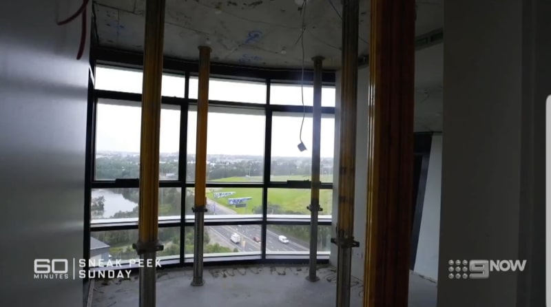

As others have said, the explanation that seems to come out of the interim report is the suggestion that people moving in caused the overload resulting the damage and failures observed. I find it interesting that something that clearly had capacity issues, with possibly less than normal serviceability loads can have some propping added and the people involved are saying its all structurally sound and no worries so people can move back in while repairs are being undertaken (maybe they are advising they don't take their furniture back, just in case!...[ponder]).
I have a hard time believing that there are not more design issues throughout the structure than the areas that failed, but I'm a cynic. Too many years of doing peer reviews to know where there's one mistake, that there are generally more if you go looking.

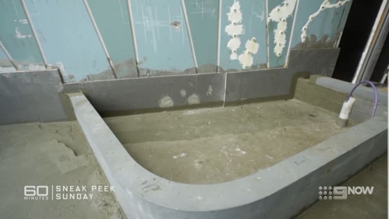

Current Affair is running a special this week, supposedly construction videos, it'll be sensationalised but the images will be interesting.

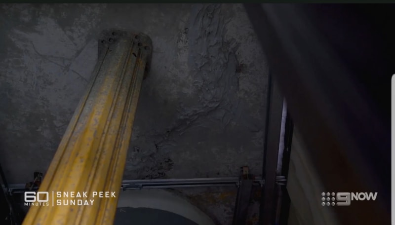

The ACA preview footage looked interesting. Spalling columns and lots of slab soffit cracks.
Columns shown in the ACA preview look like the result of concrete getting behind the plastic liner inside a formatube (or similar form system).
