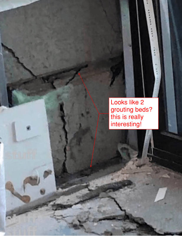

That last picture would appear to show a near vertical crack in the wall. Not a compression crushing failure. The base of the wall at the floor appears to be intact as does the "grout" bed.
RE the review, there would appear to be several consultants involved as well as the Government appointed Deans from UNSW and Uni of Newcastle. From what I understand, WSP, Cardno and Rinkovitch are representing different groups as well as Kajima's own people.

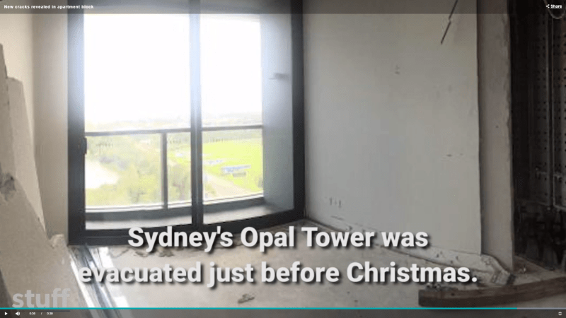

I pieced this photo together from the NZ Stuff video. There is more going on than Agent 666's screen grab shows.
Keeps changing.
So it is not a wall according to that photo, it is an upturned beam! And it looks like a flexure-shear crack/failure. And it is right through the depth. You can see another much finer crack at the top right hand corner.
I thought it was some sort of fold in the slab, so that garden is below the units.
To me that seems like the window, the wall and the slab shown in this image (LEVEL 10, APT1005). The covering (?tiles?) and the planter box have been removed. The focus of the image is the top of the SQUARE column previously mentioned and the precast panel. My thoughts anyway. But it could be in a completely different area given we have no context.
Link
EDIT1: It also readily explains the 45degree cracking from what could be a steel shim between the wall and the column. This goes back to what rscassar conjectured earlier. The wall is offset on the square column, which is unideal but given the desire for clean architectural lines in the gardens it is understandable.
EDIT2: Added a picture to make it clearer what I'm suggesting. (Thicknesses of slab/wall and dimensions of column relying completely on rscassar's previous post.)
Link
EDIT3. I've gutted this post as I misconstrued the context of the photo. I believe ShearForce's post below is more accurate.

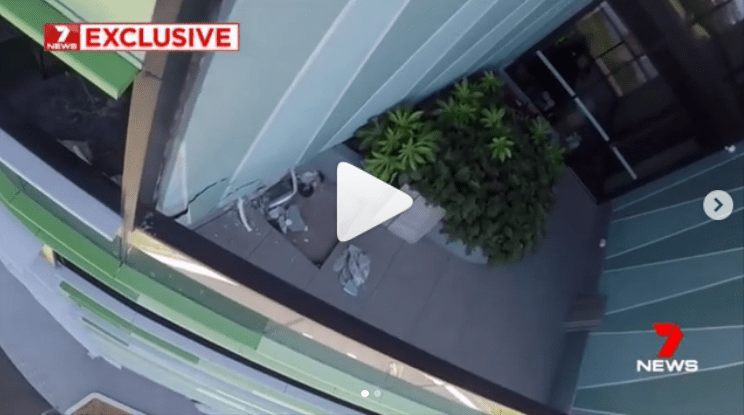

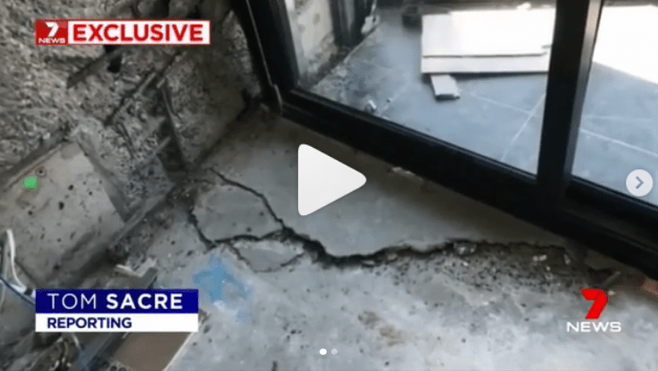

A couple of screenshots taken from a Seven News video from two days ago.
No context on the location.
The image has been taken with a drone.

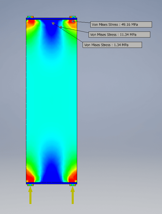

Am i correct in reading the latest photo as a vertical crack in the wall over the centre of the column? If so, it would appear that a tensile force existed in the base of the wall due to the rectification of the dispersed column force into the wider wall. This force would be say 10% of the axial compression and enough to crack the wall. It appears to have cracked the slab also. If the wall had only minimal horizontal reinforcement the yield would occur until to crack was long enough to have enough bars to contain the crack growth.
This L10 panel should have additional horizontal reinforcement. The panels above need not. The panels would otherwise be the same. Any chance of a mixup?
This photo really makes things very interesting.

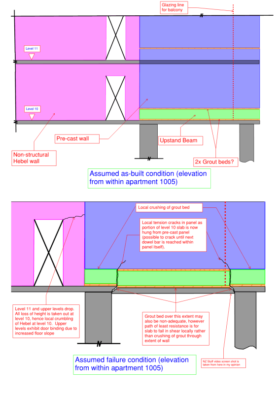

I believe this photo is taken just inside the balcony at apartment 1005 (level 10). It is the blind side to the image I showed (from the garden side) on an earlier post of mine. It definitely looks like a beam of sorts, but there appears to be two joint locations (possible 2 grouting beds) which would mean this beam may also be pre-cast of sorts(?)
The shear failure in the slab makes sense considering the following sequence of possible events:
1. Local failure occurs at the wall/grout immediately above the supporting columns under which is the point of most significant stress as pointed out by Human909's diagram earlier, which I'll re-produce here (I'm sticking to my theory of in-sufficient grout but for those playing at home who don't like blame to be given to the contractor this could equally be due to under-designed wall thickness or under-specified grout and/or wall grade from the design engineer!!).
2. Once local failure occurs over the support columns, load then wants to transfer itself, via bending, to the upstand beam and slab system (mind you both of which would not have been designed as transfer elements considering their small depth in comparison to apparent applied load).
3. The up-stand beam and slab however can not go into bending because of the significantly stiff wall above, therefore everything is taken out in shear at the critical failure planes some distance away from the internal faces of the support columns below.
4. The upstand and slab system can not take the shear load so they fail, in shear. Local shear failure would then mean that a portion of the level 10 slab at this location is now "hung" from the support wall above.
5. By this time, the wall has failed enough to increase its bearing contact area with critical surface of the up-stand beam, this is either through closing up of grout voids and/or blasting off enough of the base of the wall to be rid of the chamfer you often find at the base of panels to prevent cracking/chipping in transit, thus increasing its contact area.
6. Local failure of the wall means all levels above drop by however much distance the wall/grout crushed. This explains the Hebel destruction at level 10 immediately adjacent and reports of doors sticking in their doorjambs on levels above.
I think you are spot on with the location. In fact your own photo posted earlier gives context.
This is the same position just before they cleaned the area up properly exposed the beam and wall. It looks a fair bit different but note the same angles in the slab cracking.

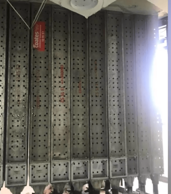

Also going over some of the other photos. From what I can see they have engaged in floor to ceiling continuous propping in the floors below level 10 along grid line 20. Propping here makes sense but until I started piecing together the available pictures of the props this had been less clear.

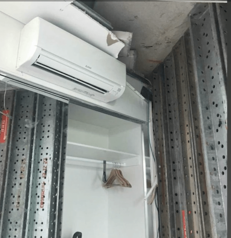

I just thought I'd add a few pictures and what I believe is the context.
Floor plans Levels 5-9
I believe this is showing the bedroom 1, in apartment 3 on one of the floors 5-9. They seemed to have smashed through the Hebel wall separating apartment 3 from 4 to install continuous propping along grid line 20.
Bedroom 1, apartment 4, floors 5-9. (facing built in wardrobe and props going through Hebel wall)
Bedroom 1 apartment 4, floors 5-9. (facing window)
Sheer force eng, in the photo the grout bed appears the same thickness on both sides of the crack.

A great diagram showing what has happened!
The interesting point is the crack in the lintel beam in vertical indicating a tensile crack. A true shear crack would be on an angle. The drop in the floor is a secondary effect.
The fact that is has tension suggests that the grout and shear connection has not failed. Otherwise the precast beam would just move in.
The fact that there is a single crack rather than spaced smaller cracks suggests it has less than 1% reo or it is not adequately anchored.
We must be looking at different cracks!
