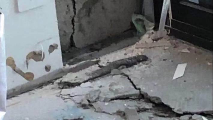

Another photo of damage to walls and floor that hasn't been posted yet (sourced from local news site). Appears to be some good punching shear / shear type of failure in the floor.
That was my thought when I first saw it. And the wall crack seems to line up with it.
Would be nice to know what the structure below it looks like.
Hopefully we will find out eventually.

Wow. If there are punching shear issues then this is far more serious than anything reported.
And 200thk precast panels with 20 floors on top is pretty thin - and slender.
Similar to wall/columns, punching shear in 3600 is pretty vague, and again I've personally seen engineers outright ignore it because they don't "believe" in punching.

Punching shear is a guess from the shape of the crack and what looks like significant vertical separation. We simply do not know enough. Another suggestion was prestress anchorage failure, but I doubt that it would damage the wall like that or that it would happen 6 months or more + construction time after stressing.

Punching failure. good grief, that would be scary.
May have been initiated by the wall panel failure first.
- A 200thk panel bearing over a 1040mm length (700mm column + 2*0.85*200mm for dispersion thru the slab) = 4,050kN @ 80MPa.
- Working load at the time of failure 30sq.m x 7.5kPa x 23 floors = 5,175kN
If the wall underwent cracking to widen the bearing area then instead of going direct to the column it went thru the slab and cause the punching failure.

You give the capacity of the wall over the column as 4050kN. This presumably includes a phi of 0.6. This is a safety factor and shouldn’t be considered in assessing an actual failure. Similarly the 5% eccentricity is a contingency but probably doesn’t actually exist with a symmetric floor load and high axial load from above.
The wall may be overloaded from a code point of view but failure shouldn’t be expected.
Degenn,
Agree. When assessing actual failure we need to look at actual expected capacity and actual loads, not code reduced capacities and code loading.
