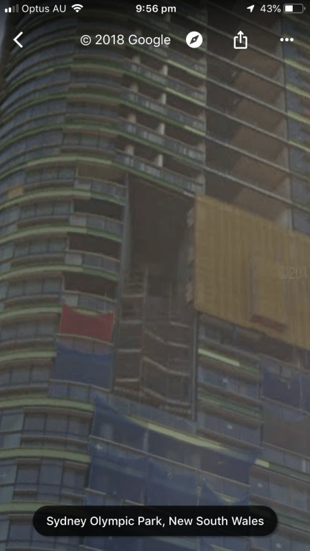

This could be an interesting and developing story in Sydney Australia. A 34 storey near new residential apartment tower in Sydney has been evacuated this afternoon over fears it is in structural distress with cracking noises heard during the day and one or more cracks developing; emergency services are treating it as a major incident.
Given we already have some of the toughest building codes in the world (although little to no registration requirements for engineers) it will be interesting to see how this plays out and what the crack(s) looks like to cause such a major emergency response.

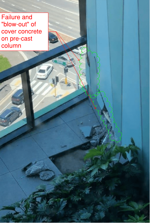

Local Column/wall failure has occurred due to insufficient grouting within the grout-bed interface between pre-cast element (wall/column) and in-situ element (beam/slab)
Here is some further explanation:
- Reports have confirmed pre-cast has been used
- Witnesses have indicated that there has been loud bangs/explosion and cracking sounds, even heard from neighbouring building. In my experience with this form of failure, it is brittle, sudden and very loud (if you have ever witnessed a high strength concrete cylinder core test to failure you will get some kind of idea on a smaller scale).
- Reports have now come out that the pre-cast wall/column itself is not to blame
- The images indicate that the cover concrete has "blown out" from the side of the column. This is the first thing to go as it is not confined by any reinforcement or ligatures. This form of failure doesn't mean that the column itself is no good, but rather the column has been over-stressed locally due to reduced contact area where grouting has not made full contact with entire column cross-sectional area.
- Reports saying that the building is "structurally sound" gives a glowing appraisal or the building itself and may be somewhat misleading, however would be technically correct as after local failure and crumbling of the base of the column occurs the contact area actually starts to increase and the grout-bed connection approaches full contact bearing area.
- However after the above has occurred, you end up with anywhere from 5mm to 20mm of "settlement" meaning that every floor above which that column supports will drop the same amount. This would explain the crumbling of the adjacent hebel wall at the level in question. This would also confirm reports that doors have binded in their door frames and some residents required police services to break them out of their apartments.
- Grouting of columns is generally not inspected by the building surveyor or the design engineer, you are leaving it up to the contractor (more specifically the subbie) to get this element right.
- This is frequently the most common "structural failure" I see in the industry at the moment as you rarely get much else go wrong, to be clear our construction industry is of high quality, is robust and we are more advanced than most first world countries. However this particular failure mechanism has been around for over a decade and actually leaves me scratching my head as to why this hasn't been rectified or the approach changed to mitigate risk.
- This has not been in the media previously as the failures I have seen occurred during construction and was able to be rectified while the public are none the wiser. Unfortunately on this occasion, while the grout connection may have been poor, perhaps not poor enough to cause failure under structural self-weight only but required service load to tip it over the edge.
- This is not a local state construction issue, I have reviewed projects where this has occurred in Melbourne, Adelaide and NSW.

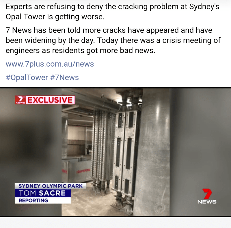

Channel 7 news just showed large quantities of propping being installed behind plywood privacy hoarding, with apparently more propping being brought in from overseas. They had quite a few pallets of props there already.

Here's a screenshot of the propping from the channel 7 video.

- Photos show that local failure at the wall base has occurred, but not total failure of the wall itself, I believe a design error (i.e. under-sizing of the wall strength or thickness) would mean the wall would have continued failing rather than crumbling until a point of larger contact area was reached.
- An error in design would be picked up by now during these investigations noting that there is also a third party engaged by the developer checking the design. If a design error existed in this local area a couple of days should be enough to spot check this. The potential poor grouting issue is not readily detectable and in fact if my theory is correct they may never find out as the failure has now occurred and full bearing is now achieved, we may never know weather there was adequate grouting or not unless another lightly loaded column (that hasn't failed) is found and investigated to have poor grouting undertaken on it. This is the reason why the engineers, builder and developer are scratching their heads and sadly not able to give the residents the answers they need in my opinion.
- Playing the averages, in all the constructed failures I have been involved with investigating approximately 15% are design related with the remainder being a mixture of workmanship/materials or a structure being loaded beyond what it had been designed for with its intended use.

WSPs statement today:
Guy Templeton, President and Chief Executive Officer of WSP, Australia & New Zealand says, “We have found no other areas of damage to the extent of that in one part of level 10. There are fewer than 20 parts of the building with a similar configuration to the connection between pre-fabricated and in-situ poured concrete that was damaged on Level 10. Two of these areas, both on level four, show evidence of some but lesser damage.”
As a precautionary measure, propping is being installed to support level four and this will be completed by Icon Co by the end of today.
The building is structurally sound overall.
