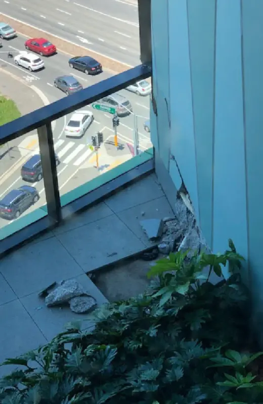

Another photo. Presumably the same level, same location but above a different column from the previously seen photo.
I suspect designers didn’t twig to the localised stresses. Maybe they assumed the transfer slab would carry it as UDL?
Presumably they’re now working out how it’s the precasters fault for inducing high localised stresses.

This is the only photo I have seen of real concrete damage, though the diagonal nature of the crack is not good. I don't think these are precast walls. It is hard to tell from construction photos. The "garden" walls rise after the core but in advance of the columns before the flat slab is finally poured.
I believe it has been reliably established that these are precast walls.

The second photo which looks more damning with the large segments of precast walls crumbling looks like its the level 10 skygarden looking down onto Brushbox Street where it turns onto Bennelong Hwy which is on Gridline 6 and adjacent to apartment 1009. So if the as-built scheme is similar to the DA scheme, there should be circular RC column sitting behind those walls and those panels might have been detailed as non-loadbearing (but became load bearing with whatever happen, also the RC column may have been VE'd out of the design). Also the chunks of concrete that have popped of seem largely unreinforced so the panels may only have a single layer of reinforcement.
