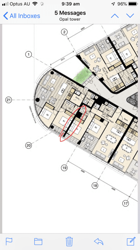

This image is from Google maps. It clearly shows the wall at L10 is load bearing with no column as shown in the DA plan. The wall is sitting on the L9 column with a limited bearing area.
The wall above L10 is supported appears supported on 3 columns, so is statically indeterminate. Depending on relative stiffnesses (including creep and shrinkage) the actual load at this transfer may not be what simple load takedown may indicate. It would be useful to know if all three go directly to the foundation or there are additional transfers.
I count only two on the architectural plan. There appears to be a third column at the intersection of Grid lines 20 and 2 but the panels doesn't extend this far. The entry and internal wall is here. My interpretation anyway, I'm open to here others.
tomfh said:
I wonder if the transfer slab and precast walls form a very deep beam (as opposed to precast walls *supported on* transfer beam), and the wall failure at the columns is effectively a web bearing failure, which the wall panels may not have been designed for.
Well you could consider it a deep beam if you wanted, it wouldn't be 'wrong'. It is just a designation that helps one apply appropriate analysis. But in this case I don't think describing the slab/wall as a beam is particularly useful. The key loads are mostly vertical compression loads on the wall, moment is minor in comparison.
Also calling the slab a transfer beam would imply that the slab has been designed provide stiffness in bending to the vertical loads imposed by the walls/columns. I don't think this has been done as you would need a significantly deeper slab to be stiff enough to carry the weight of 20 floor above. Instead, I am assuming that the design and analysis treatment of the slab is simply to support the bearing load of the wall/columns. That is my interpretations.
A corollary of this is that the wall is essentially only bearing on two points. These points being the ones above the columns. These points are also where the visible damage has been seen to have occured. ie, concentrated stress at two points along the wall.

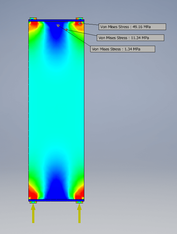

A quick rough and ready FEA of the wall to column-slab-wall behaviour and stress distribution. (Not loads are arbitrary, what matters is the distribution.)
(Note the above assumes perfect and continuous attachment between the slab and the wall. This is a generous approach and certainly not conservative. But even with this approach the stress concentrations are obvious. More realistic modelling of would result in even higher stress concentrations.)

@human909
Great image. What's the bet that the total G & Q load is applied to the transfer as a UDL, and that the wall is simply designed for the same UDL stress distribution? Not many would be doing that sort of FEA analysis..
QSINN said:
@human909
Great image.
Thanks! I appreciate that. It only took me a few minutes. But it just puts a visual to what I was trying to say in words.
IMO, any engineer that considers the transfer as a UDL is failing in their task badly. It could never be a UDL or anything close to that due to varying stiffnesses. You could avoid FEA by considering the bearing forces through the slab as a 45degree flow which is how some pile cap analysis is approached. As far as what most would do. I am the ignorant one here. My direct experience in concrete design is pretty minimal. All that said it would not shock me if that is exactly what has happened.
Just forget the calculations and ask yourself does that wall look appropriately wide compared to the column widths above and below it?
My gut says that a skinny wall supporting some fat columns doesn't add up!

This plan of level 3 shows what looks like 3 supporting columns below the grid 20 wall.
It is statically indeterminate how these three will share the load.
That isn't a plan of level 3 is is a plan of level 5-9. Zoom in on the image and it says 5004 and 5005.
Also the wall you are calling is not a precast structural wall as far as I am aware. It is an internal wall and presumable not structural. (
I've seen the only precast walls have been adjacent to the garden openings.

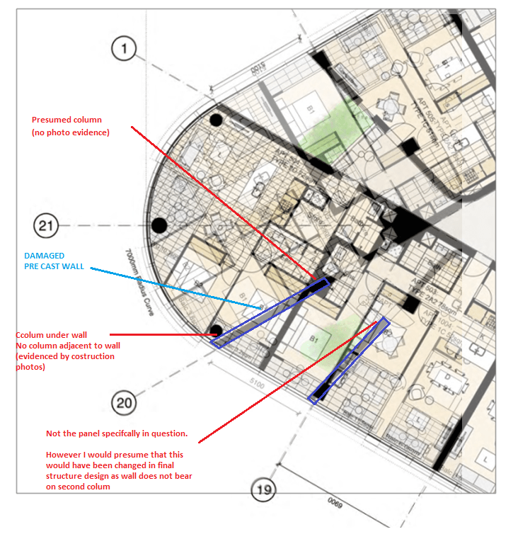

Here is an overlay of level 9 and level 10, it shows TWO columns underneath a 6m wall. (3 columns over 6 meters would be highly problematic for practical floor layouts)
Also note the discrepancy in the wall opposite to the one which we know has cracked. I would presume that final structurals would have meant a longer precast wall and moving the apartment entrance to the opposite side of the column.
