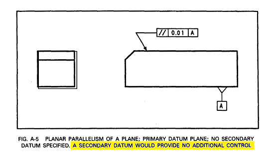

What are the opinions on the following schemes?
1. Angularity control referencing 2 datums in the FCF, when the basic angle is specified between the controlled face and the secondary datum. The primary and the secondary datums are perpendicular to each other.
2. Parallelism control referencing 2 datums in the FCF, when the controlled face is nominally parallel to the secondary datum and perpendicular to the primary datum.
3. Perpendicularity control referencing 2 datums in the FCF, when the controlled feature is nominally perpendicular to the secondary datum and at some other angle to the primary datum.
I haven't seen any of these brought as an example in the Y14.5 standard (unless I'm missing one), or in any other sources I was exposed to, but I also don't see how the contents of chapter 6 may reject those schemes. Schemes #1 and #2 are ones I wanted to implement for real cases, but hesitated (eventually I did :)). As for #3, I haven't encountered a case requiring this, but I can imagine one. I think I once heard a GD&T professional say that there should always be a basic implied 90° angle (for perpendicularity), or a basic angle of some other value (for angularity) between the controlled feature and the primary datum feature whereas the secondary datum may only constrain DOF / orient the tolerance zone. But, if the DRF should first and foremost reflect the functional interface, there certainly may be cases where a vice-versa scheme is justified. The problem is - there are no figures to point to if such position needs to be supported. In Y14.5, looking for orientation controls that reference more than one datum, I find only figures 6-4, 6-8, and even 6-17, all show an implied right angle relationship or basic angle between the controlled feature and the primary datum reference, never to the secondary.
Has anyone else dealt with this dilemma? Maybe it's only my lack of knowledge / experience, and such schemes are either commonly practiced or clearly not supported? Whatever the case is your input will be very much appreciated.

The reference for parallelism is the datum plane, not the datum feature. That makes sense for the control since we want the controlled feature to be parallel to the face that should contact datum feature B. Yes, the fact that it is only contacted on 2 points by the secondary datum feature simulator makes the relationship between the datum feature and the datum less tight, but that does not reduce the meaning of "parallelism" the way it should be understood in this case.
In addition, if datum feature B is sufficiently validated for perpendicularity wrt datum A (like it's usually done in these cases), the relationship between datum feature B and the controlled face will not end up being "far from parallelism" if the parallelism as shown in the sketch will be within tolerance.
However, I accept the fact that it can be said that the "main" relationship required by the FCF shown is perpendicularity.
Parallelism to 2 datums can actually control both parallelism and perpendiculariy (or other angular relationship) of the controlled face to the datum references. The door was opened by fig. 6-4. Perpendiculariy or parallelism are not "pure" in a sense of controlling only 0°/90° relationships to the DRF.

No, it cannot. The standard is very clear, you always specify orientation wrt primary datum:
ASME Y14.5.1M said:
6.6.1 Planar Orientation Zone
(a)Definition. An orientation tolerance which is not preceded by the diameter symbol and which does not include the notation EACH ELEMENT or EACH RADIAL ELEMENT specifies that the toleranced surface, center plane, tangent plane, or axis must lie in a zone bounded by two parallel planes separated by the specified tolerance and [highlight #FCE94F]basically oriented to the primary datum[/highlight] and,if specified, to the secondary datum as well.
This is exactly what is wrong with your picture.

It said right there in the standard: "basically oriented to the primary datum and... to the secondary datum".
There is no need to deny the obvious. In the particular case on Fig. 6-4 it will control parallelism, with EACH ELEMENT added - not so much.
But we were talking about YOUR picture.
Do you agree that it makes no sense because controlled surface cannot be made parallel to primary feature A"?
If you look at Para. 6.4 saying "If the primary datum feature alone does not constrain sufficient degrees of freedom, additional datum features may be specified" it's pretty clear that secondary datum is added "if necessary".
And guess what, it's not necessary according to the same book:
This is why using secondary datum cannot be recommended as legal unambiguous way to add extra control.

CheckerHater, if we are talking about legality, I can relate to the reasoning, and the assumption that since the secondary datum is not mandatory, the nominally parallel datum should be the primary. I don't see how this is stated as an obligating rule, it's rather a common conclusion.
The end of para 6.4 talks solely about constraining degrees of freedom. It doesn't dictate what the orientation associated with the control must be relevant to the primary datum (Edit: obviously I'm talking about cases when more than one datum is referenced).

Then C should be primary. This changes the scenario significantly. You still need to locate the hole with position. That determines where it will land in the assembly. Then refine for parallelism to C and also angularity to A if needed, or just refine with angularity alone to C and A.
