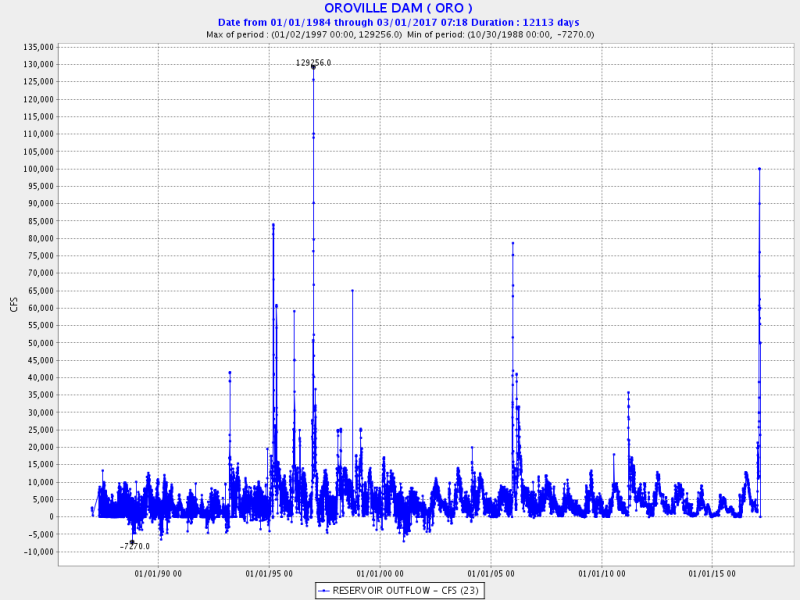

The same site referenced above has historical data for outflows back to 1984, and shows that the last major use of the spillway was indeed in 2011, and before that, 2006

itsmoked:
Those rates from the top left chart you posted look like release rates to me, not inflow rates.
Perhaps I am not looking at the correct chart?
