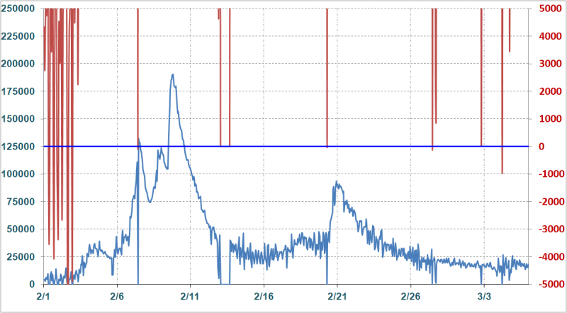

Where is it showing sub-zero flows? The upper left graph is the inflow into the reservoir, and the upper right is the outflow. The inflow is is around 16,000 cfs, while the outflow is around 1,750 cfs. The lower right graph shows a slight increase in total stored water, as expected.

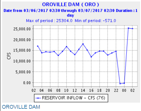

It's not anymore. There was one day about 4 days ago that was about 200cfs BELOW ZERO. The vertical
auto scaling actually went to zero and the data point was below that.
Odd.
Keith Cress
kcress -
My guess is that any sub zero flow information is just noise in the instrumentation.

The "sensor" data is extremely noisy, so it's basically just noise. See below:

I took a look at the inflows and outflows in the link posted in my original post in this string and noticed something odd. The inflow is less than the outflow yet rhe reservoir is rising.
Seems like this is evidence that their hydrologic model is off.
I don't understand how they even have a semi-real-time inflow figure for this reservoir. It has at least four major inflow arms and countless minor streams, all of which are flowing significantly after the frog chokers they have experienced all winter. There can't be stream gauges on all of them, so they are either leaving them out (which would account for the unexplained increase) or guessing at them, and possibly getting them wrong.
It looks like they post the immediate flows but that they are eventually corrected somehow. Really
large ones and negative ones appear then disappear. Probably a human checking and adjusting the
horribly noisy data IR showed us back a few days ago.
John; On a billion dollar reservoir I can easily see multiple flow meters on even the tiniest contributor.
They also have the absolute final word via the reservoir depth and the fact that they probably have very
accurate outflow sensors. That probably allows them to correct any inflow flyers confidently.
