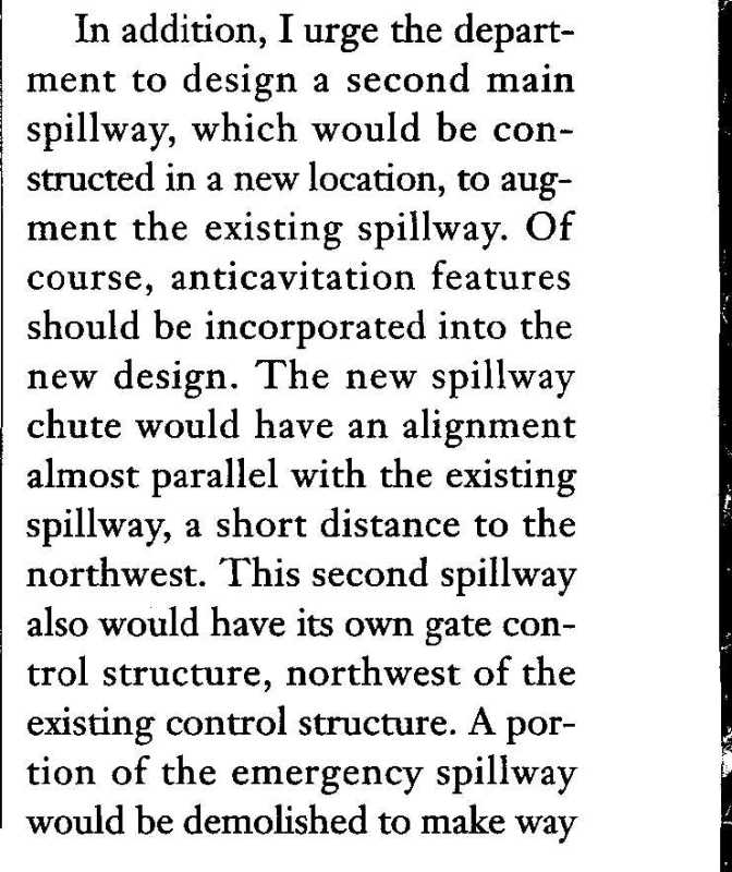

There is a Viewpoint article in the latest Engineering News Record that is very misleading and, in my opinion should not have been printed. Take a look at it and the headlines. How to Fix Oroville Dam. makes it look simple when it really isn't. The reference is not a complete copy of the article. See the actual magazine to read it all.
"As an experienced civil engineer, I would like to make one point very clear: Oroville Dam was never in danger of failing."

My reason for posting the discussion section from the ENR WEB site was the fellow's off hand cure for the problem, which was printed in the final section of the magazine's article that didn't get carried to the discussion WEB pages. I felt the apparent endorsement of an idea by a national engineering magazine was a mistake. A simplified "cure" or "fix" (calling for a second service spillway at a predetermined location) dismisses all the side issues, all of which played a role in the failure and should be handled with any fix.

Here is the section of the ENR Opinion page that I object to. Makes it look too easy.
Thanks Keith for pointing out what I thought was somewhat obvious.
If that spillway wall did fail, does anyone here actually believe the earth below wouldn't be eroded as that much water washed uncontrolled over that area? There is no possible way anyone can say that if the wall had failed that "only" water the height of the wall would be released.
And even if the earth miraculously wasn't eroded, does anyone here actually believe that only 30' water quickly leaving the reservoir wouldn't be considered a catastrophic failure of the dam? A dam is basically a structure built to hold back water, so I consider the overflows as part of the dam.
oldestguy - yes, he made it out to be simple to fix, when it's not. I really didn't find it a big surprise after his rather dubious claim right off the top.
