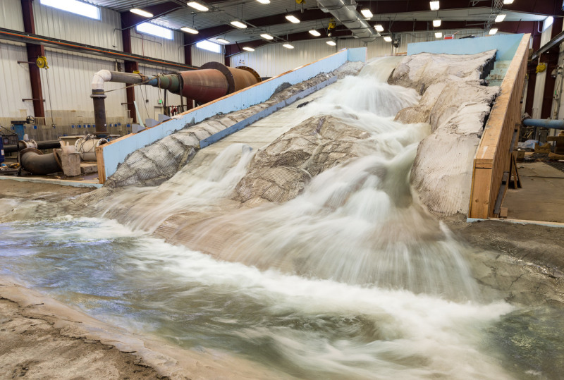

Member Spartan: Stage storage flow data here for those interested:
Mike McCann, PE, SE (WA)
[URL unfurl="true"]http://www.atlasobscura.com/articles/oroville-california-dam-spillway-model-repair[/url]

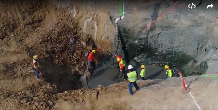

Some of the work being done - nice drone video of roller compacted concrete, filling in the nooks and crannies with concrete and reinforced concrete spillway side walls with rebar and WF beams as reinforcement.
