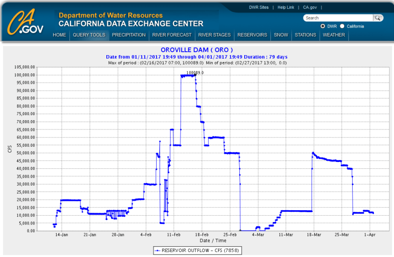

It appears the two sensor 23's are indeed the same sensor...one item is reporting hourly outflow, the other daily. Looking at the data, there is a comments field near the top which states in part:
"Outflow from Oroville includes all releases from the Oroville Dam (i.e.: Hyatt, spillway, low flow outlet)..."
So, sensor 23 does not deal exclusively with the spillway. Sensor 85, based on the comments section, appears to pertain to the Dam Diversion gates and Thermalito Afterbay River Outlet rather than the spill way.
To confirm the spillway is in use, I would expect we'd need to see a "sudden" rise in the overall Outflow measured. Stepping back in the historical data to 2017, it appears the outflow was measured upwards of 20,000 CFS when the spillway was in use.
Running full-tilt-boogie during the failure, total flows were around 100,000 CFS. I think that the max flow without the gates being open is around 9,000 CFS.

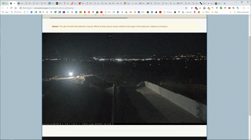

I thought those cameras weren't working either, but if you wait a minute or so, after hitting the 'play' button, they eventually come-up.
