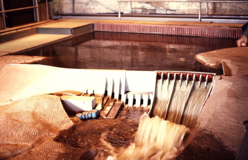

And also keep in mind that until 2017 when the level of the reservoir topped 901 feet, at NO time since the dam had been constructed in 1967 had any water ever gone over the emergency spillway, and while there were obvious problems with the emergency spillway, as noted previously, it again was never an issue for 50 years. But like a lot in engineering, until a failure occurs, there is very little that could have been done to anticipate the consequences. After all, back in 1967, when it came to structures like dams and spillways, the most common tool used for analysis was based on creating physical hydrology models which could only show just so much detail as to what might happen under different conditions.
To that point, back while I was in engineering school, a group from our Army ROTC class visited the Corp of Engineers facility in St. Paul, Minnesota where they had created hydrology models for the most all of the northern Mississippi River including several larger models of specific flood-control projects that were currently being proposed and planned. Here's a photo that I took showing one of those models of a proposed project:

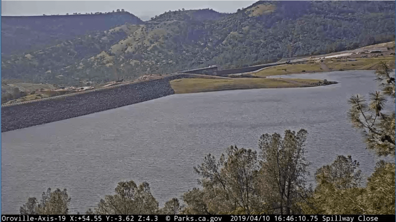

Apparently the level of the Oroville reservoir is back down to where they no longer need to use the spillway:
For the live link, go to:
And here's a shot showing the backside of the dam where we can clearly see the water level:

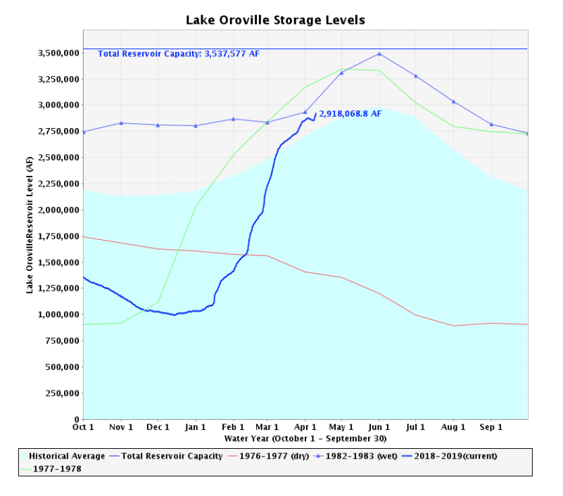

It's actually not 'going down' (it's actually gone up) but you are right that they aren't using the flood control spillway anymore to control the level, just the power plant.
There is a flood control plan they use to figure out when to open the spillway.
You can see the current level as well as historically how they have managed the level in the graph below. You can see the divot when they had it open last week.

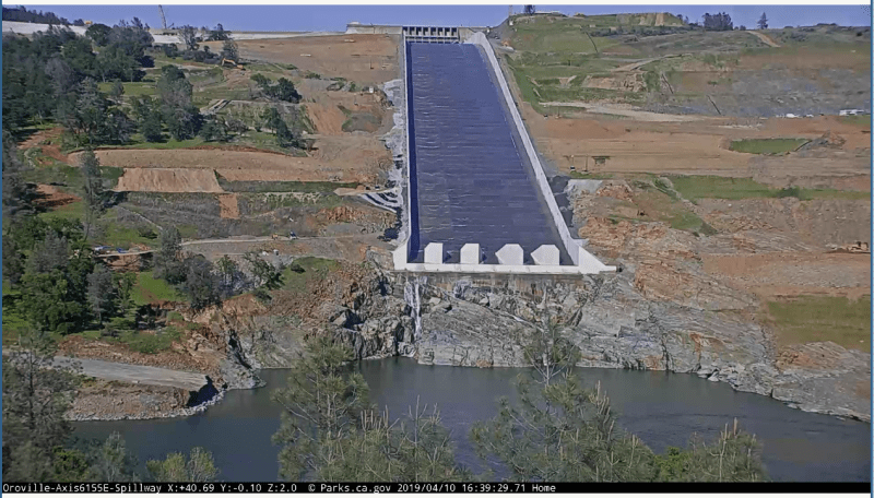

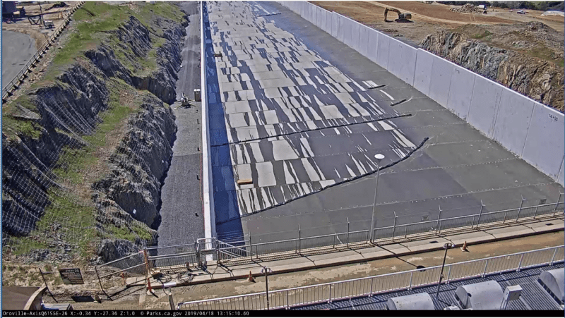

It appears that they've diverted the minimal runoff from the spillway so as to allow what appears to be some addition work or at least some inspections of the spillway surface. I've been watching this for a couple of days now and there have been times when you could see several workers walking around on the face of the spillway, and doing stuff near some of the seams, particularly near where the spillway starts to take a more severe drop down toward the Feather River.

Juan Browne just posted a brief update where he talks about the spillway inspection and how this activity has been reported by the so-called trolls as proof that the money was wasted on the repair and that there are further problems with the dam.
