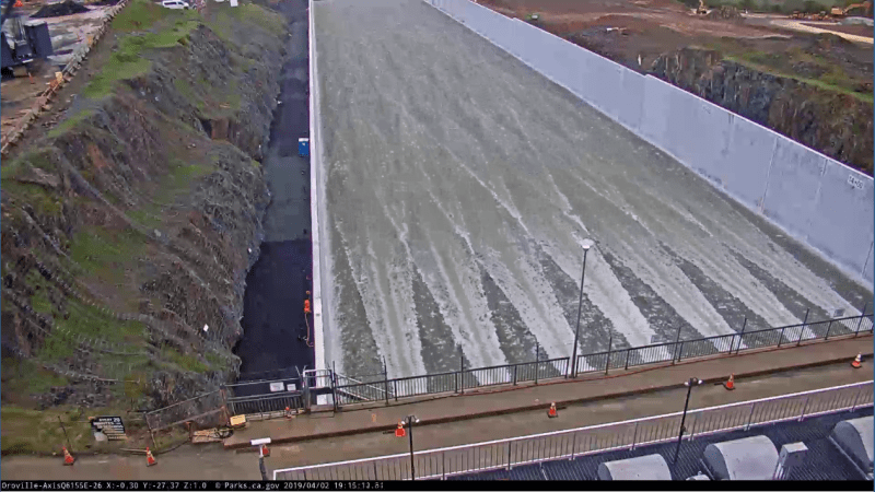

Anyone have link to a bottom view camera handy? I've got the top view one working.
It's here, but getting hammered and times out a lot:
Here's a screen cap:

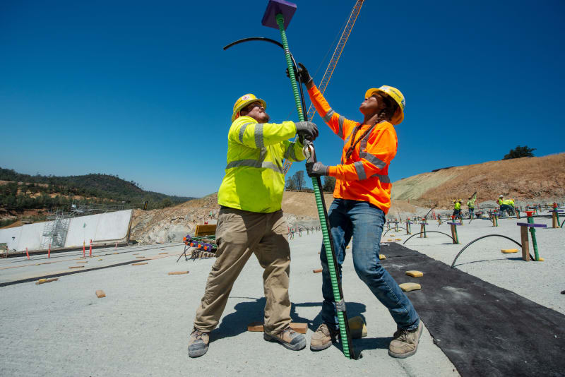

Their fix is equivalent to a new coat of paint on a rotting sinking house. I doubt they fixed the damn shifting a few inches forward. It needed extra pylons sunk into the Bedrock when it was first made, and it still needs them. also the water seems to be getting caught on the cracks in the cement... Again. when there's a big flow the cement will once again tear away.
You mean like the ones they installed and pictured below? How many more do you figure are needed, and why?
"Their fix is equivalent to a new coat of paint on a rotting sinking house. I doubt they fixed the damn shifting a few inches forward. "
And this is insufficient? Based on what analysis?
[URL unfurl="true" said:
https://www.sfchronicle.com/news/article/Newly-rebuilt-Oroville-Dam-spillway-is-back-And-13728330.php[/URL]]The half-mile-long main spillway, where the initial fracture occurred, is now as wide as a 15-lane freeway and averages 7½ feet thick compared with 2½ feet in the original 1960s version. It is capable of handling up to 270,000 cubic feet of water per second, way more than dam operators ever expect to release and nearly twice the capacity of the old chute, which could handle only 160,000 cubic feet per second.
The new 3,000-foot-long spillway has steel pillars anchoring the structure 15 to 25 feet deep into bedrock and a modernized drainage system. The old spillway had only 5-foot-deep piles holding it in place.

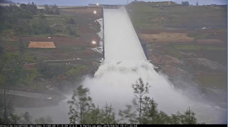

This screen capture is a bit clearer. Those diffusion blocks really spreads the water out.

Here's a shot from the top of the spillway:
