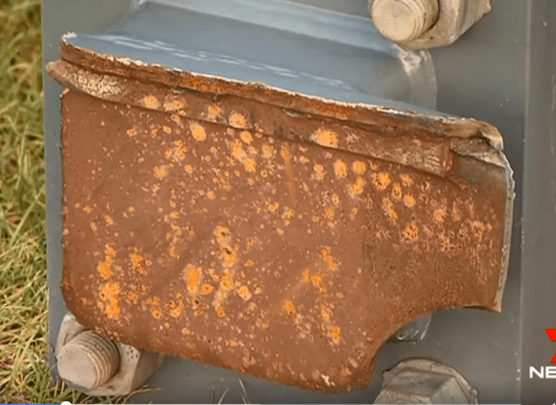

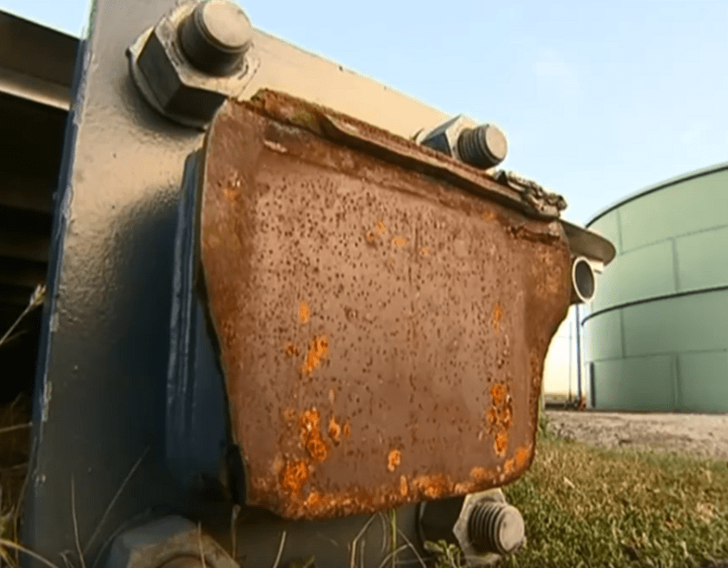

I was driving along the westgate freeway section of the M1 yesterday (not all that far away from where the sign fell) and noticed that two signs on a gantry had been removed and some white 'paint' applied at the top of the gantry that looked a lot like some NDE of welds had been occurring. The framework for the sign was all there, it was just the actual sign (large sheet) that had been removed.
I've seen similar gantries back in late 2017 painted the same colour at an industrial painter in Melbourne and I'm fairly sure the wall thickness was 8 to 10mm, though I can't be 100% sure I'm remembering the thickness correctly.
Here is a Link to what appears to be some of the research, including the FE methodology recommendations, that appears to have influenced the 2015 version of the AASHTO highway structural supports code.
I don't have the 2015 code only the 2009 code so I can't see what clause 5.6.2 states regarding SHS/RHS - if anyone could elaborate further that would be much appreciated.

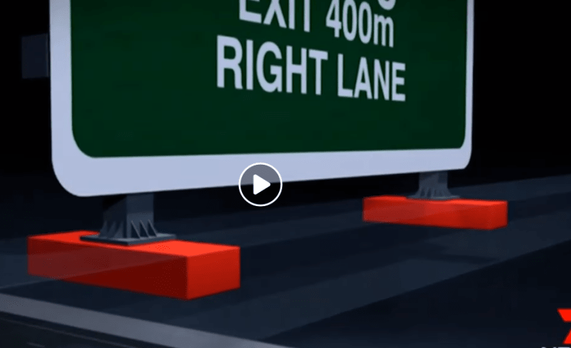

If that artists rendition of the stiffeners is anything to go by they may have been SHS/RHS running from front to back off the sign. I feel that would be less than optimal but probably would have been satisfactory. On second thoughts it's probably just a guess rather than any technical insight as the base off the sign isn't accurate at all.
Looks to me like the stub was located on the front of the gantry fright over the weld to the built up section, you can see what looks like the return of the front wall in the 1st photo, and what looks like a backing plate at the junction.
I thought and could be wrong, but for fatigue shouldn't any backing plates be removed?? Wonder what AS/NZS1554.5 notes?
2nd photo doesn't seem to show any fusion into the backing plate, I feel this is a key point if it was supposed to have full penetration as suggested by the presence of a backing plate, with the root of the weld to the gantry potentially acting as a crack initiator?
Partial penetration butt weld wouldn't require a backing plate.
You can see what looks like some of the tack weld where backing plate was attached to the wall during fabrication in the 2nd photo, and the 'shadow' of where it was placed in the junction. Its probably still attached to the gantry!
How would you remove backing plates from inside the closed section?
Don't ask me!... like I said I'm not sure now having looked through AS/NZS1554.5. It just states for permanent backing left in place, that it needs to have a similar weldability.
Definitely if you look at the top backing plate there is weld fusion on the backing plate, but the bottom one really doesn't look like there was any, but could just be my eyes playing tricks on me.
Shame these pictures weren't taken directly after so you could see what might have potentially been older rusted cracks vs fresh fractures?
