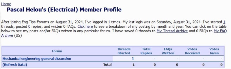

I fear the OP was texting from beneath the closed pool cover.
There is something to be said for a waiting period between joining and posting -
