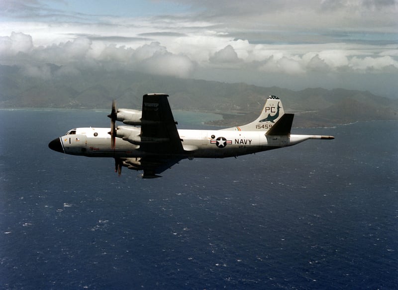

My Navy pilot friend (he was actually a co-worker) didn't fly carrier-based planes. He flew Orion P-3's, anti-submarine patrol aircraft, during his service as a Navy reserve pilot.
