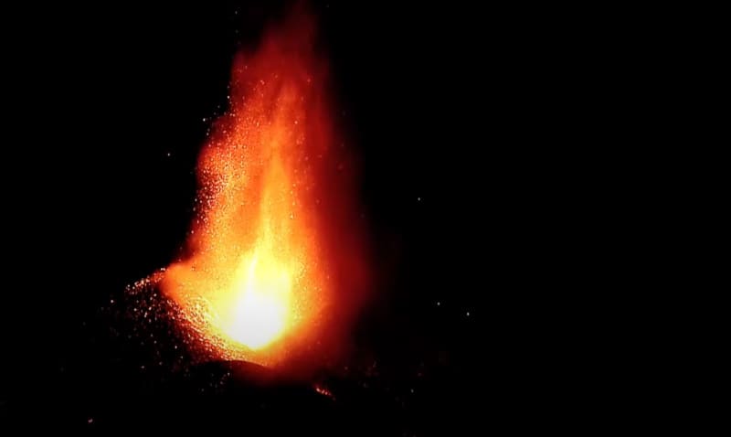

Scattered light of of the particulates likely is a large part of the difficulty of seeing the lava fountain. The daytime scattered sunlight is brighter than the black body radiation of the lava fountain, which is also scattered. This screen shot shows some of the scattering. - The illuminated smoke on the right side of the image that is mote likely to result in colored smoke than further obscuring the fountain.

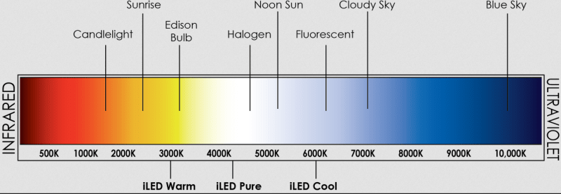

There are published estimates of the temperature of the Lava at the cliff side as being 1000 C. Has anyone seen a real number for lava temperature at the vent?? I do not trust comparing the black body color chart, as the camera is probably saturating in the bright (hottest) spots.
[URL unfurl="true" said:
https://blog.inspiredled.com/wp-content/uploads/2017/09/Kelvin-Temp-Chart.png[/URL]]
Black body temperature is reasonably OK if you could see the thing live and/or use an optical pyrometer. The published melting temperatures of basalt magmas are around 1000 C - 1300 C and from my own experience with kilns this looks about right for the colours in the images.

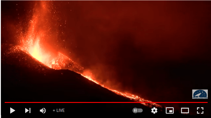

This video shows the interaction of the eruption plume with the Sahara Air Layer temperature inversion capping the top. It makes the plume flow horizontally at 5300m msl. The volcanoes pulsations at different intensities causes these waves.
/Este video @cielodecanarias muestra la interacción del penacho eruptivo del #VolcanLaPalma con la inversión de Tª del tope de la "Saharan Air Layer" que le obliga a un desplazamiento horizontal a 5300m snm. El volcán emite pulsos de diferente intensidad lo que provoca esas ondas!/

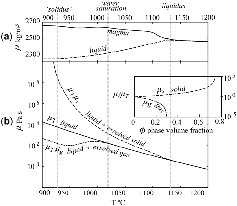

Some theories I've been reading lately propose both slug and annular flow, depending on type of volcano, determined by all of the following interdependent parameters, gas and water content (3 to 6% typical range) flow rate, temperature, 750-1250°C pressure, viscosity, 10k to 100k x water,and chemical composition of the lava.
"Low viscosity magmas, such as some basalts, can form very long lava flows very rapidly. In contrast, rhyolite magmas are viscous enough to limit bubble movement. Rather than escaping by buoyantly rising through the magma, gas bubbles are trapped in rhyolite magmas, expand, and eventually create very explosive eruptions."
