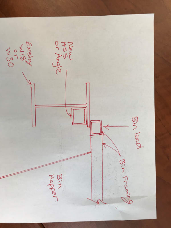

I have an existing W section that is loaded eccentrically, about 5" off the web centreline. There is no way to brace the flanges and take out the torsion and no easy way to remove the beam and replace with a HSS. We were thinking of installing a HSS section in the top right corner of the beam and welding it to the top flange and web of the beam to take the torsion. Anyone ever done this? If the W section can take the bending and shear, can one just design the HSS to take the torsion and provide a suitable connection at the column? Would there be issues with the section no longer being symmetric? Never really have done any torsional reinforcements before and typically stay away for torsional situations. Any comments would be appreciated.
See sketch below.
The bin manufacturer doesn't want any additional load into his bin framing.
The reason I dont want to use plates is the size of the W sections. 18 and 30" deep plates are a significant cost and would be difficult to install. The HSS or Angle is simpler.
I like the HSS stitched to the wide flange. With the angle or plate solutions I see it as needing continuous welding to maintain the closed section which is gonna suck if this in place and you're grinding paint and welding in tight areas overhead.
Thanks. I'd imagined something similar but figured it would be easier to install the new stuff on the opposite side of the web. I don't feel that the plate solution would be cost prohibitive but you obviously know the preferences of your construction team better than I.

Hello Combined bending and torsion of a W beam is dealt with in 'Basic steel Design' by Bruce Johnston and others. These calcs and tables make use of the Cw warping constant (per AISCM)and a torsional bend constant 'a'. Normally this book is intimatly tied to the AISC manual, but in this case thier tables are not listed with a AISC ref. It does have examples with 24Ft long beams, but does warn against the increased deflections or angles of twist. The tables give the angles of twist. I have only used it once or twice.
Note that this is a very good book for simply explaining the AISC endless list of inter-twined specs. With flow charts that simplyfy the use of the AISC.
I'll repeat my earlier caution with regard to fitting an HSS section into the corner of a W-beam. Fillet radii for W-beams can be up to 3/4", while the HSS outside radii is typically twice the wall thickness. If you're using a fairly heavy HSS section, it may work, but you'd end up with a fairly large gap to weld for a lighter HSS.
The ratio of torsional stability to weight of a box created using an angle should be considerably better than for the HSS.
If the ends of the HSS or angle are supported, that will move the shear center, so it would be advantageous to add the angle or HSS to the side closer to the load in that case. I could be mistaken, but don't believe it matters for torsional stiffness which corner is used to put or create the box section. You could do something similar to what is shown in KootK's left sketch, but put it in the bottom corner, extending past the bottom flange to avoid alignment problems.

HotRod10- I envisioned I would have to use maybe a 1/2" thick HSS to make the radius work. Still in the early stages of this idea.
I thought using an HSS would be simpler, and would not be sharing stresses in the top flange of the beam (ie, torsion stress and bending stress). I think the beam is near or at capacity as it is. I understand the weight of the HSS would be more than double than just putting in the angle with not much increase in torsional resistance.
I did not however understand your comment "if the ends of the HSS are supported, that will move the shear centre? Can you elaborate?
If I'm not mistaken about the internal mechanics (although I could be mistaken), if only the W-beam is supported at the ends of the beam, then the eccentricity to the load remains from the centerline of the web. Whereas, if the HSS or angle is attached to the support, the shear center would move to, or at least closer to, the centroid of the composite section.

I can't see the small weight savings of the angle factoring in here. If the fillet is a concern, I would add a spacer to the HSS to clear the fillet (welded in the shop of course). I can buy the space truss analogy for torsional stiffness, but it seems awfully complicated to check. Might be justifiable with low loads but supporting a bin I want something with a nice clean load path.
Ignore the spacer completely even - just move the HSS away from the web. I don't see why it needs to tuck in so neatly, provide you add some properly detailed stiffeners at the location of the load to transfer torsion to the HSS.
