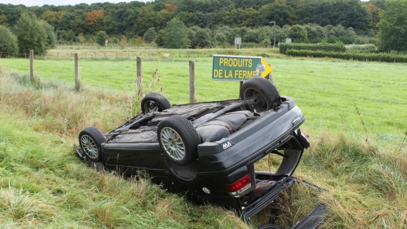

On this particular case, I will be pleased if you could tell me more about the instantaneous forces on the wheels :

I will have a guess and say at some point prior to the photo, a large roll moment was generated.
je suis charlie
The rear suspension is the notorious twist axle with the cross beam centroid and shear center facing downward and foreward a bit. That means it has -10% --> -12% rear roll steer (as in roll oversteer). It takes a mighty stiff tire to compensate for this at speed below 140kph. With those stiff tires, the roll and yawrate frequencies hooked up and the driver ran out of courage.
The camber of the front and rear wheels is permanently deformed due to the wheels sinking into the ground and the vehicle was tripped while going sideways. Look at the tracks. Loss of control due to the very high gain of the car, low understeer [less than 1.25 deg/g] and rain tread for wet traction. Axle loads > 5g (typical design max).
Then driver screwup! Just push it over and drive it away. Might want to clean the seats first...
