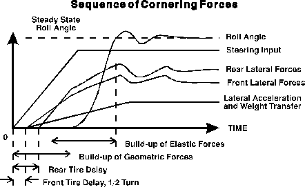

Brian,
I assume you mention this kind of graph
So if I well understand built up of geometric force (partially depend to Rc-CG) come fisrt with no movement of the suspension (no roll), then built up of elastic force (mainly dependent of spring, etc) with movement of roll.
As soon as no movement of the suspension is happens relative to geometric force, the movement of RC during roll (elastic force) is no relevant.
Do I well undertsand?

BlueFoxy. Minor point. In your diagram. Rear tyre delay period should begin when front lateral forces begin.
