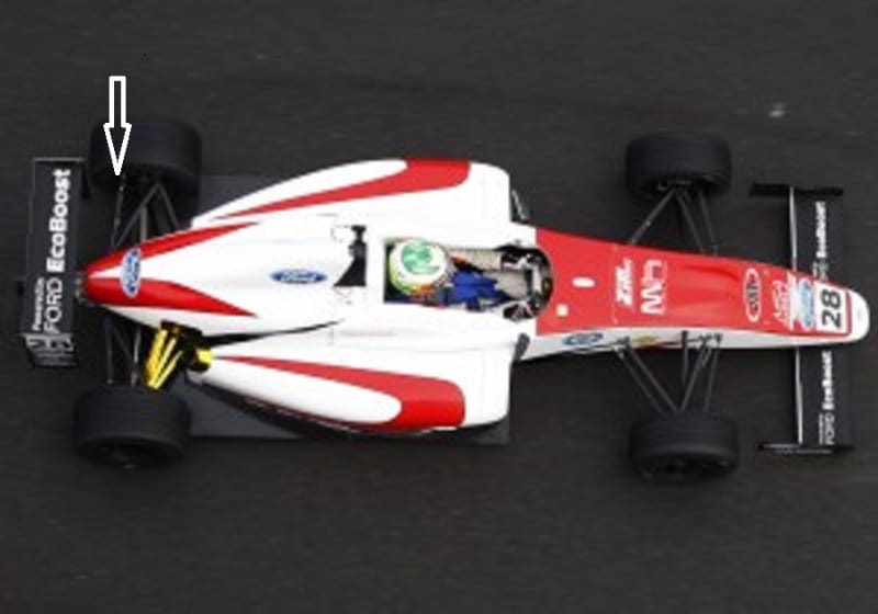

The doubt I have is due to the fact that the rear susp (it is the usual double whishbone with pushrod) has the toe link welded on the top whishbone.
Assumed what we already said about bumpsteer, car seems to react to rear caster adjustment; more caster (positive as in front, nose up) gives more OS and the other way around.
As you say maybe this forces are deforming this whishbone so as there is some bumpsteer that cannot be seen measuring on a bench.
My kinematic analysis gives no bumpsteer......

You will need to use software which can analyze member with elastic elements (as in wheel bearings, wheel, wishbone attachment stiffness. Then it will all make sense, If something is flexing, something could break from fatigue at any tome. Usually a 'toe' link mechanism is on swivels or ball joints when it is used as a ride/roll steer setting device. Shouldn't it be linking the upright to the chassis at a point off the control arm/wishbone plane ?

On this kind of suspension, where toe link is weld on the upper wishbone.
From my experience , we put a little bit caster at the rear, may be 1-2°, to get a bit of toe in in bump (+0.2mm for 1 inch bump).
With this small angle, the resultant vertical effort on the upper wishbone is small, so twist (from side wiew) of the upper wishbone might be small.
But if you end with 10° caster to achieve no bumpsteer, then you will get a vertical resultant effort wich could be important and twist more the upper wishbone under load, end up with undesirable toe variation under load.

reply to Cibachrome: for this thread and the otherone too: first of all thanks a lot. I deal with racecar since a lot of time but when I was a student I did aerodynamics so, even if I studied by myself, several subjects remained a bit "foggy". In fact, I thought that, as you say introducing a moment would also induce something inside the tyre. About your picture, I fully agree: a spearated toe link is the best way to control (eventually also in an active way) the toe movement. Sometimes, tough, I have to work with cars like the one in Bluefoxy pic, and I have no right to modify them by regulations.
reply to Bluefoxy: yes the layout is exactly like that (picture). Everything seems to match, when the caster is introduced the car oversteers because something get deformed (toe link?), in fact this effect lowers a lot when (I checked the set-ups) the trailing arm goes to smaller values. Thanks a lot to you as well.
