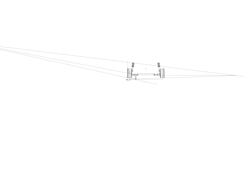

I realize that the MacStrut wasn't the original focus of this topic, but it's perhaps better to consider it anyway simply because a consistent approach to the usefulness of kinematic roll centers is either going to work equally well for the strut or weaknesses/limitations in the approach (small angle approximations more likely to become invalidated) might be more apparent because geometric roll center migrations are more severe with the strut suspension.
Pictures . . . the first is from Fred Puhn's "How To Make Your Car Handle (enthusiast-level book, 1976-ish)
The second is from a spreadsheet construction of my own.
Norm

You are agree with Mitchell, when he wrote: 'Stability results when the FAP-CG moment arm remains constant as the vehicle rolls. The chassis “takes a set” rather than constantly seeking a new equilibrium. This can be expressed by minimizing the lateral movement of the KRC as the vehicle rolls. But this is an artifact: there are more direct ways to calculate this; namely with the change in FAP height resulting from ride. It should be one-to-one. (An easier way to visualize this is from the viewpoint of the chassis rather than the world. The FAP point should be constant as the wheels and tires move up and down.)
Bear in mind that the FAP is most relevant for the side that is more heavily loaded (the outside wheel) because of the way the FBRCH is calculated. And for that ... I bring back your favorite topic ... the MacPherson strut.
The instant center will be somewhere along the line that is perpendicular to the upper strut mount. In most normal applications (certainly both of the vehicles in my driveway), that strut is only a few degrees away from vertical. So the instant-center will be somewhere along a few-degrees-off-horizontal line through the upper strut mount. With practical and sensible geometry (lower arm somewhere near horizontal at nominal ride height and not unreasonably short), that is going to lead to a FAP that is near ground level. The instant center of the unladen side (the inside of the corner) will be doing all sorts of screwy stuff, but it hardly matters because there's hardly any load on that side. So, the FAP-CG moment arm is going to be somewhere near the height of the CG give or take a little bit.
Out back, if I look at the two vehicles in my driveway right now, in one case it has a twist-beam axle, which will have a roll center (whether force-based or kinematic) not much above ground level, and in another case it has a suspension design that you will surely love ... a dead-beam axle on leaf springs! The roll center (whether force-based or kinematic) is at leaf-spring height. So in both cases, that CG to FAP moment arm doesn't change much.

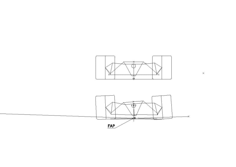

Brian,
So I do not understand why you do not like the concept of twin arm suspension with constant distance RC-COG.
Because as far RC-COG remain constant, both FAP are very near (you even do not have to negligate the inside wheel), it result a FBRC -CG distance constant:
Brian,
Regarding Mac Pherson,
I take the time to DRAW, because DRAW help me to understand what happen.
Regarding the position of FAP, it stay constant until the lower arm get the same angle as the perpendicular to the upper strut mount, if it come more angle it went totally opposit.
Both suspension you mentioned with FBRC-CG constant ha a massive jacking effect.
